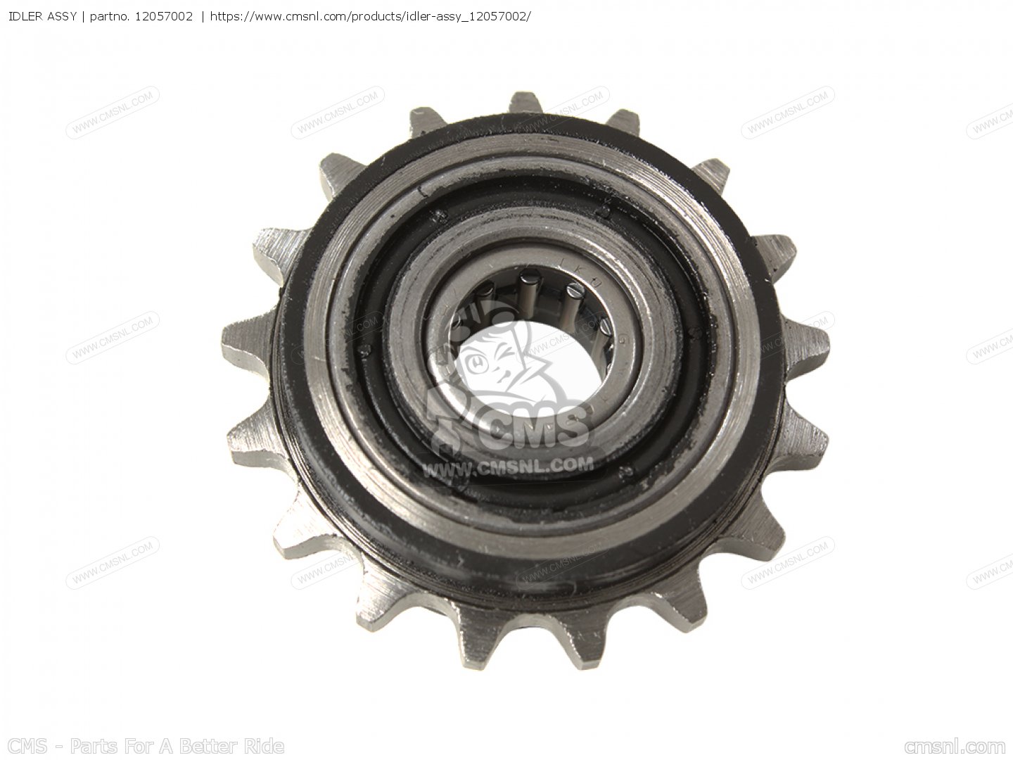

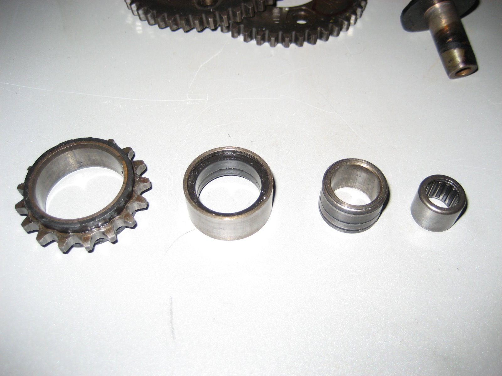

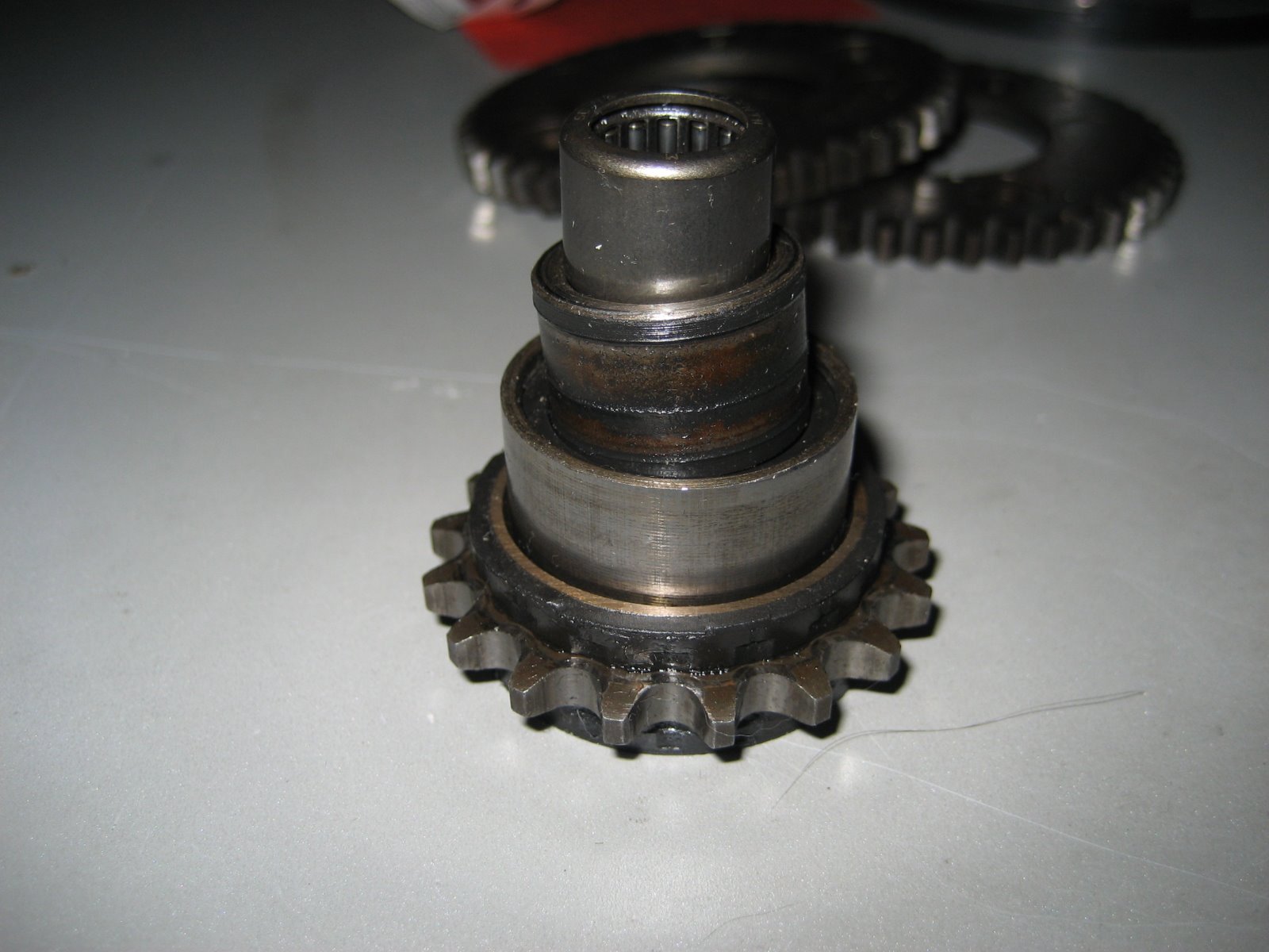

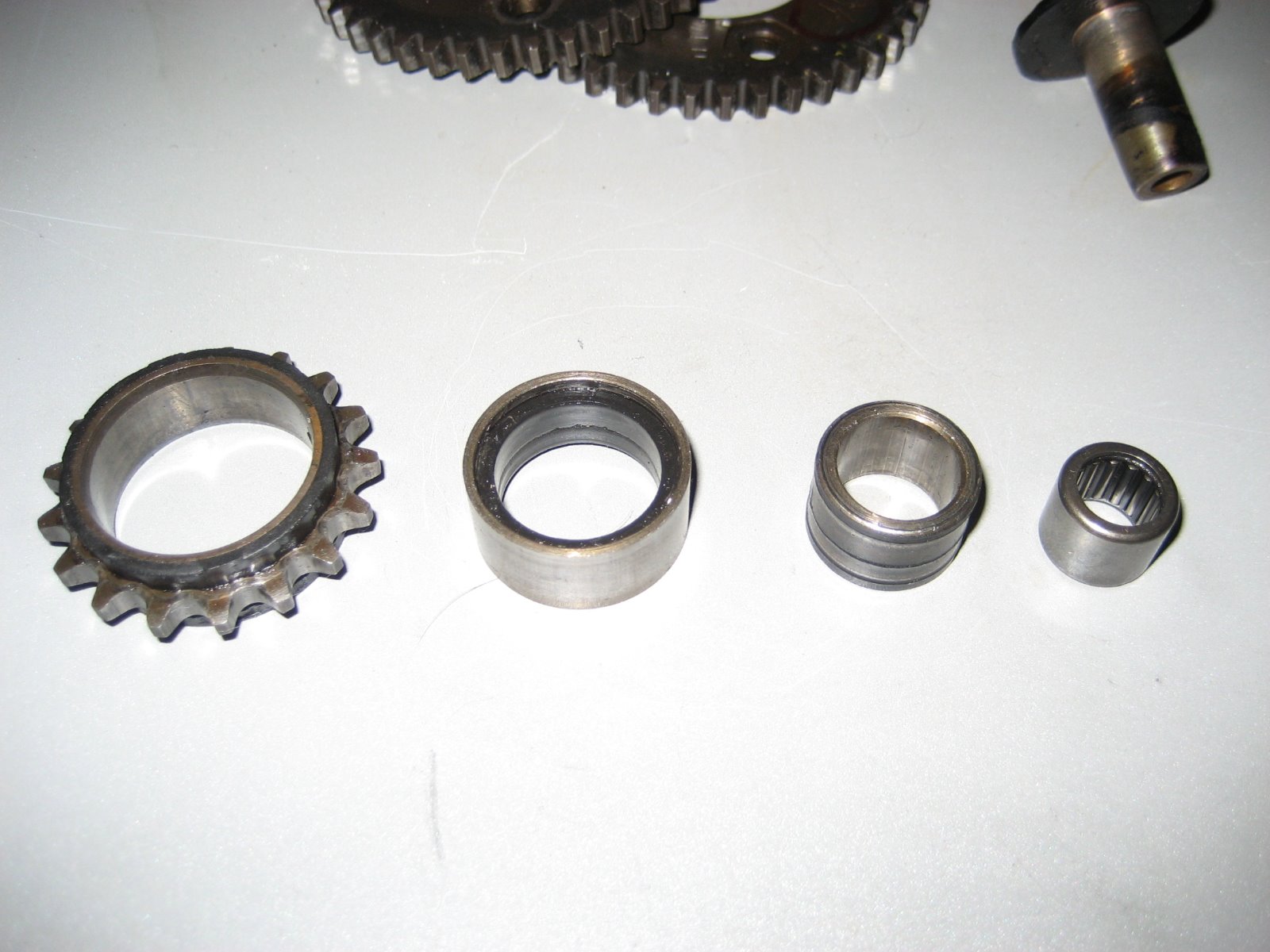

17 Mar 2023 15:21
Carbs need a sync
Controll valve lash
Controll and adjust cam chain tension
Controll cam chain guide and top idler, the old rubber damper parts can disintegrate and fatal failure!
