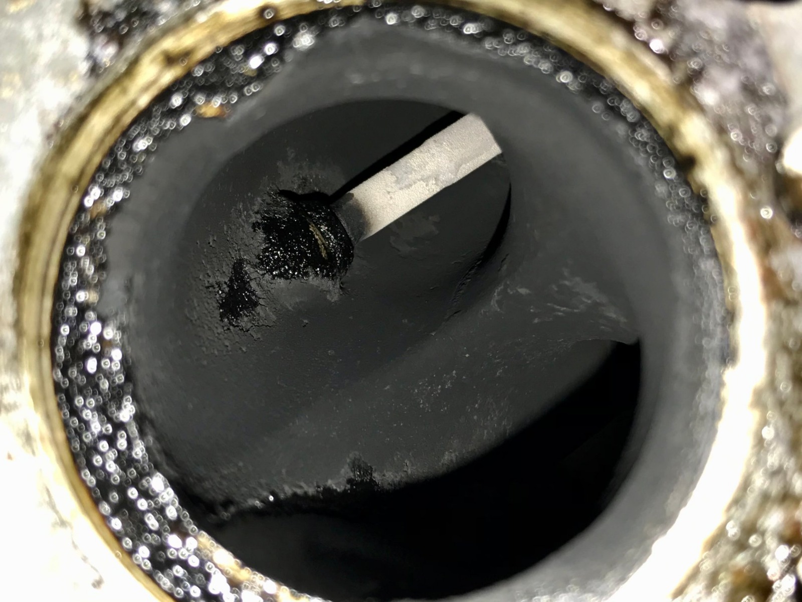

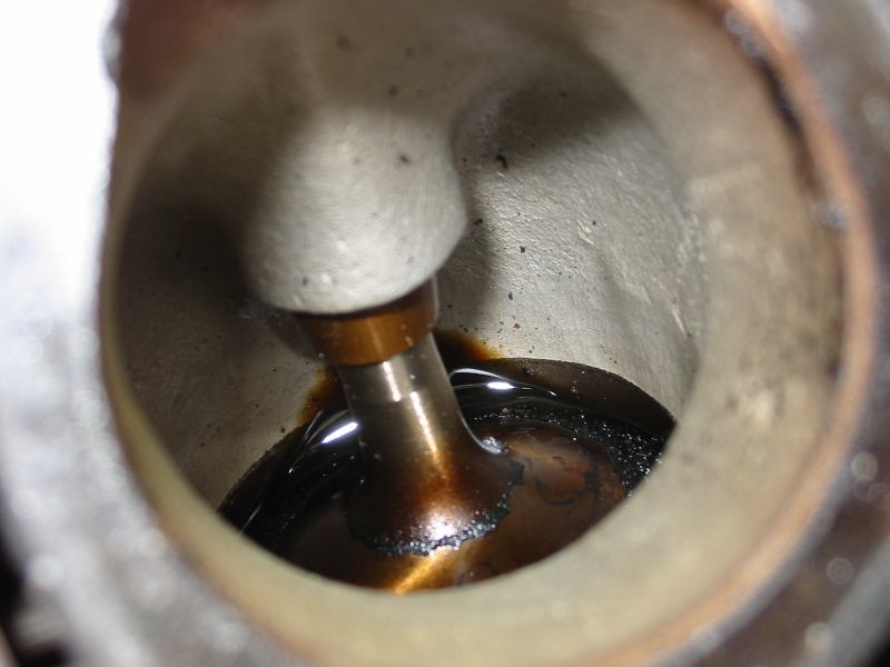

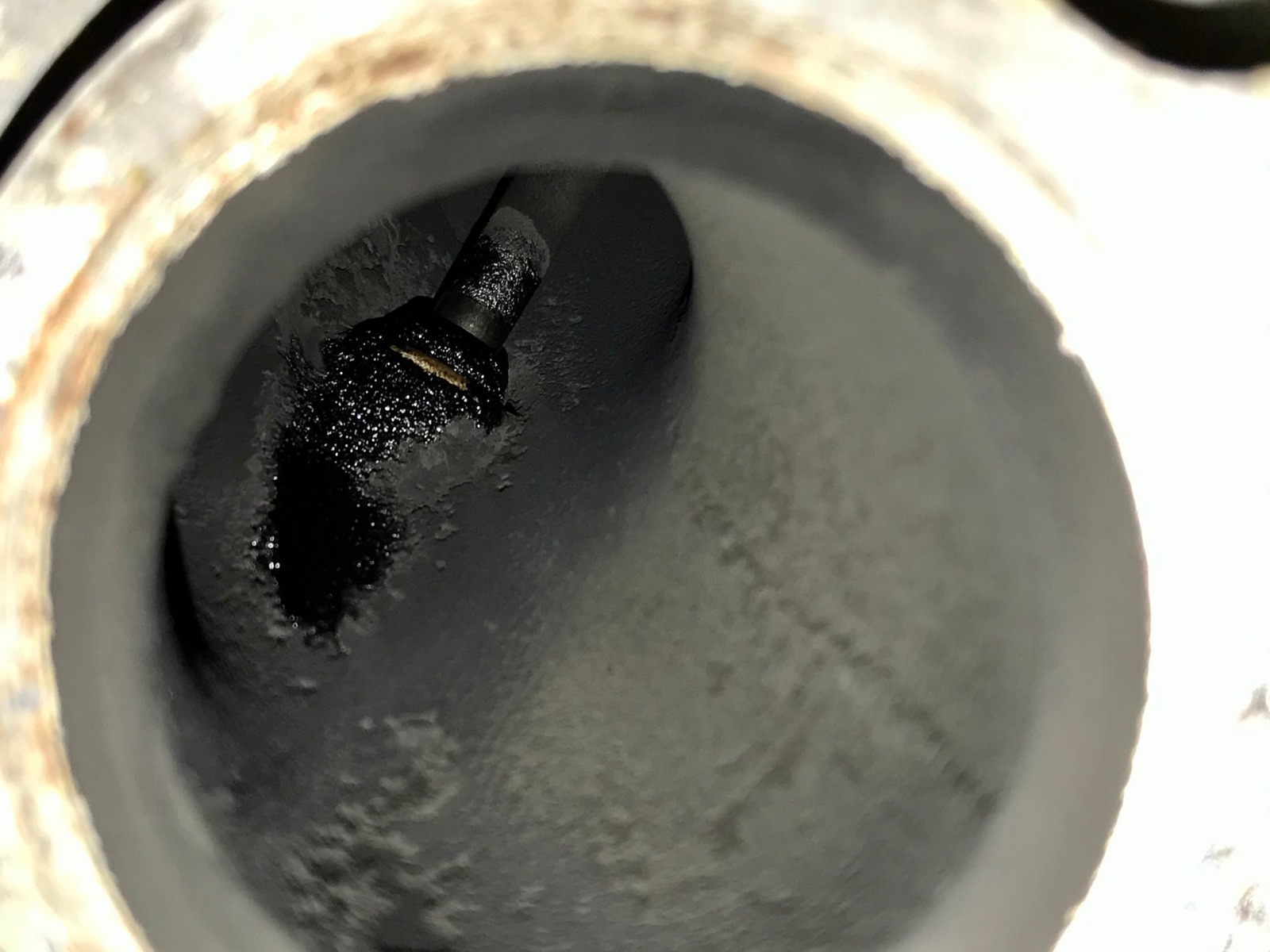

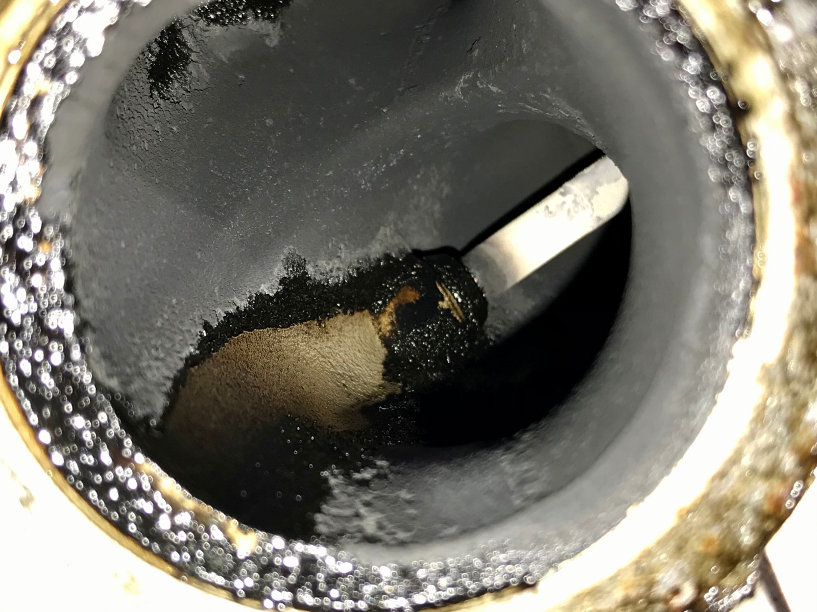

The spark plug surface will tell you the oil fouled cylinder. A bad seal on an exhust or intake valve can cause smoke.
An oil or carbon fouled valve stem or valve plate will tell you the bad valve stem seal.

07 Mar 2023 19:18 - 07 Mar 2023 19:21I'll get an inexpensive spring compresser from ebay and give it a try. I don't rember which valve has the damaged seal.
Would a bad seal on an exhust valve cause smoke the same as on an intake valve?
Yes; a bad seal on either one can allow oil to reach the combustion chamber, where it burns and creates smoke.
EDIT: I now see that Scirocco already answered the question. I was distracted by the excellent pictures.
