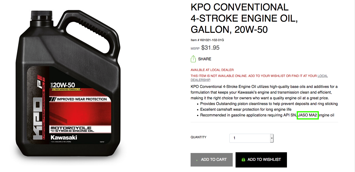

Cheap stuff--kawasaki motorcycle oil 20w-50 non-synthetic.
JASO www.jalos.or.jp/onfile/jaso_e-2.htm
The list from JASO
www.jalos.or.jp/onfile/pdf/4T_EV_LIST.pdf
The list from JASO
