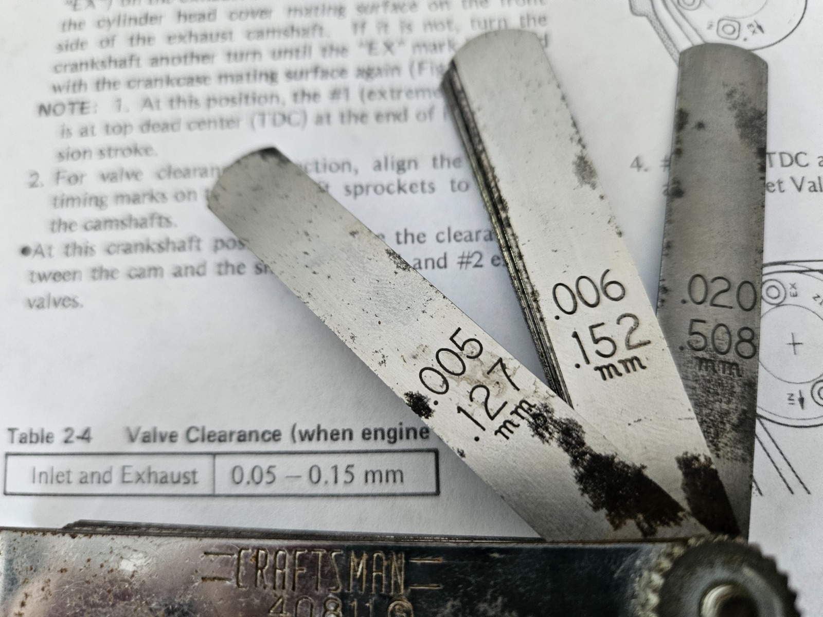

I am working on my '82 KZ1000j that has an issue where the #1 cylinder is not firing (exhaust header not getting hot like the others). I have checked about everything else  so I'm looking at the valves. I have measured the space and all valves are the same. .127mm will go in the .152mm will not. The manual says  they should be between 0.05 and 0.15 mm.
Looks like I'm within specs on the high side. Am I reading everything right?  Is it better to be at .05 or be at .15?

As close to .15mm as possible.
Better to be on the high side .
