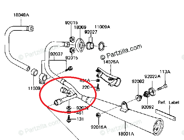

The crossover pipe in the pic is part of the RH muffler assembly, so it isn't a separate part. It probably adds rigidity to the system.
Depending upon how bad it is, you might be able to make a repair by using copper pipe & fittings. and maybe use some RTV &/or exhaust pipe wrap to seal it up.
