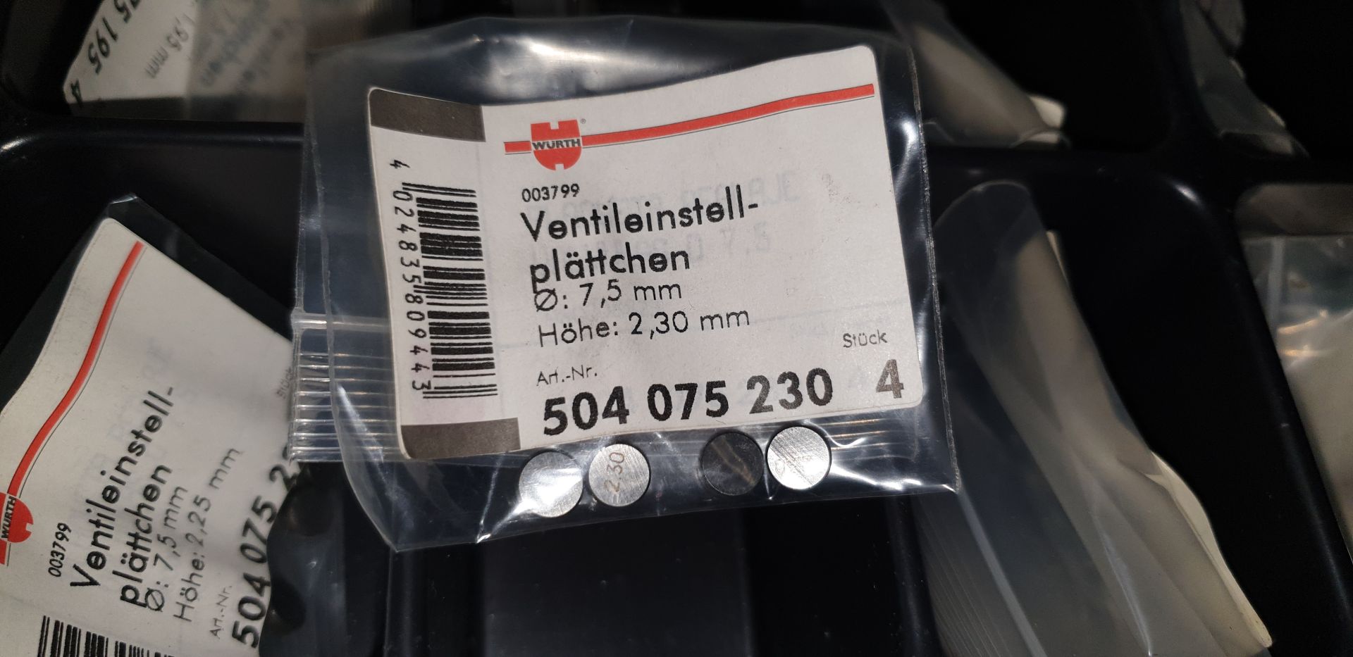

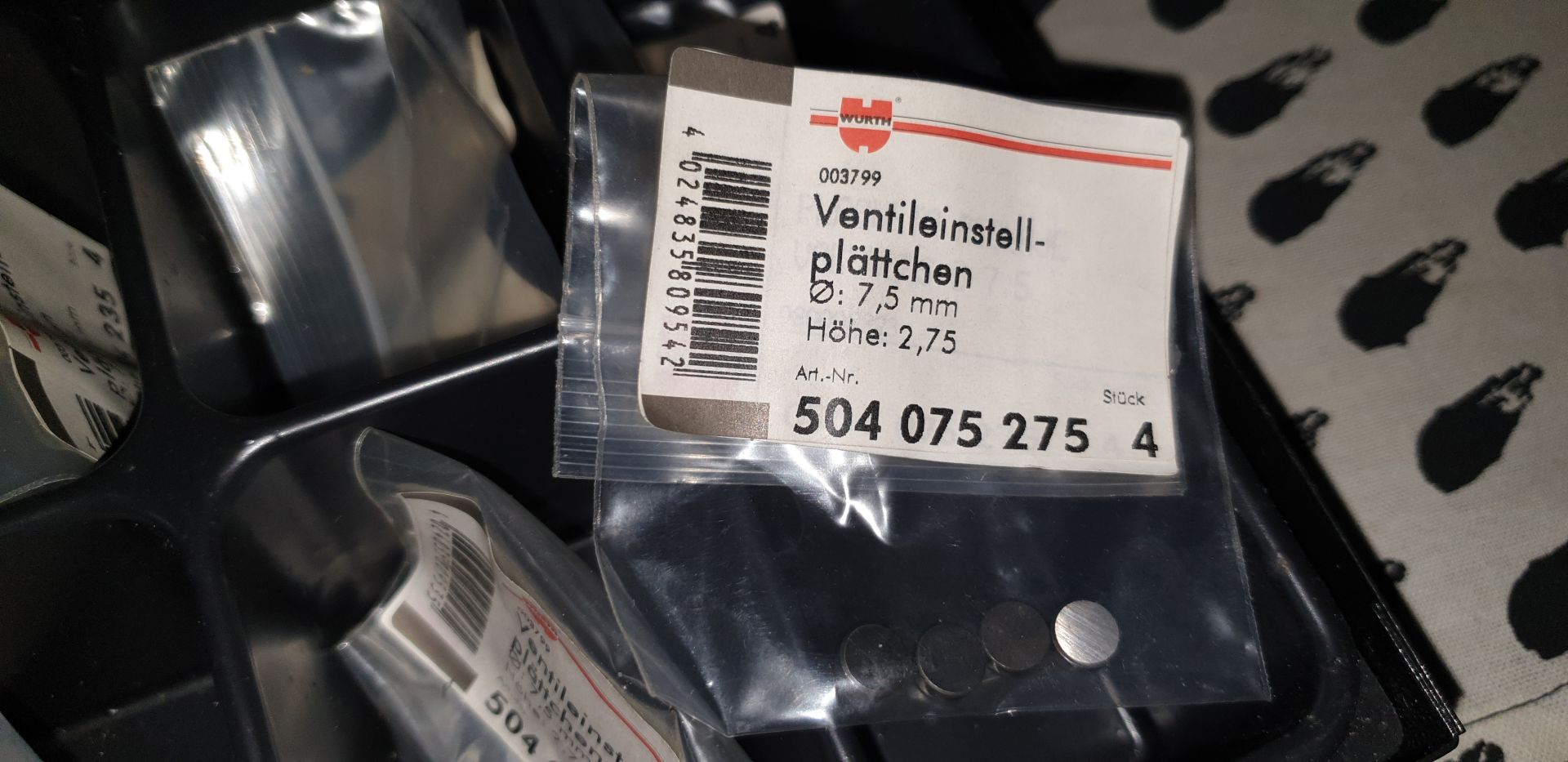

Search on ebay or amazon for a 13mm shim kit.
I bought two shim sets on german ebay privat sales for 100 Euros.
