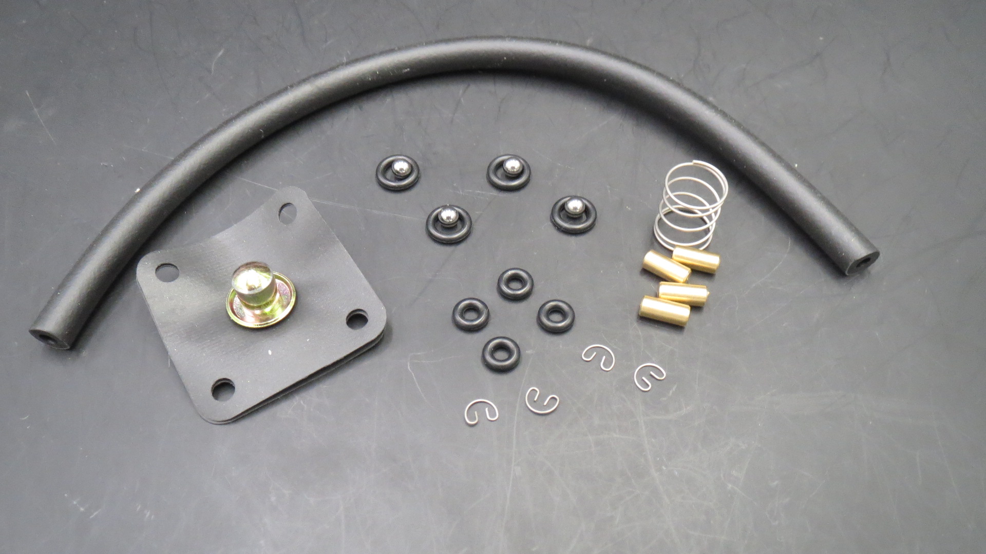

This morning it started almost immediately, but in checking things there is now a nice flow of gas out of the drain on the bottom right of the
accelerator pump on carb number two. Did a search here trying to research the issue and find nothing.
Any suggestions?
Any suggestions?

Try to replace the o-rings on the bowl drain screw.
If it didn´t help, next step is to replace all gasket parts of the accelerator pump system.

This is the overflow tube. You have to set the correct bowl fuel high and check the needle valve parts aren´t damaged, clogged and moving free.
