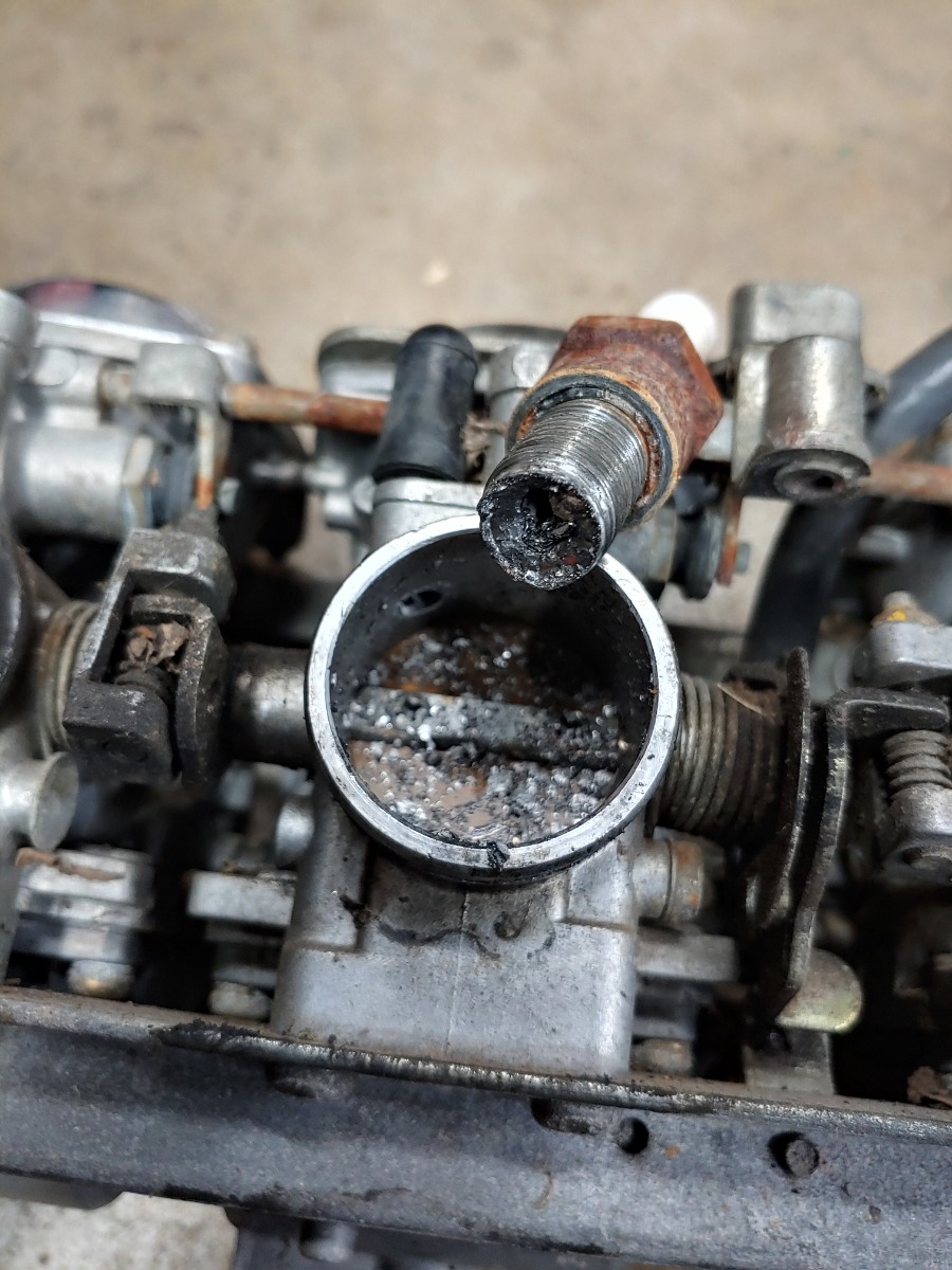

Looking at that plug. Somebody rode that bike a good distance with a dropped valve!!! Very good chance the small end of that cylinder's rod is got some serious damage to it!!!
The head is trashed. Same with the barrel. And I will lay you odds so is the crank....

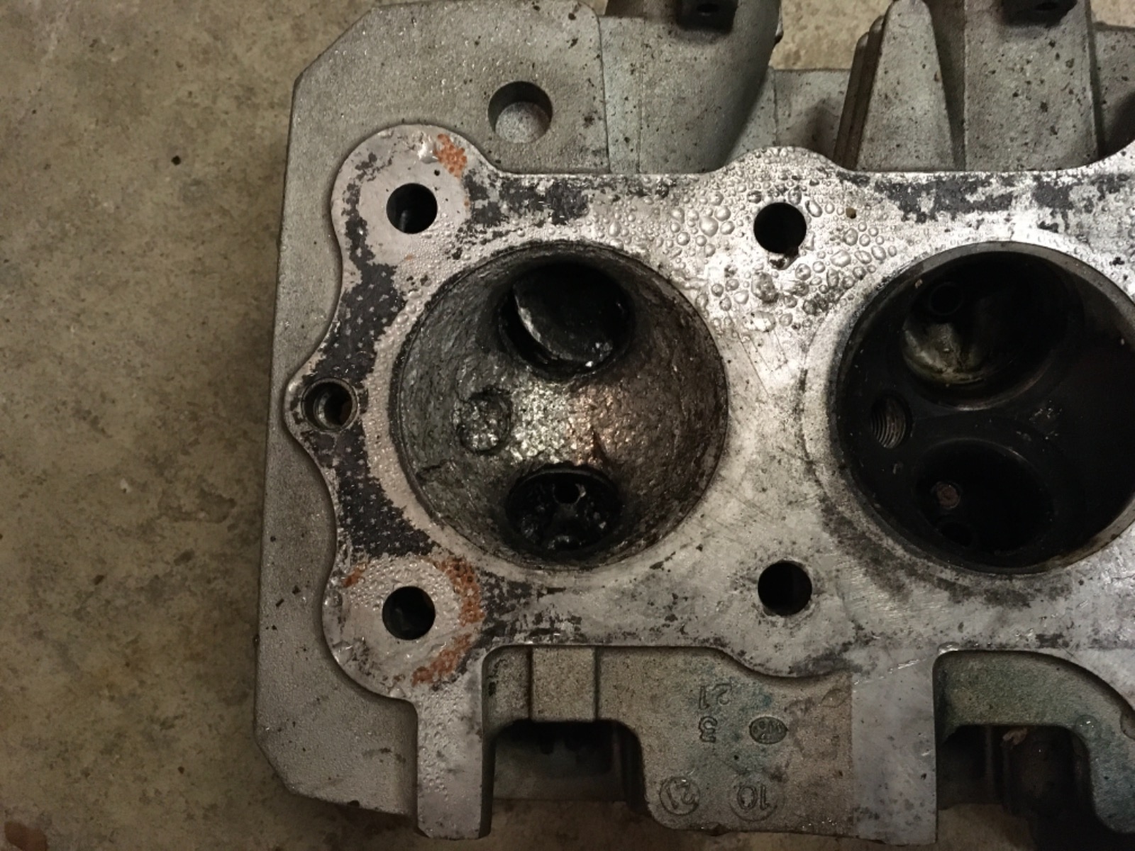

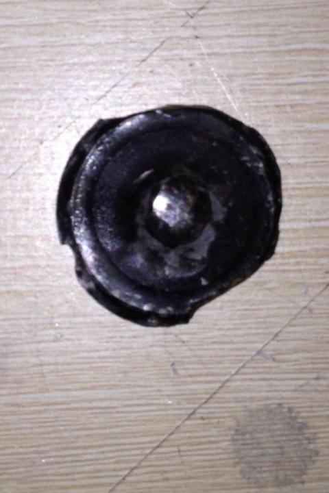

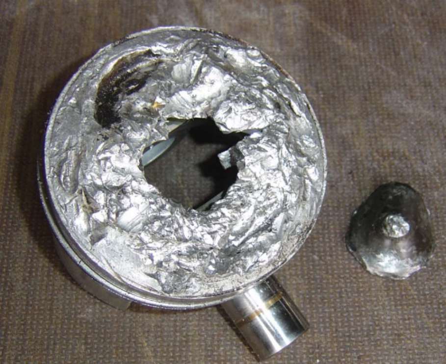

Re: J engine build options
22 Jan 2023 11:11
When you find aluminum shavings in the intake port and inside the throat of the carb, your motor definitely dropped a valve.
I have seen enough of them over the years.
So when you pull the head these photos will give you idea on what you find!!

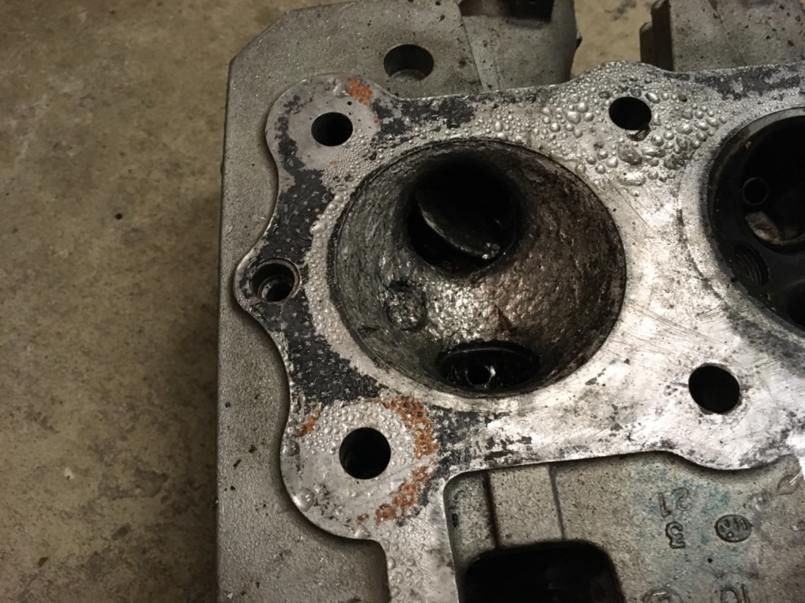

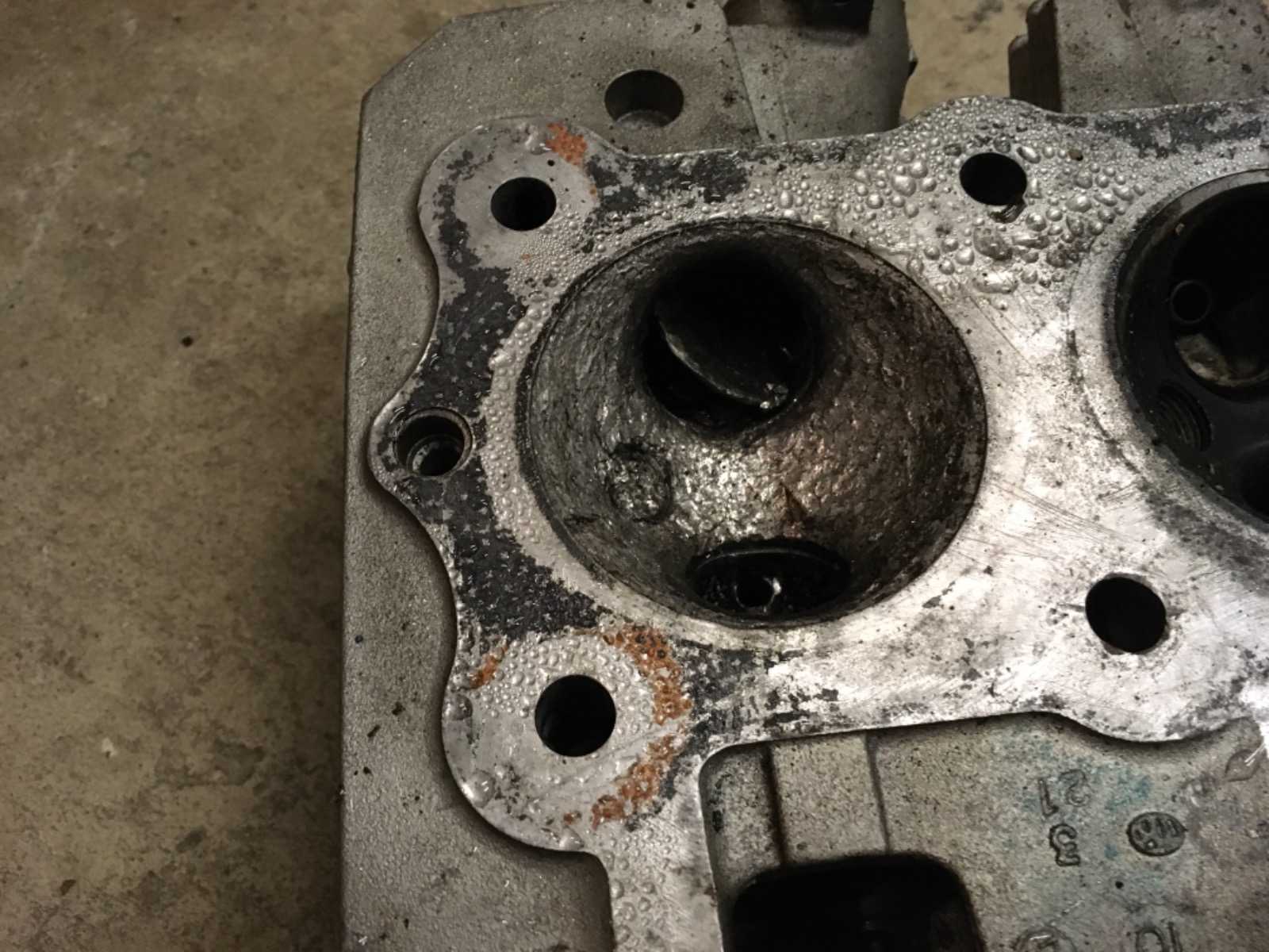

22 Jan 2023 18:08
Here’s another example of a J engine that dropped a valve. Look at the similarities of the spark plug to your.
