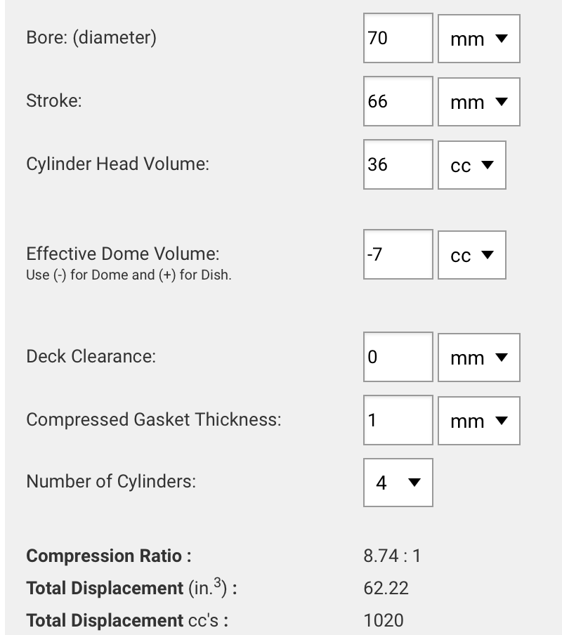

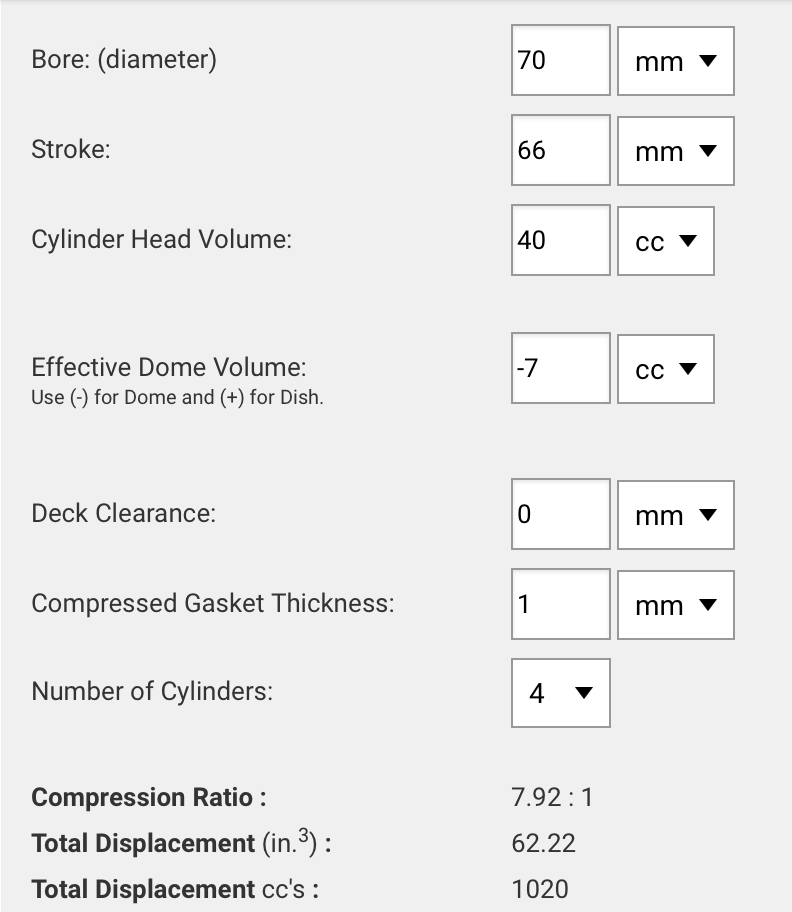

Stock head compression with factory bore & stroke with 36cc chambers along with the same engine with a J head is below in the screenshots.
I'm not sure I'm willing to go from 8.7:1 to 7.9:1 (if the calcs are correct).
I'm guessing that the head/ cylinders could be decked, but would I run into piston valve issues? according to my calculations I'd have to deck either the head or the cylinders by approximately 1mm to get back to 8.7:1.
Total engine displacement is 1015cc and 1mm of 70cm stroke ( single cyl capacity of 253.75cc divided by 66 ) = 3.844cc approx so decking the head 1.3 mm approx ( minus 4cc approx allowing for curvature of the hemi combustion chamber to get back to 36cc ) will restore the compression.
There is plenty of clearance to deck the head over 1mm before you run into the seats.
The valves are also set into the head 1mm deeper ( they have 1mm shorter stems to match ) so piston to valve clearance will be fine.
I have done this many times..
