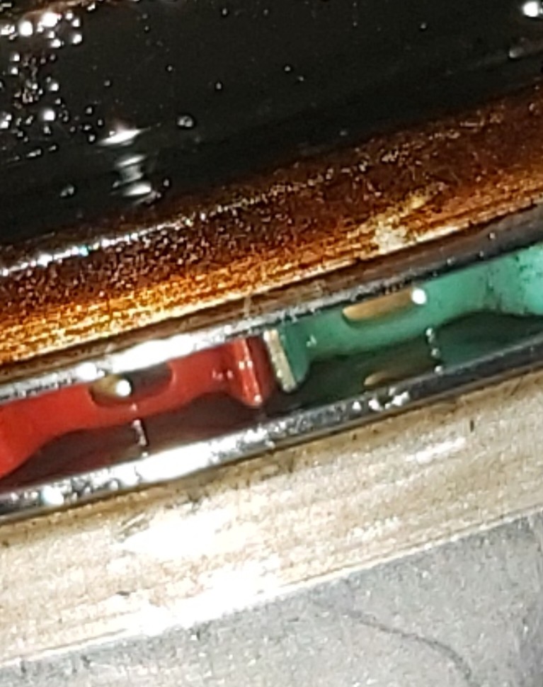

I use rings from the Nippon Piston Ring (RPR) company of Japan.
Ebay seller GoergeFix helped me out, reasonable prices, compared to OEM.
I really like the green/red color marking on the oil ring expander, which indicates clearly where the "butt join" is, and shows clearly where the upper and lower oil rings gap must be.

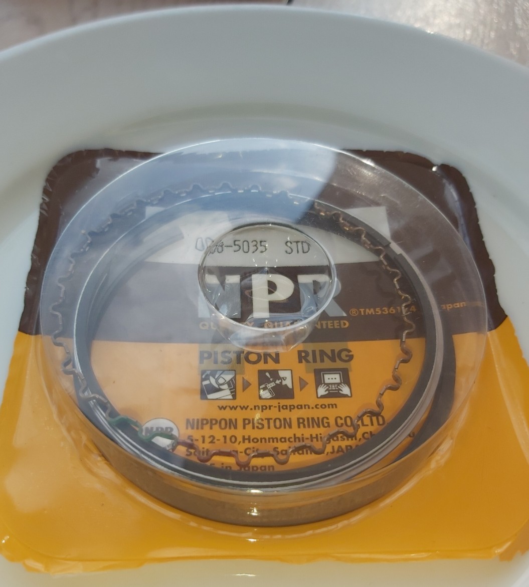

Nicely packaged too:
