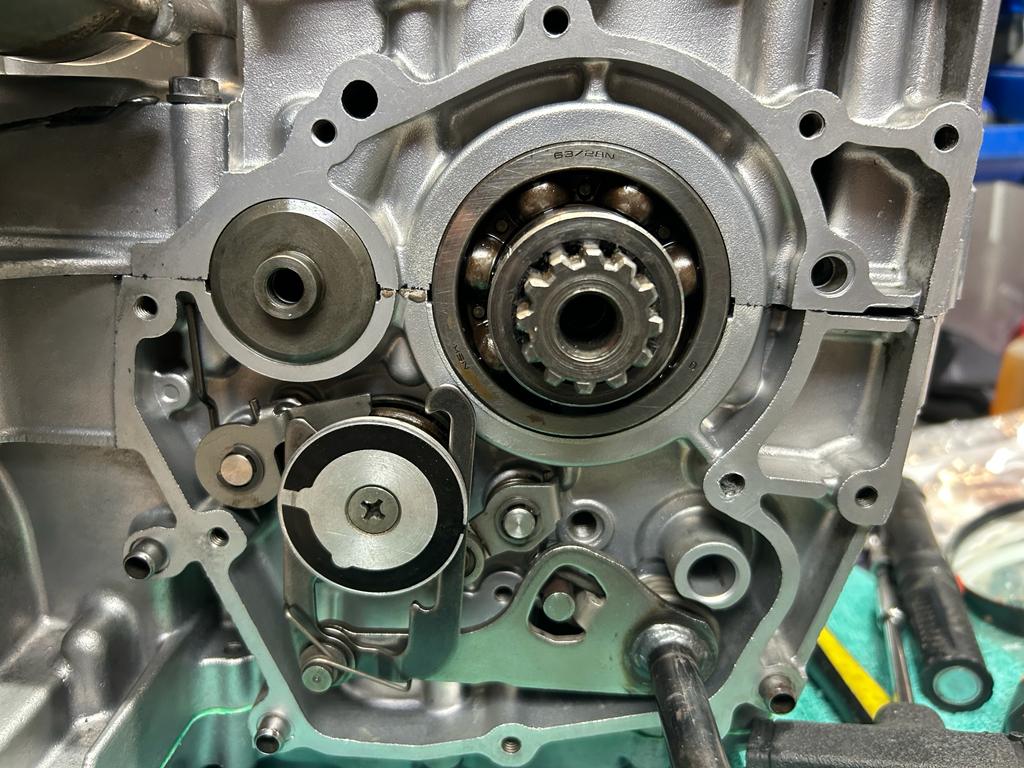

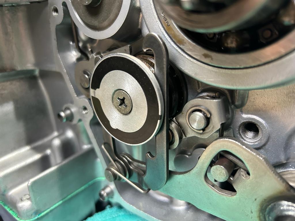

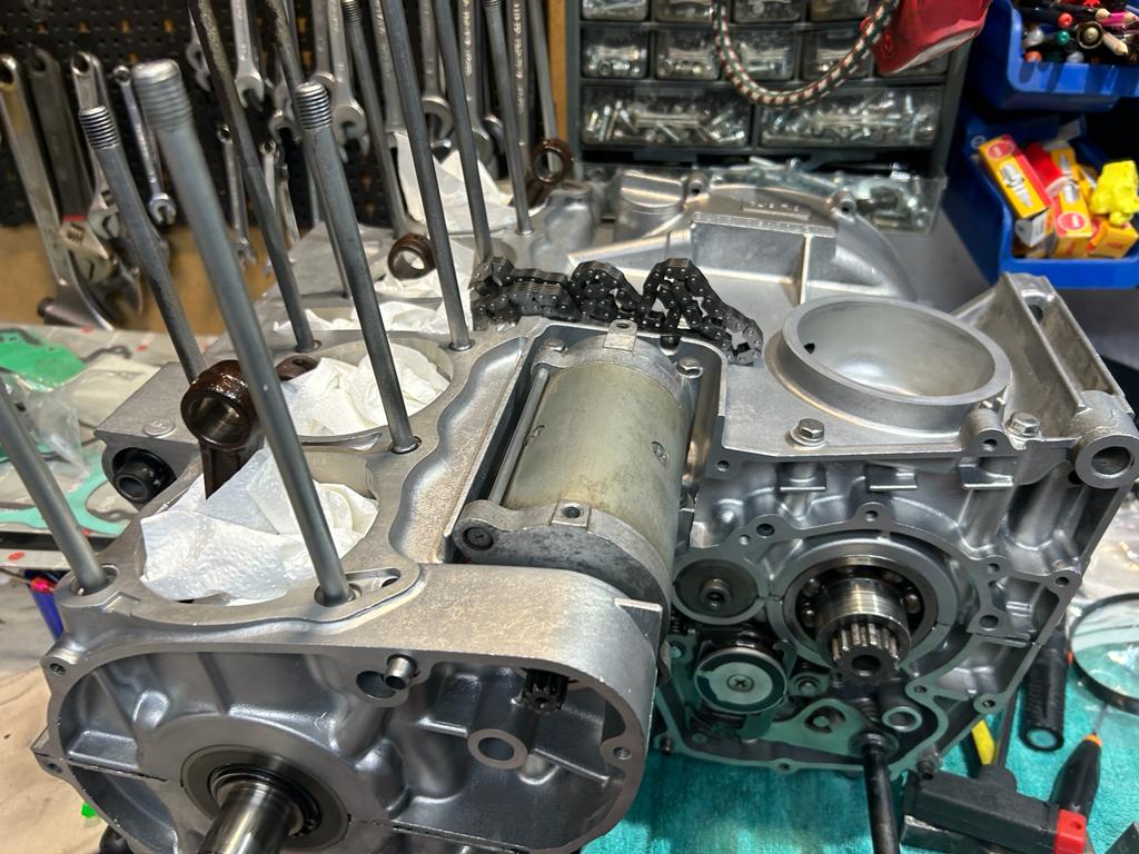

I may regret this later; but I looked and reviewed everything in the gearbox, and it looks OK. I could not find a way to adapt a drill to the shaft, so I´ve decided to move on. I have a solid first gear and a nice neutral. I´ll cross my fingers, and hope it works!
So, as I move on; engine is now "closed", and everything looks neat. New large bolts, and reused all the rest. No threads were damaged in the process... so we are ready to install the pistons now.
Happy to see some movement. Pics for reference, and for expert advice on any mistakes I may have made.

Pistons in place. Of course, I did drop a cotter pin into the oil pan, and had to take it off to get it. Of course it was the first one
Anyway; all done now. Ready to get the cylinder block on. I have a question:

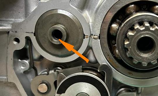

I don´t see any o-rings in the bottom of the cylinder block, just the gasket. Is that right?
I´m looking at this image, and I don´t see any. The manual says nothing about them.

No O-rings at the bottom, but 2 x 92043 locator dowels at the front outside studs...
