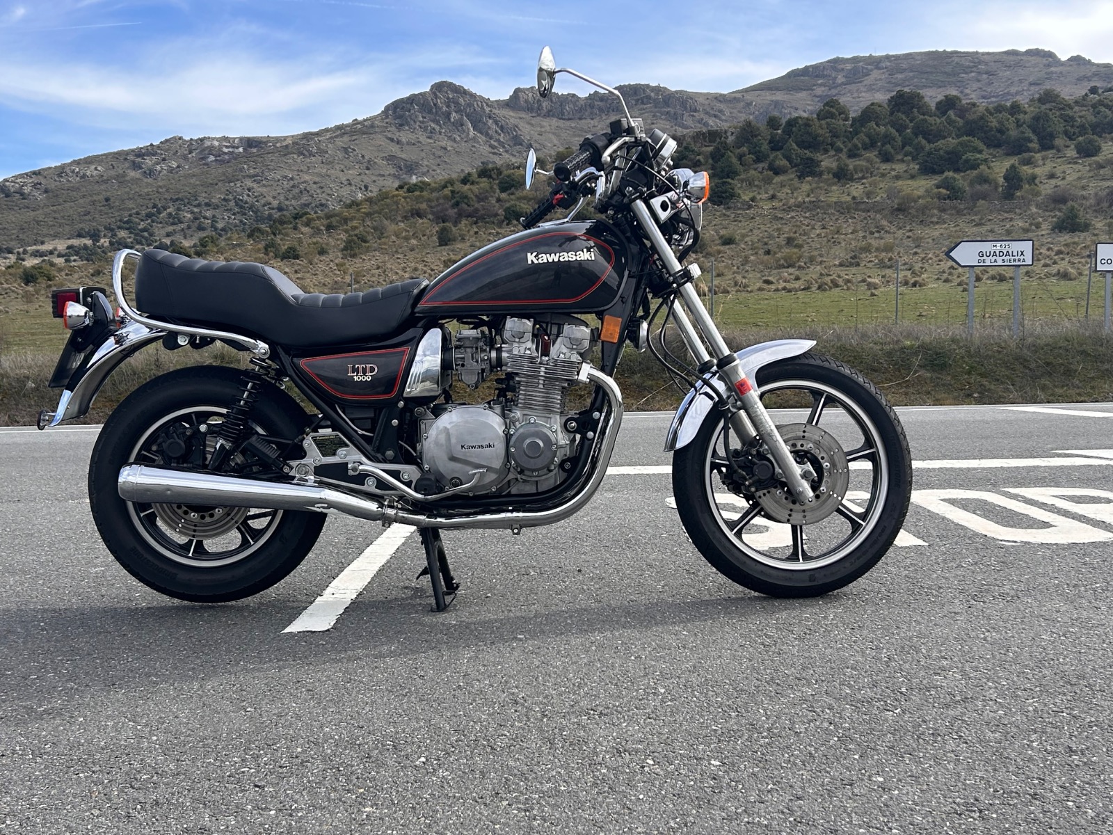

And yes, this is it! Got it’s MOT and finally got her on the road. Just a short (60 km) round trip to get acquainted with, and the realisation it is a much more manouverable bike than I expected, and a really nice engine, with great acceleration. I still did not thrash it, as it has done less than 100 km on the new pistons, but everything works at it should.
great experience.
need to get my speedo fixed, or I will start collecting fines really soon!
cheers
