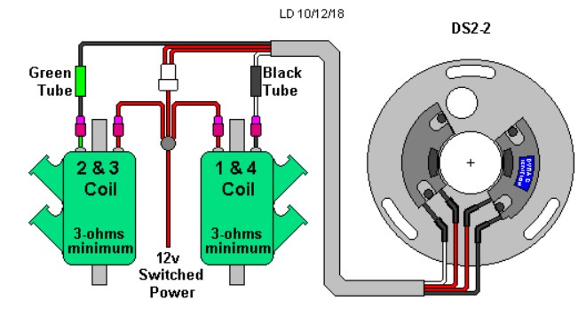

As I understand it "yes" and you can pick up the connections at the plug for the original igniter. Perhaps one of the guys who are using this system can speak up ?

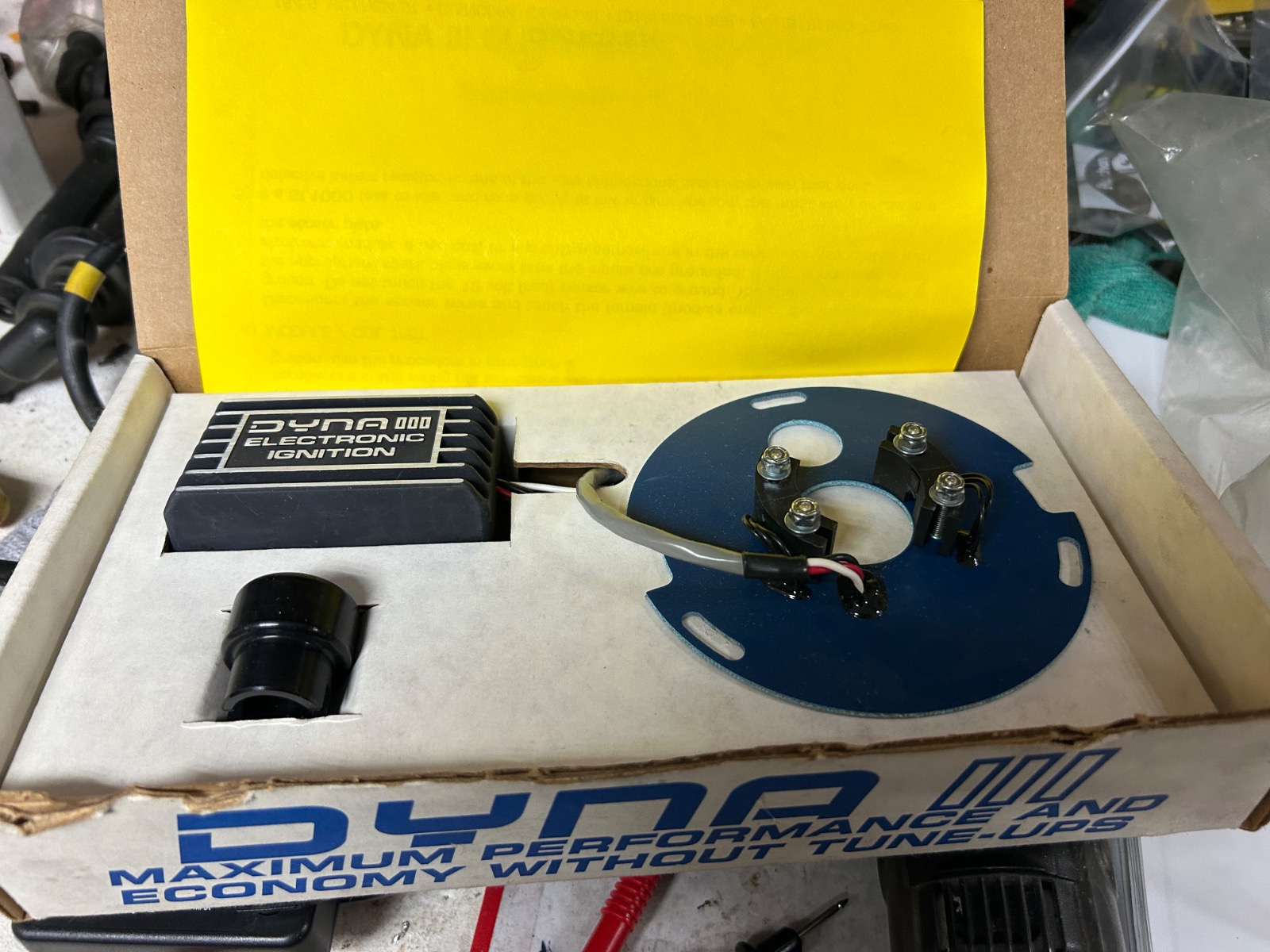

attachment=173817]IMG_4541.jpeg[/attachment]
Took Me a while to find the right box, but here’s what I’ve found.

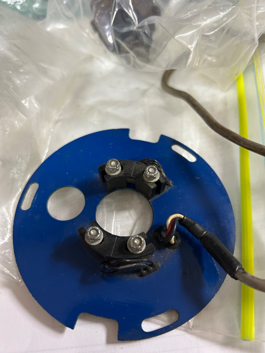

i have a complete brand new in the box dyna 3 system, and additionally I also have an extra pulse “board” that probably came from ebay too.
if I am reading your picture right, I could use the current coil setup if I was to use the dyna. Right?

Actually, as I already have the kawa igniter. I could just use the extra “board” I have and simply connect it to the existing cables.
would that work?

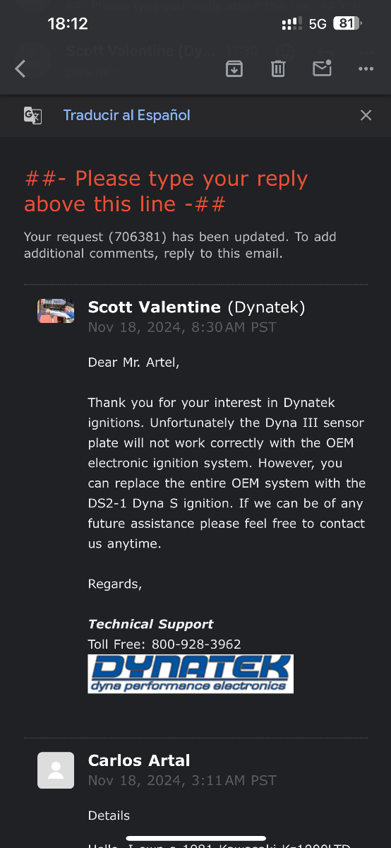

Got a reply from Dynatek. As follows:
Decision now is to go factory or dynatek.
my concern on going stock, is that perhaps the igniter will fail soon or is failing already, and spending cash on the factory part will be wasted.
what do you guys think?
