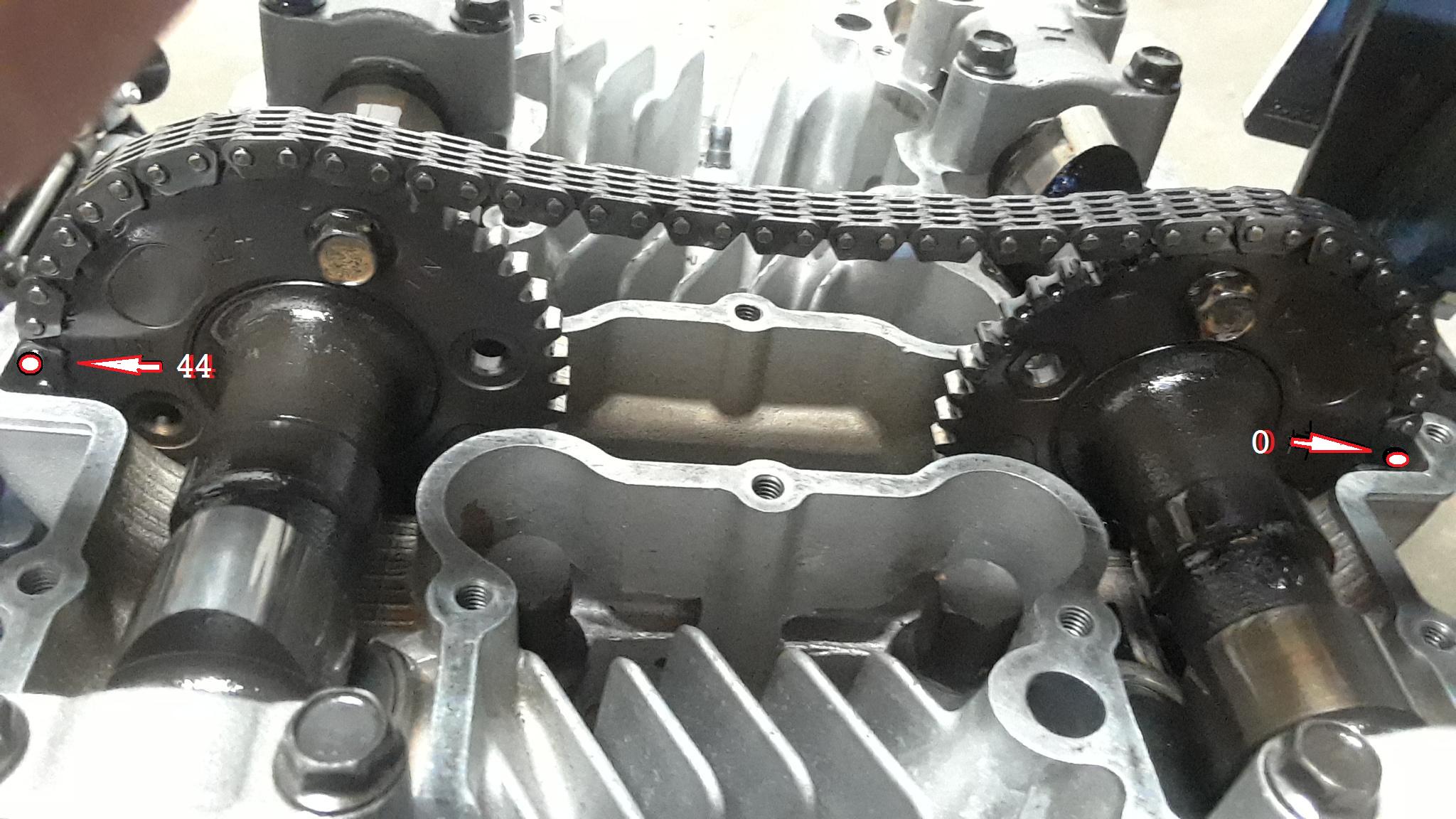

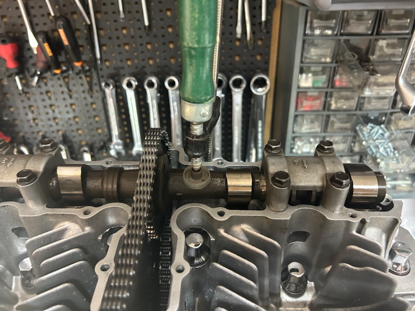

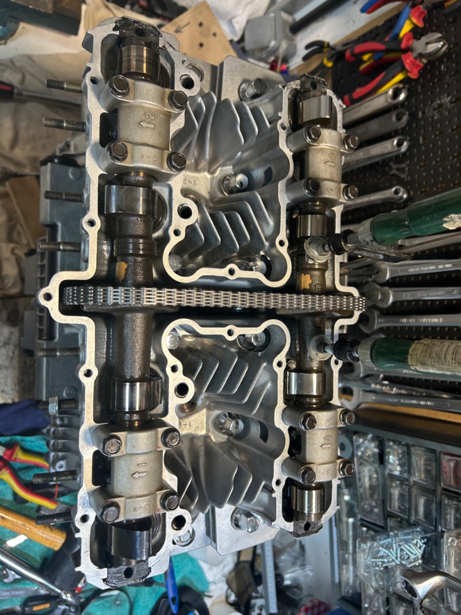

So… following all the advice; camshafts want in really well, being held down with a clamp. I did it differently this time, and I got the camshaft caps for the exhaust side in place before putting the intake camshaft in place.
So now I have both camshafts in place, two lined arrows and a 44 pin count from arrow to arrow.
Will follow advice and torque them down to a lot less that in the manual, and get the cam cover on and then the tensioner, rather than as the manual says.
looking good! Some pics for reference

23 Mar 2024 13:47Excessive chain slack between the cams?.
Doesn't hurt to triple check

Chain is brand new, kawa original. Will double check, though

Looks good nice work.One thing ... i might be wrong, but i think the camcaps on the intake is switched ?
The following user(s) said Thank You: daveo, cartal, howardhb
- zed1015
- Posts: 3314
- Thanks: 2012
Re: Piston Hole Kz1000LTD 1982
23 Mar 2024 15:44 - 23 Mar 2024 15:46Looks good nice work.One thing ... i might be wrong, but i think the camcaps on the intake is switched ?
Yes! You are correct.
Well spotted.
3 and 4 need swapping back otherwise the cam endfloat won't be controlled.
Last edit: 23 Mar 2024 15:46 by zed1015.
The following user(s) said Thank You: daveo, SWest, cartal

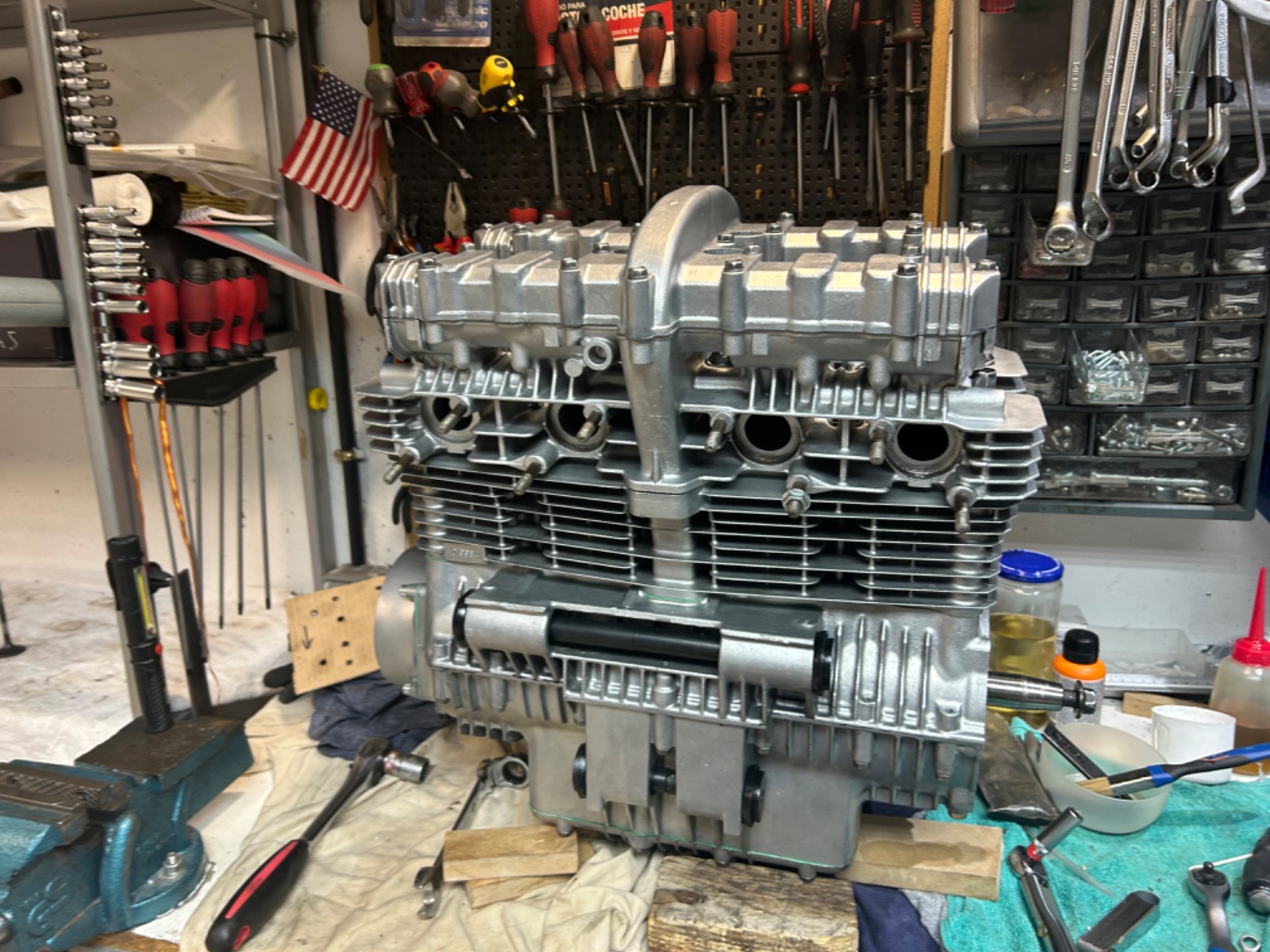

Wow! That was a close call. I must have misplaced them in any of the xx times I took them off. Thank you so much guys!

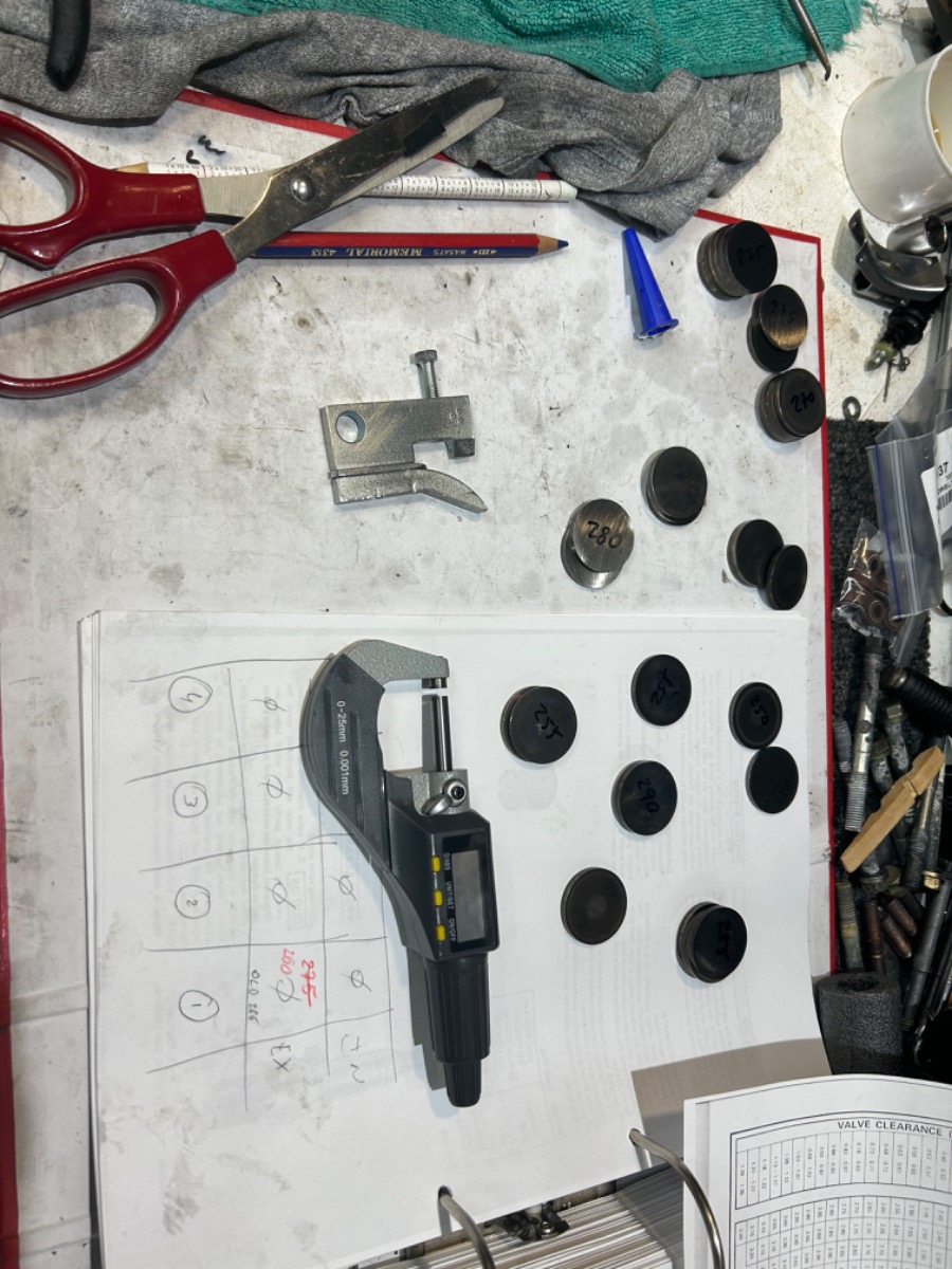

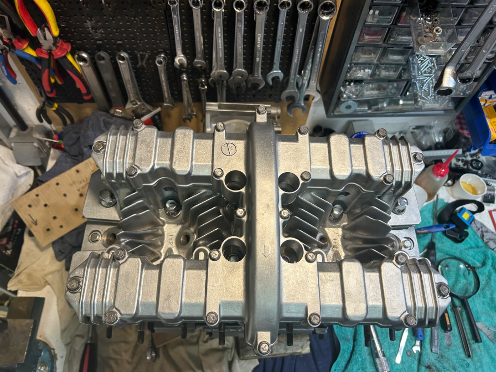

i had actually not read the thread and went along with adjusting the valves.
triple checked the timing and all seems ok to me. Chain is really taught now the tensioner is on.
opened the cover and held the camshaft in place with clamps; and swapped the camshaft caps.
valve adjustment is done, all of them close to 0,15.
ready to move on to the frame!
some pics again
some pics again
