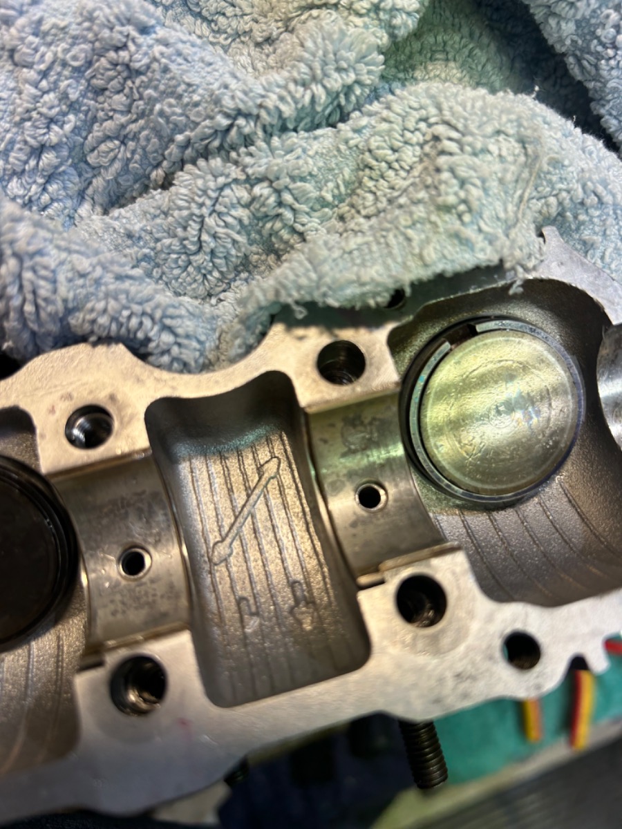

Probably my poor english playing havoc again. Stripped the threads of the bolts holding the camshaft "carriers".
So far:
- 1 completely stripped
- 2 running "soft"
Will make sure all are checked, and repaired. I can see a lot of helicoil practice in my near future.
So far:
- 2 running "soft"

18 Mar 2024 09:33 - 18 Mar 2024 09:39Sorry. I don’t understand the question.
it’s these bolts’ thread that has been damaged:
I see, in that case I use helicoils to repair those threads. Sure you can use other methods but if done right they will last a long time at a lower cost and effort. I munged up a bolt hole then had to use a 8x6mm insert to fix it. Still running strong today.
I don't edit my videos to show just the successes like others do I show my mistakes and how I overcome them. Sometimes it's a wild and woolly ride.
rumble.com/v26mqro-installing-the-insert.html
rumble.com/v26n196-finished-the-insert.html

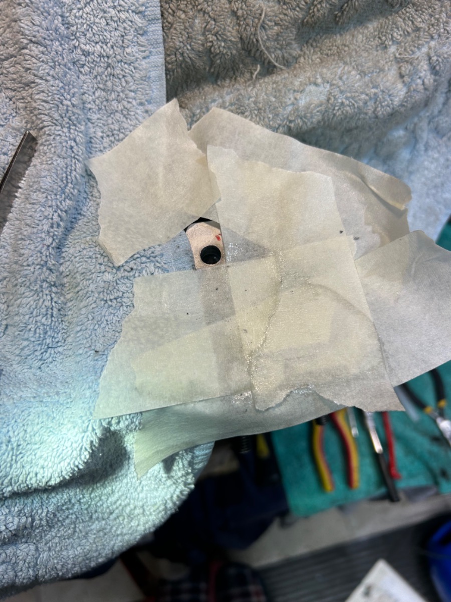

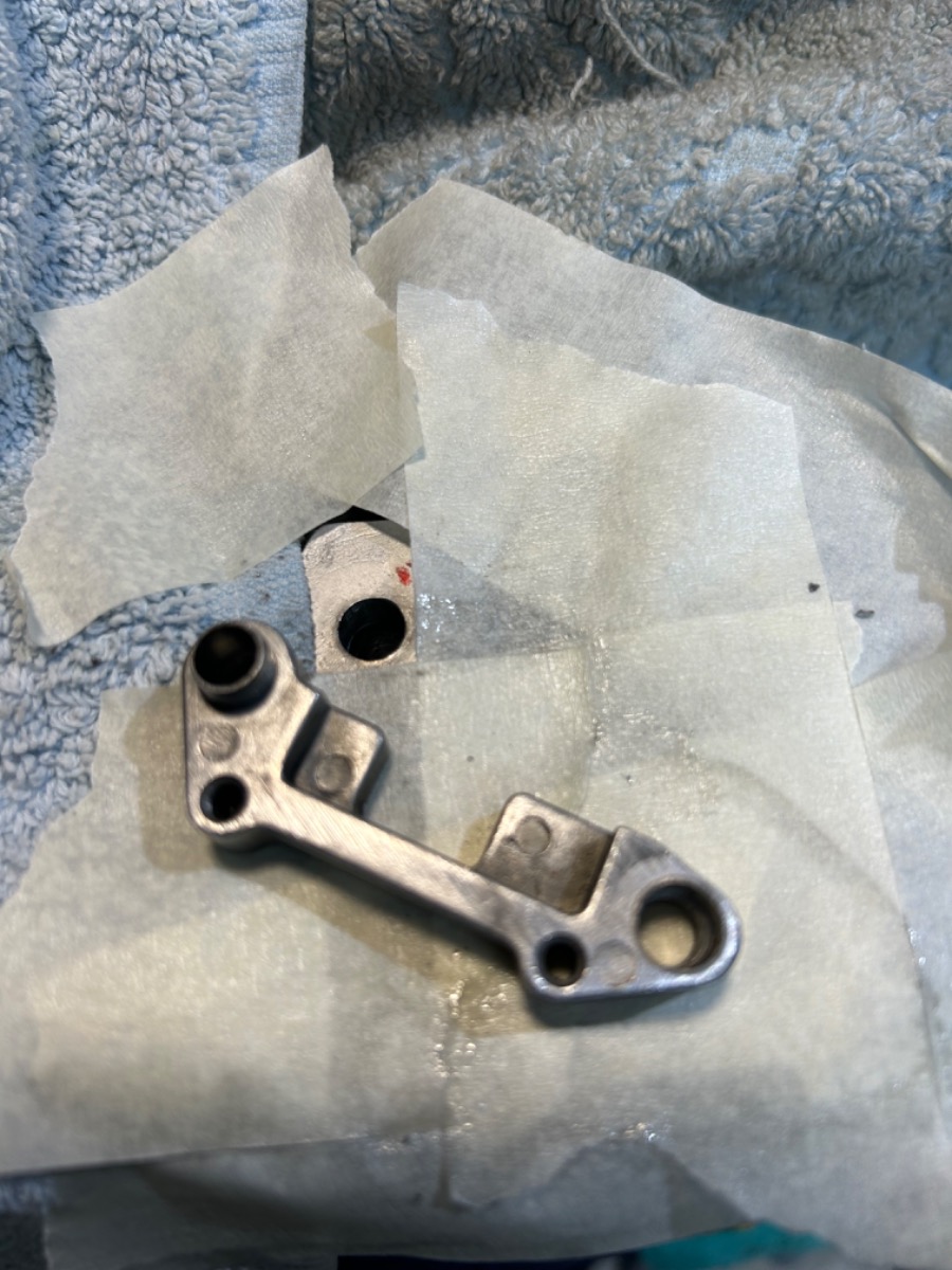

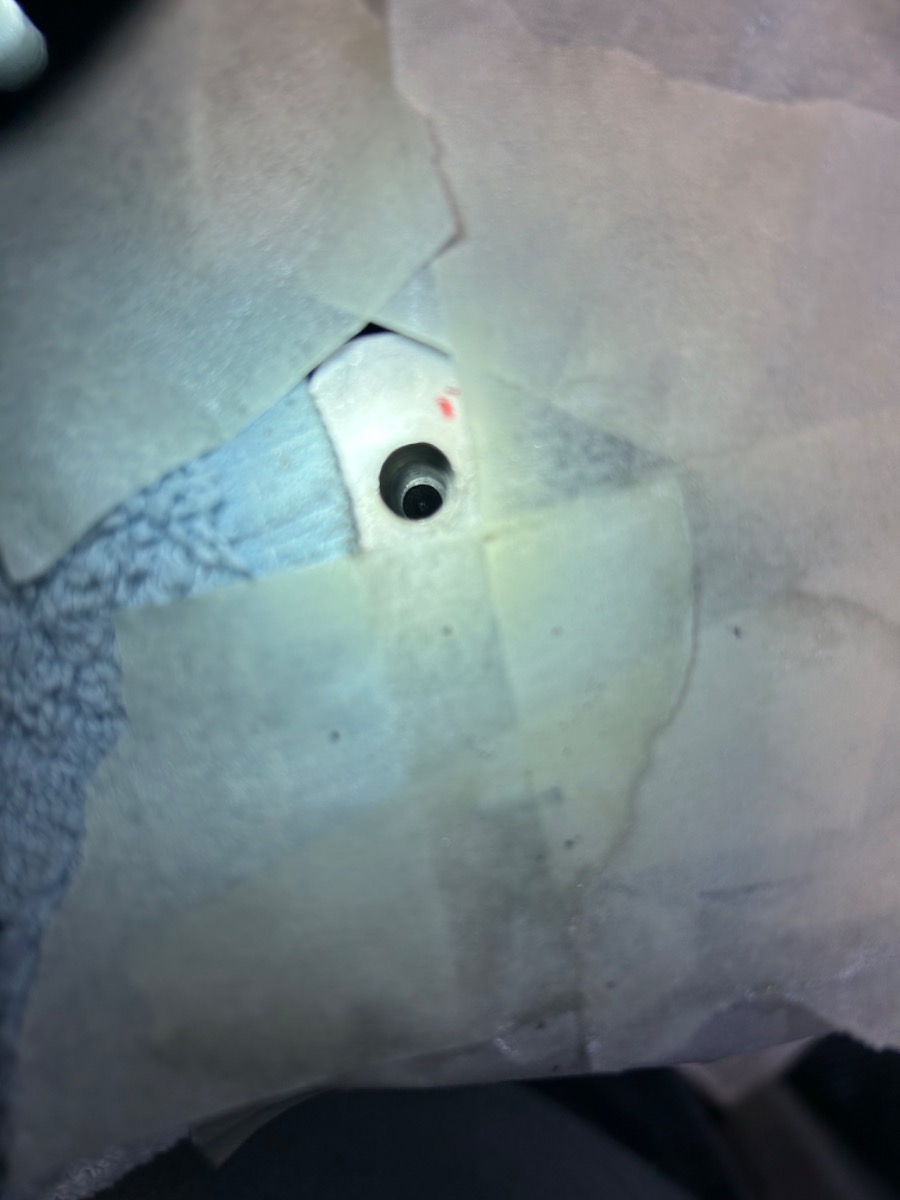

I ended up doing 5 threads yesterday. All helicoils went in perfectly; no issues.
i had been thinking all week on how to get the drill 100% straight, and ended using a small bracket out of a vfr750 engine I had had lying around for years. My Diogenes syndrome, and keeping all kind of useless stuff in boxes, paid back this time.
with the new threads done, I will attempt cam assembly again this evening.
some pics for reference

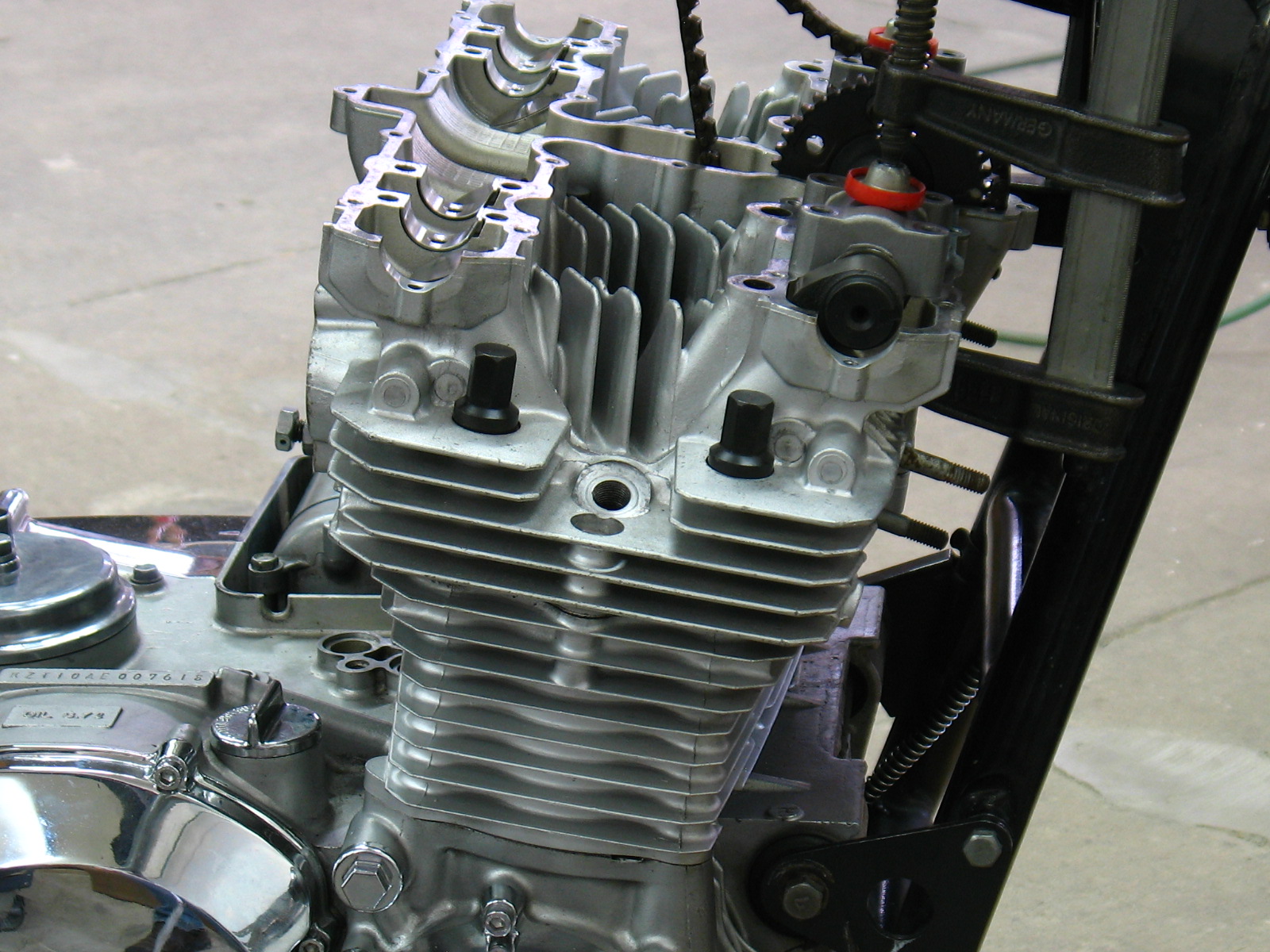

The old Bessey clamps have saved many threads
They hold both caps down securely, before I remove and/or install the bolts.
