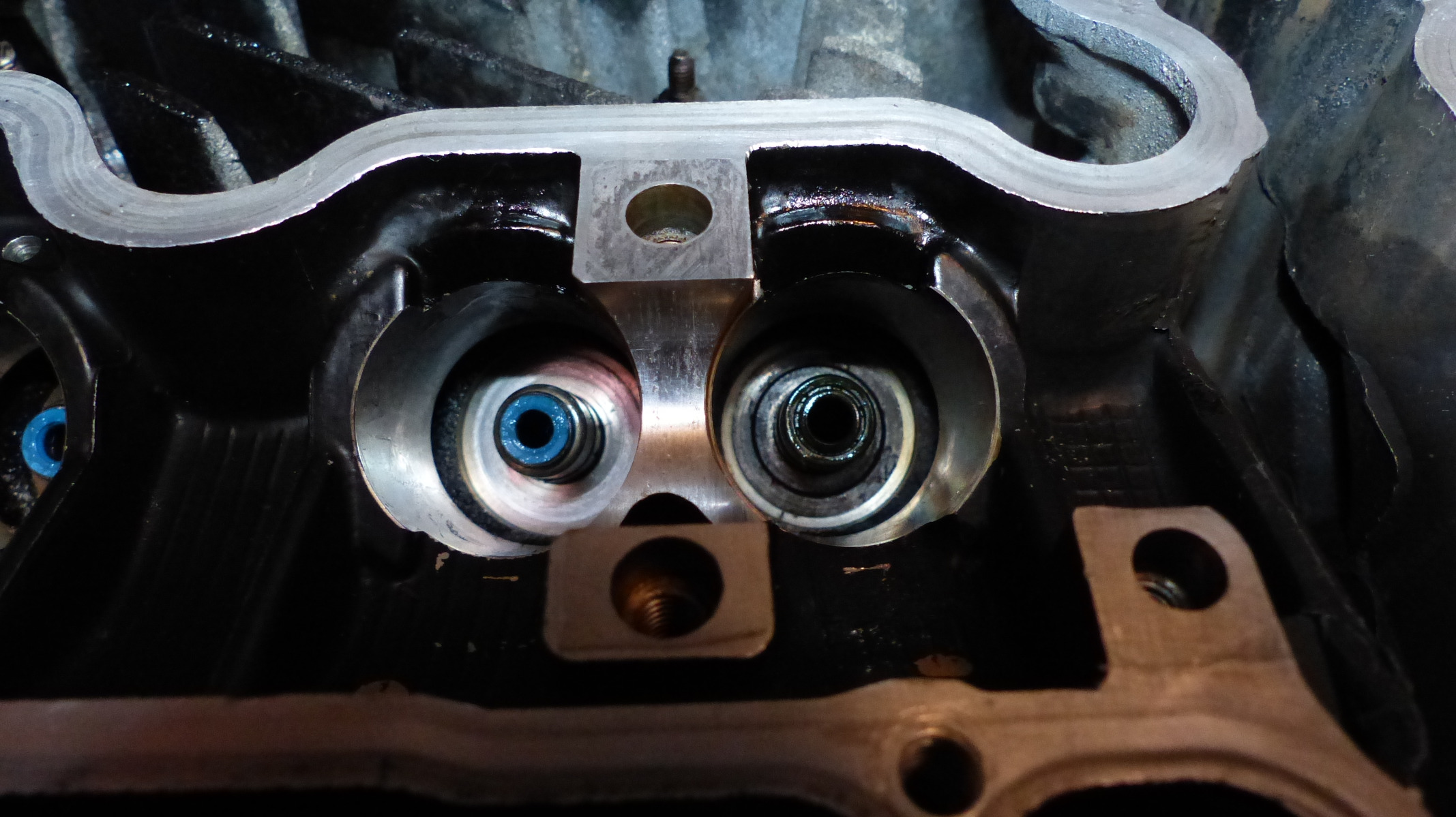

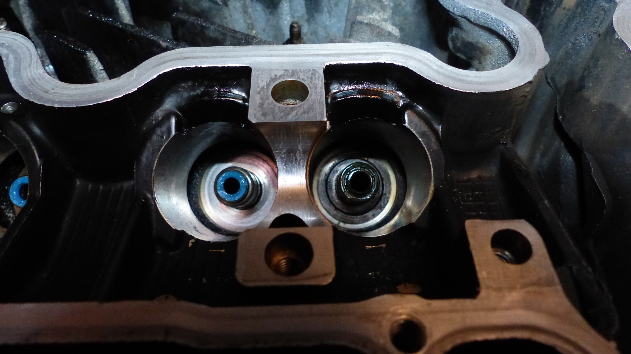

Hi the valves look nice if i was you i would lap them more to get them sealing so the engine get max compression and good coling on the valves. Lap them several times before testing them shifting between coarse and fine paste.

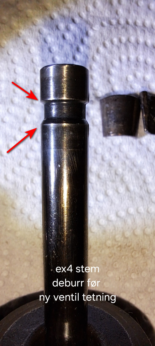

About the seals yes they are easy to just push down on this engine you feel they snap into place. I just did same work and decided to change the seals because i did many attemts to get the valves to seal and had to take the valves in and out many times .I had deburred / grinded sharp edges where the red arrows points in the picture when doing the valve job and the valveseals was only used for about 10 kilometers because i replaced them when engine was in the bike right before winter
.I decided not to take the risk reusing them and have to do the job to replace them when engine is finished and in the bike again.Replacing the seals when engine is in bike is a frustrating pain.
Anyway it is important to deburr where the red arrow is in the picture if it is sharp edge there .If not you risk damaging the new seal when putting the valves in .
Good Luck

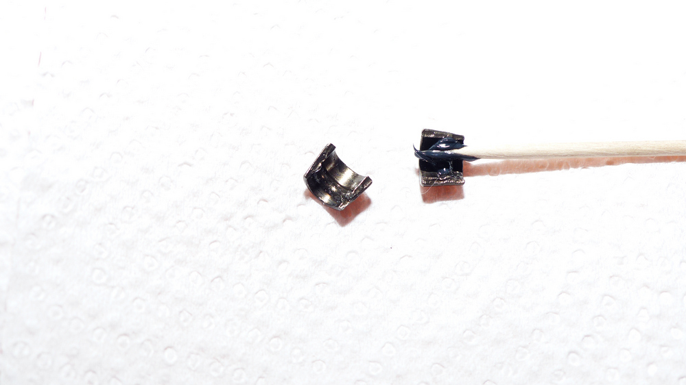

I forgot to ask if you are using the oem seals .Some bikes have upgrade seals made of viton and they have a metal jacket .I installed viton seals on my fj1200 and that type of seals need a tool that fits the seal and more force is needed to push the seal down on the valveguide. You can also use a socket that fits . If you dont already know there is a trick to make the install of the valve keeperes much easyer.That is to use grease on the inside of the keepers or on the stem they will then stick to the stem.

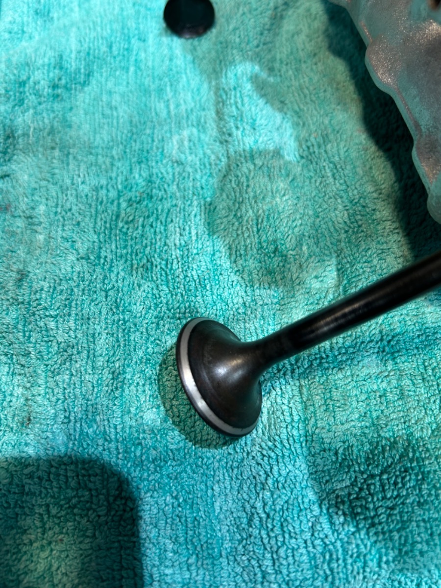

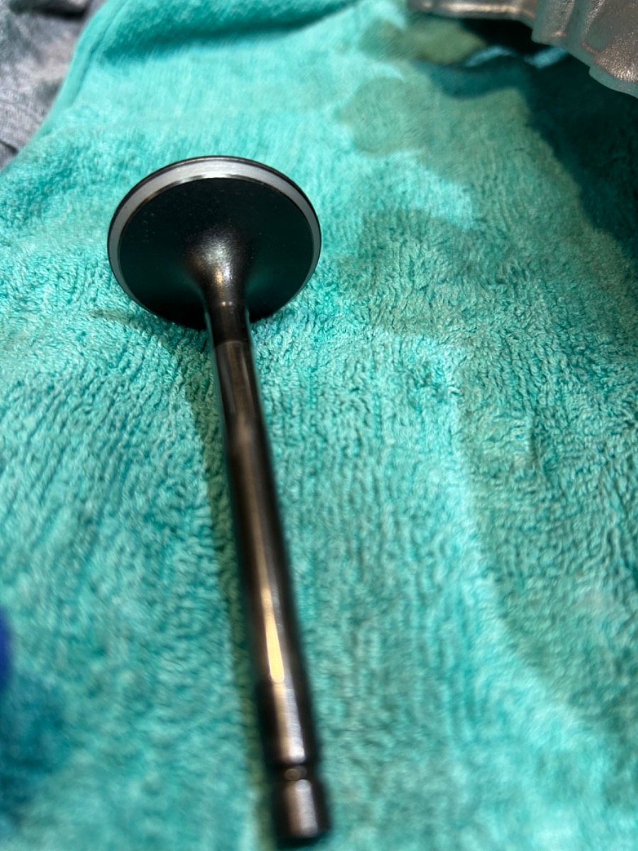

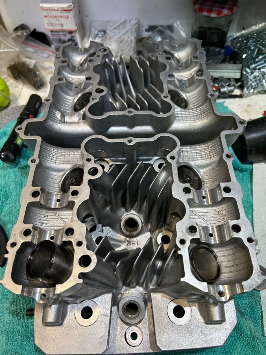

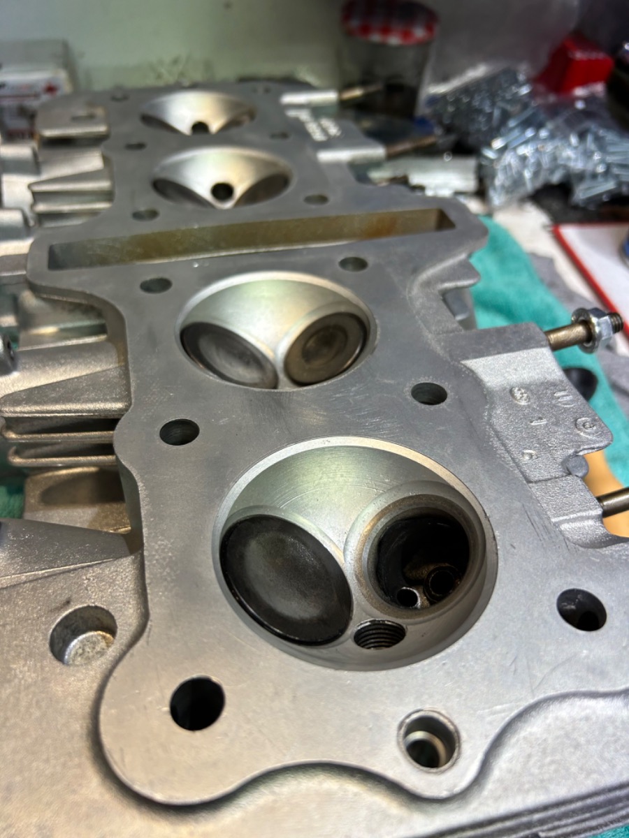

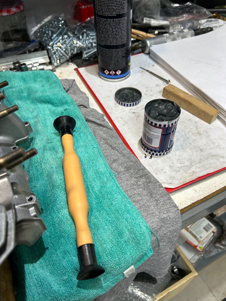

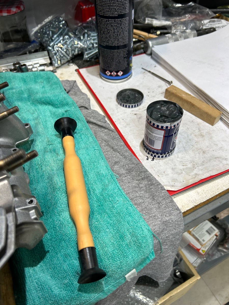

Thank you both. I think I was being a little lazy, and was having high hopes from little work. I took all all springs and stuff off again, and started with left exhaust valve. It had some little tiny spots in the “bright line”. After 15 minutes of lapping with both coarse and fine paste, they are almost gone. As said, I was missing “elbow grease”. Will redo all valves until all are spotless. Some pics for reference.
yes, I am using oem seals. I will take a look at them after the valve job, and probably change them, just for peace of mind. As you say, valve comes out many times.
Cheers!
Cheers!

03 Mar 2024 09:59 - 03 Mar 2024 10:00
I hope it will reflect in valves being closed, but definitely, spending some time on each valve makes a big difference

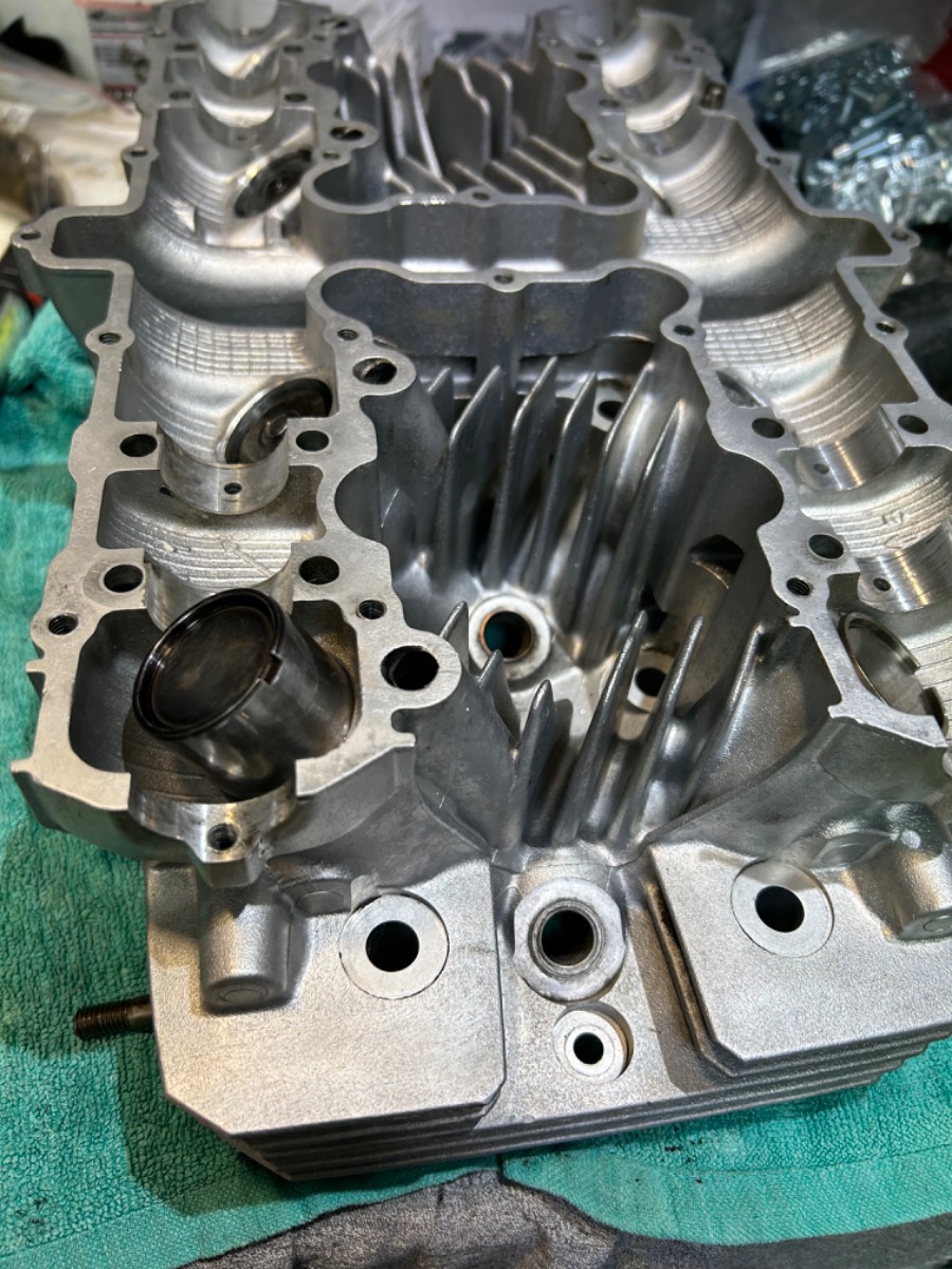

- cartal
- Posts: 262
- Thanks: 129

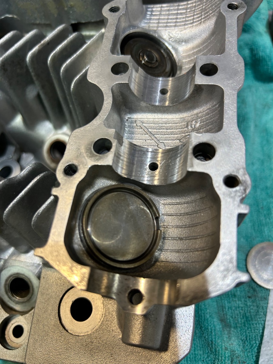

Re: Piston Hole Kz1000LTD 1982
06 Mar 2024 11:07

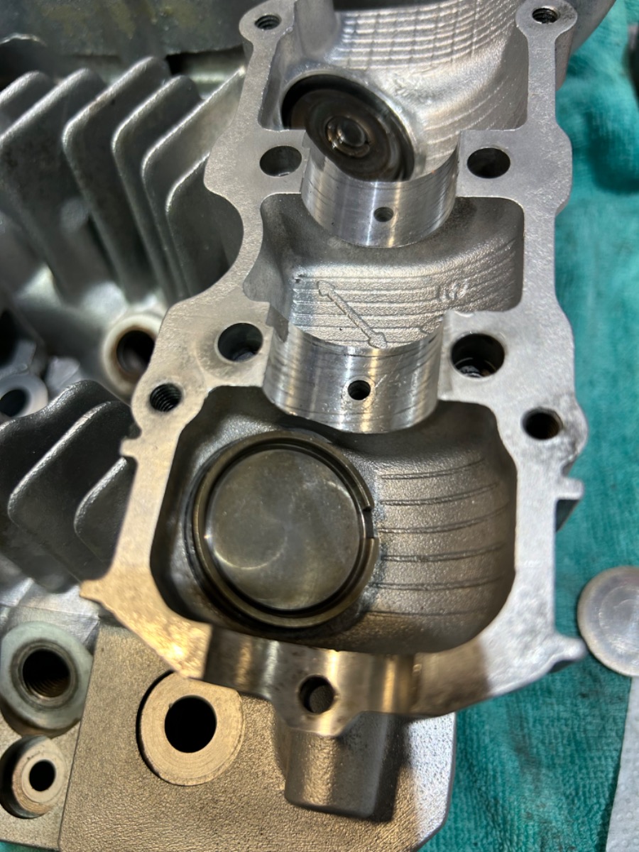

Some pics to illustrate
I even cleaned one of the buckets with a 600 grit emery paper. Not much of a difference
- Posts: 6669
- Thanks: 4205
06 Mar 2024 11:32
Are the springs centred on the valves, the buckets should just drop in with no noticeable resistance (any tighter and you will have a valve stick open and destroy a piston) is there any marks in the head from the "valve spring compressor" causing high spots in the bucket housings?
The following user(s) said Thank You: cartal
- cartal
- Posts: 262
- Thanks: 129
06 Mar 2024 11:46
I don’t see any noticeable marks in the bucket housings. They definitely don’t fall in place. I did all valves to a cbr900rr a few months ago, and buckets were completely loose. These are really tight.
the one I got in (and cannot get out), will spin if pushed with a screwdriver (and some force), but it’s definitely not “loose”.
I’ve tried all of them and none will fit. This is possibly the strangest thing I’ve ever seen.
no, no… I’ve double checked and I’m not mixing engine parts
