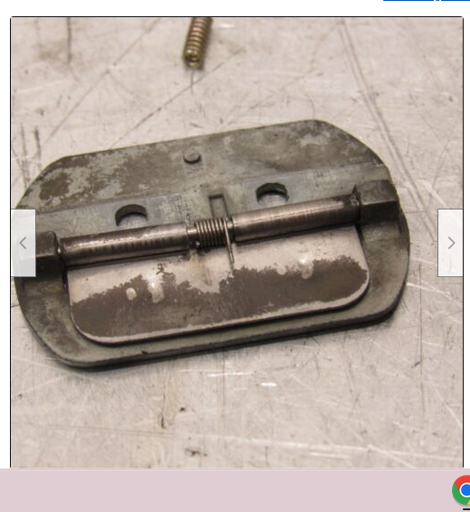

They are Keihin carburetors. I don't know model or size. There is no enricher. Threre is a lever that closes the choke plates.
To eliminate voltage drop, I ran a jumper wire from battery + to coil +. Also jumpered from a car battery. It still would not start with a reasonable amount of cranking.
I will look into choke opperation some more. Maybe not compleatly closing or the hinged door on the plates are not working correct.
Ebay pic of a kz305 choke plate.

I'm getting somewhere. Two cold mornings in a row now, the bike started easily by blocking the air box intake with a piece of cardboard.
The choke plates are fully closing, but I'm wondering if the springs on the hinged flaps on the choke plates have gotten weak and are opening to easily. Partzilla does not break the carbs down far enough to just get the hinge springs. What is the purpose of those flaps and what may it hurt if I seal them shut?

17 Dec 2022 11:09Sealing them shut will probably cause it to stall out, with the flaps closed some air still needs to get in to feed the motor. If they where sealed you would likely need to start backing off the choke too soon to allow the motor to runI'm getting somewhere. Two cold mornings in a row now, the bike started easily by blocking the air box intake with a piece of cardboard.

17 Dec 2022 16:56I'm getting somewhere. Two cold mornings in a row now, the bike started easily by blocking the air box intake with a piece of cardboard.
If a new spring isn't available, I wonder if adding a small amount of weight to the flap would help. The additional mass would keep it shut a bit more - using gravity rather than spring power - while still letting some air in (which is necessary, as Wookie58 indicated). You might be able to tape a washer to the flap to start; it shouldn't take much weight to change the operation.
