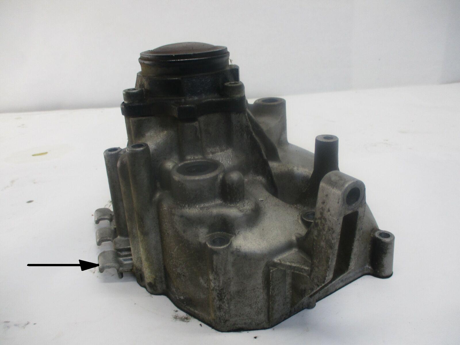

I recently bought a 1979 KZ1000st. I am taking the motor apart and have a stupid question. While taking the shaft drive bevel gear case, I snapped one of the three rectangular tabs on top.
It doesn't seem they do anything, or do they. Should I worry about that or? Thanks

Yep, those tabs. What are they for. Don't seem to do anything, except causing grief when someone accidentally break them.

I'm guessing that it's a guide for your alternator wiring. It is weldable and/or rebuildable by a good welder.

Those tabs are cable guides.
One missing won't really cause an issue so either weld it back on or just tidy the rough area where it broke off with a file.
