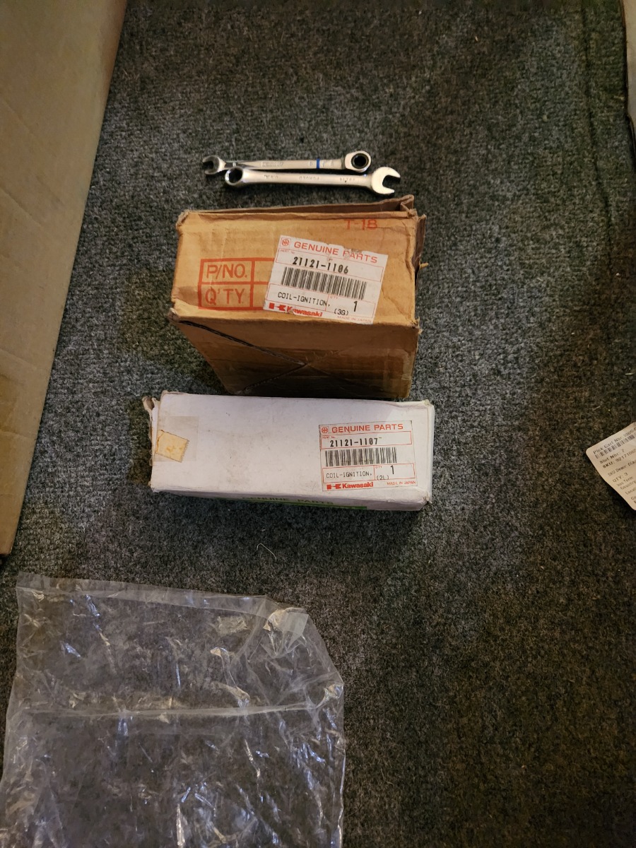

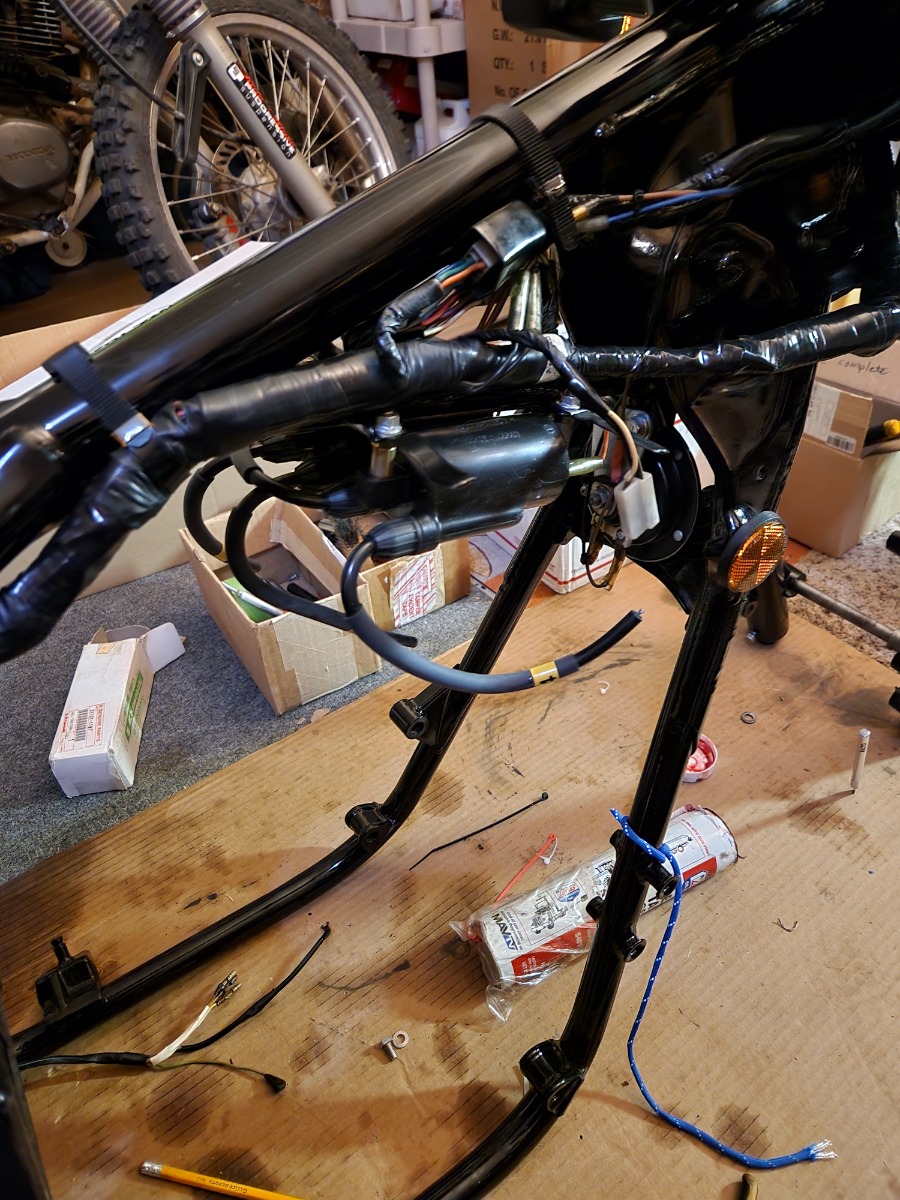

13 Nov 2022 16:51I agree, I think this is the route I'm going to go for sure. This is all going on a frame off 81 gpz550 restoration that's been in the works for years.A Wiseco big bore kit would be COOL! There is more than a few of those running around, so that's a good sign.
I finally got all of pieces and time to assemble it. I even found brand new oem nos coils...left and right from Thailand! And it only took two weeks to get!

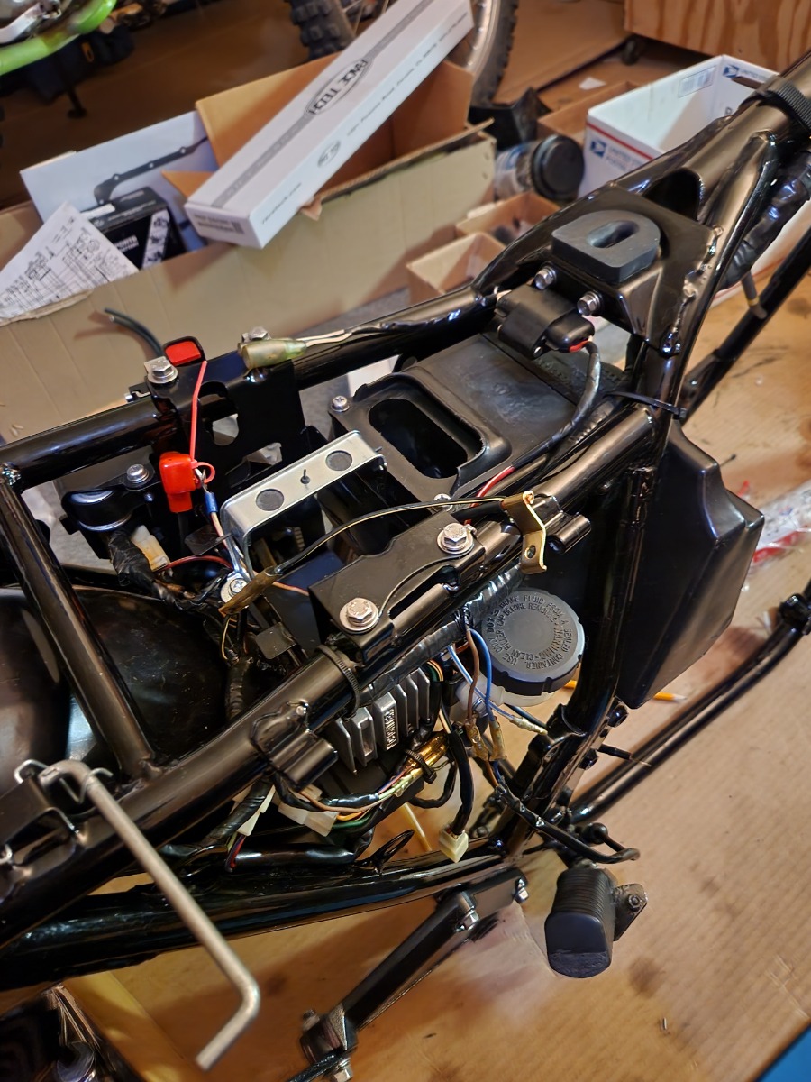

The 650 is a new purchase, and I haven't really started anything on it yet, but I think it will eventually become a frame off. I really think it's a cool bike, first 650 I've owed and just love the way it looks, the stance, eveything. I've been looking for one for years but it seems all KZ's have dried up including the 650's. My theory, which maybe full of beans, is that foreign buyers are buying up all the old classic aircooled bikes and shipping them overseas to collectors and custom bike builders. First went the big bore and two strokes...now even the small and medium bore bikes. Look on Craig's list and all you see are "Want to buy your old Kaw, Honda etc.." ads.
Right now I'm assembling my frame off 81 gpz550.
