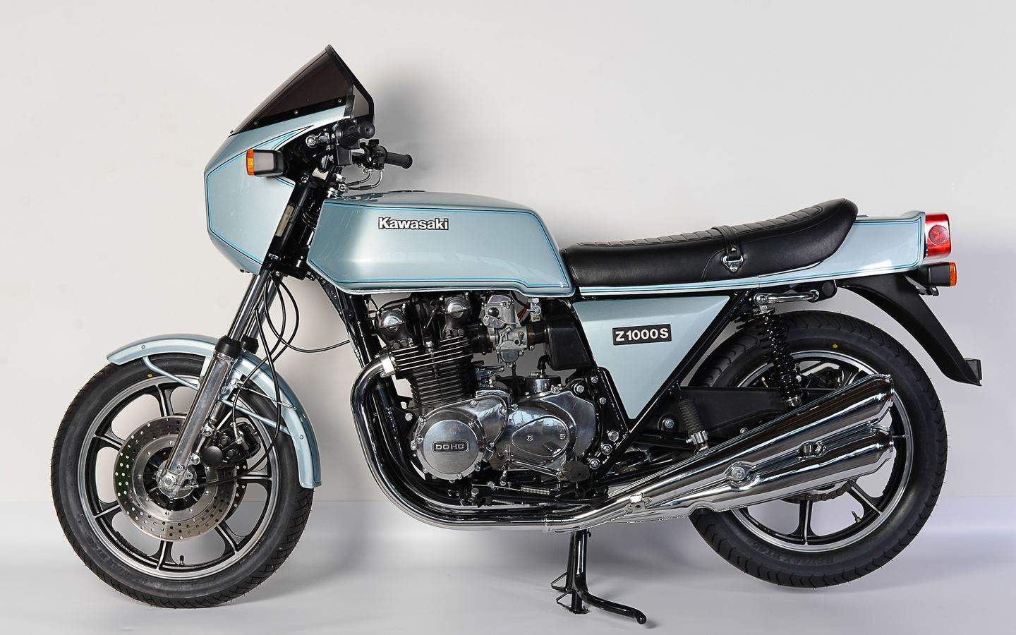

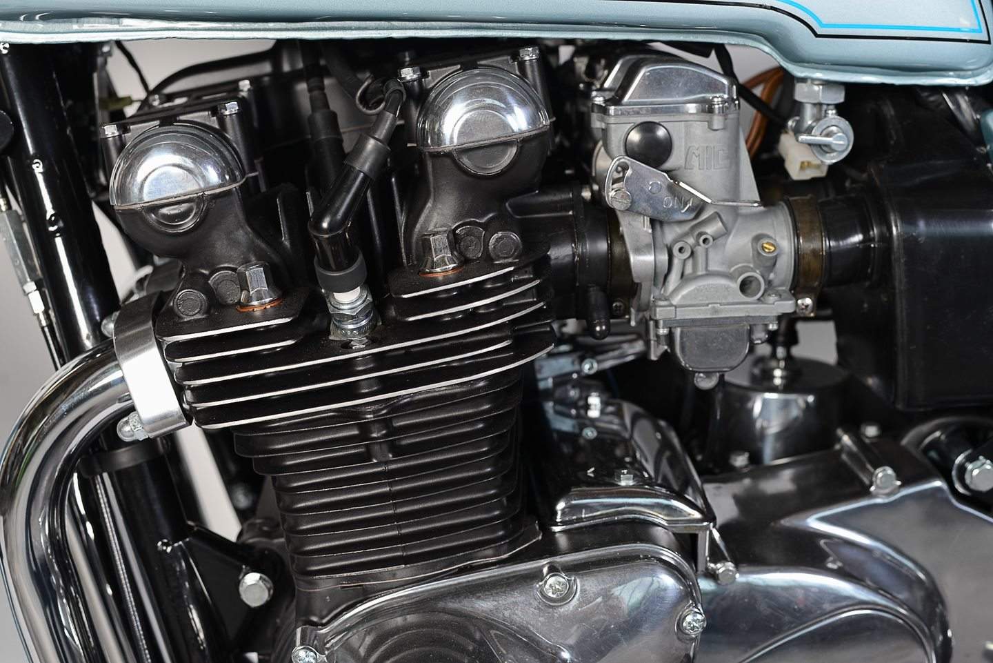

1978 Z1R = 122 cam chain links = 15 tooth on crank and 30 tooth on cam sproket

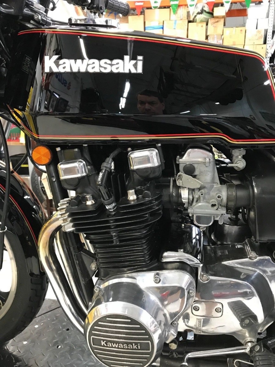

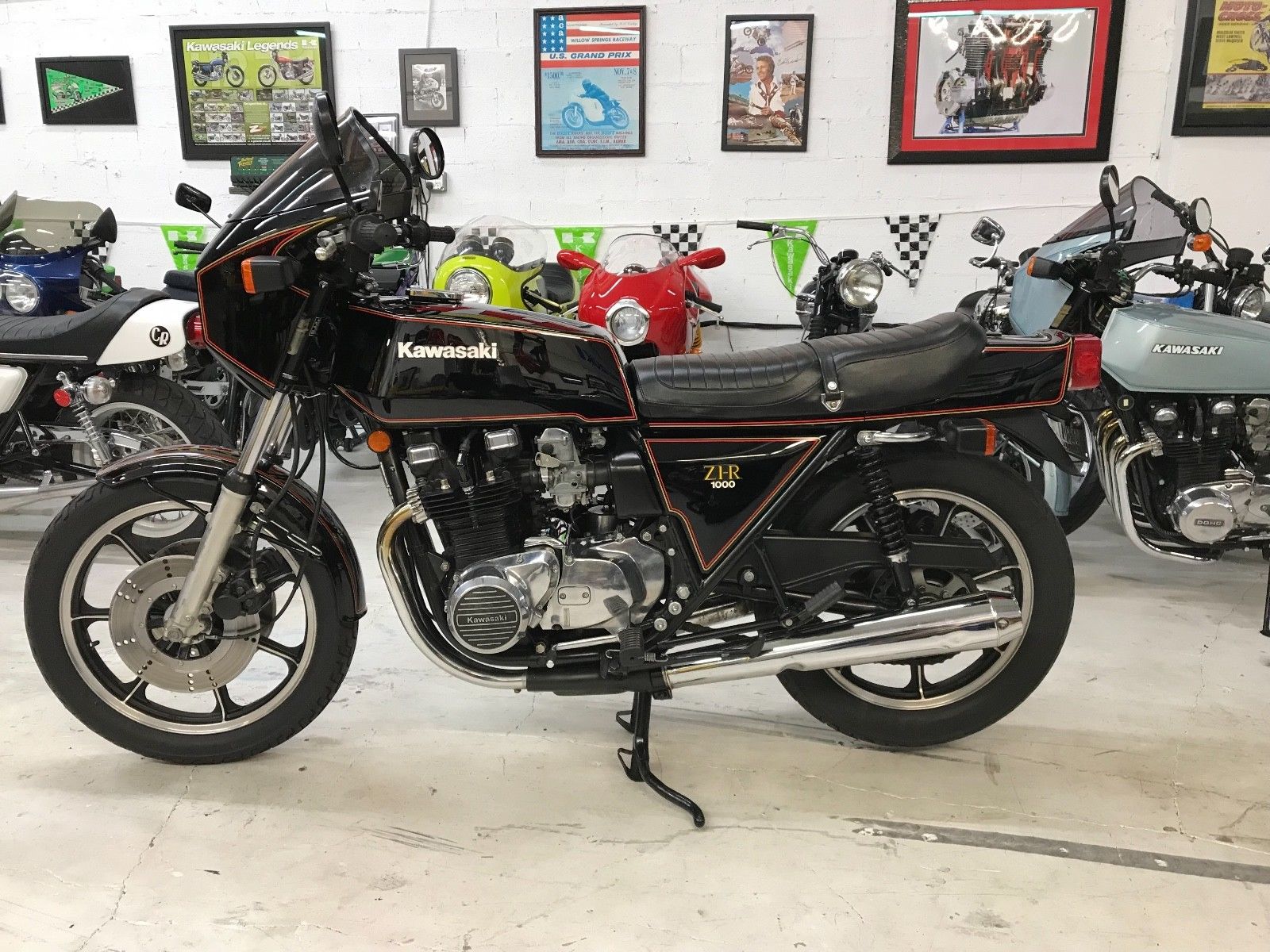

1980 Z1R (MKII engine) = 124 cam chain links = 16 tooth on crank and 32 tooth on cam sproket
The shap of the cyl. head are and valve cover are different and the distinguishing feature!
