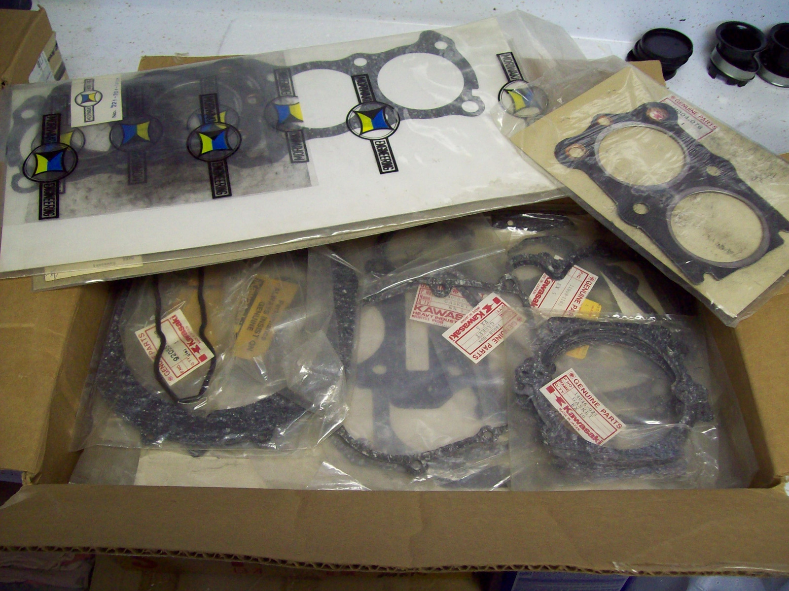

I don't know what year and model motor you have, but I just looked up a base gasket, center o-ring, and a valve cover gasket for what my Kz1000 motor uses. CAN'T BELIEVE O.E.M. KAWASAKI RETAIL PRICES!!!!!!!!!! 49 bucks for a base gasket!!!!!! 105 bucks for either the center o-ring or the valve cover gasket!!!!!! If I needed those gaskets I could not even afford to buy them at today's prices!!!! Glad I got a $hitload of all these gaskets on hand from like 35 years ago!!!!! I see why most folks are buying aftermarket gaskets like Vesrah now instead of O.E.M. Kawasaki!!!
