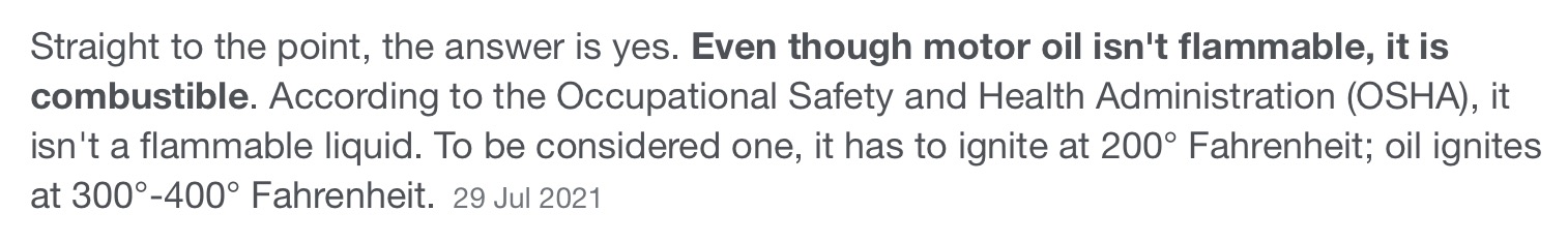

Hi gang the tachometer drive drips a little oil in true z style. Adds authenticity i guess. My question to you is this, has anyone ever had a fire caused by this drip of oil on the exhaust headers? I've had leaky old bikes for donkeys years and never once so much as a flicker of a flame. Came across an article about the flashpoint of oil and it's well possible in theory as the pipes get cookingly hot, so i wondered if I'd been lucky all these years by not going up in smoke like meatloaf's chopper. Seems such a fuss to put a new o ring in the drive, and it does keep the frame from rusting. Just a thought to add to my many other useless ideas. Ride safe.

I'm not sure what you ride, but wait until exhaust pipe gets red hot with dripping oil. It will catch fire in no time.
I have a four cylinder bike (750) and I had one coil not firing due to faulty wire can't remember which two but pipes got red hot. Mine is also elec. tach, so so didn't have to worry about oil leaking from tach take out. But repair is simple enough so why not take care of it?
Hate to see one of these classic go up in flame.

The risk varies with he type of oil you use but I have seen cars that have caught fire because of oil leaks (I appreciate that "under bonnet" temps are probably higher but the "risk is real") The risk is highest at the end of a long ride when you have put it back in the garage as there is no airflow. Why take he chance ?

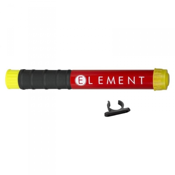

This is small,(12.5 in) and might fit somewhere, just in case.
www.xtremediesel.com/element-40050-e50-p...le-fire-extinguisher

At the end of the day the decision is yours, I just don't get avoiding a minor repair and living with the risk ( however small) and the mess. Injected has said it just smokes but there is a fine line between smoke and reaching the flash point. I have seen engine oil flame instantly when spilt on a hot car exhaust manifold (fully synthetic to be fair)
