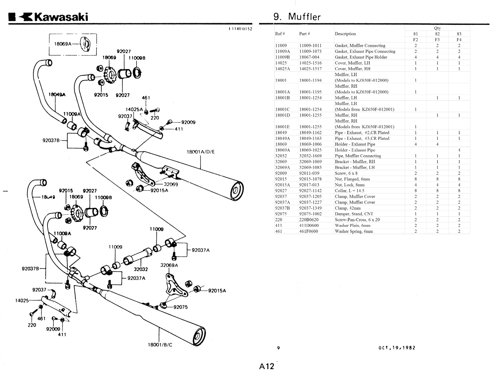

Sorry I do have a B1 but do not want to go and pull one off and measure it,  Will say I have access to several parts list for some of the 650 models and the only one that mentions anything other than part # and name is for the F2,F3 and F4 list that has this info L=14.5   Not sure what that means, but would think some one has some in their parts and could measure them.

The F2/F3/F4 exhaust collars are probably the same as the KZ650-CSR & they're shorter than the earlier collars, because the models noted have flanges welded to the header tips.  The earlier 650s have flared header tips, so the collars are longer.  The exhaust pipe collars for your 650 appear to be available at Partzilla & probably the Kaw dealer. Part #92027-264. Partzilla is showing pics which usually indicates a part is still available.

I don't offhand know the length of a stock collar on B/C/D models, but I do know that the F series exhaust has a very short collar. I have a F2 exhaust on my one bike and was surprised at how short these parts were, they work fine if you have the F flanges as they are also "Unique". 15 mm sounds about right for those.
