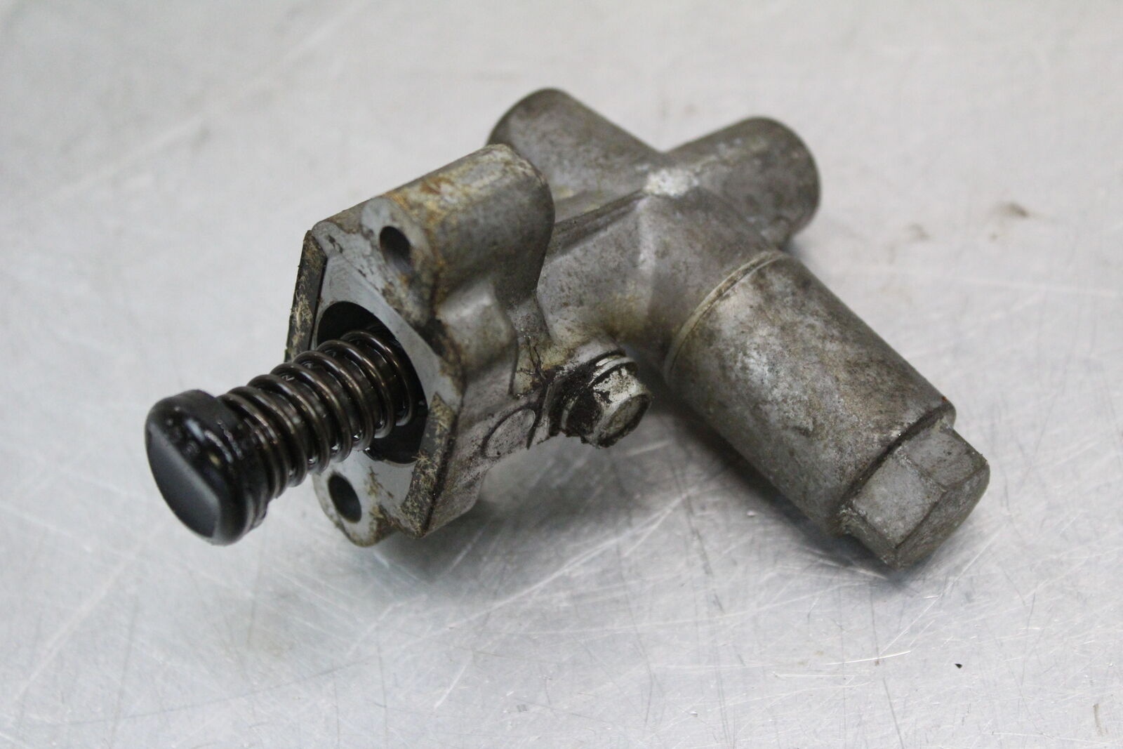

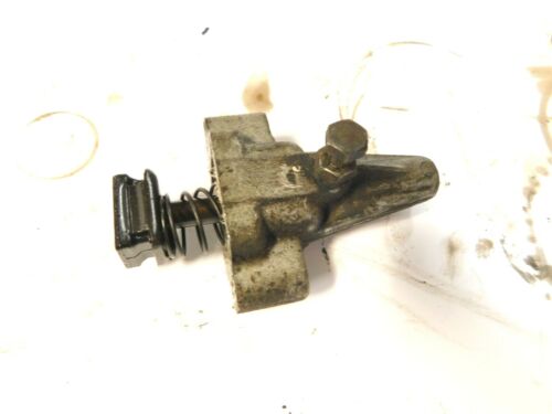

Hi guys,
i am currently considering fitting an oem style manual cam tensioner instead of the automatic one on my GPZ750.
The automatic one is of the round end style, and the oem manual one I have on hand is from a kz650 of the square end style.
My question is can the manual oem style one be used when it is with the square end?
Thanks!

In my personal opinion, the KZ650 tensioner is not really a manual, but more like semi-automatic. It has spring, and the bolt only controls the extension of the plunger and locks it. You do that by hand. In the fully automatic, the cross wedge to that, no "manual assist", and it is very reliable indeed. Actually, if you removed the stop little bolt on the GPZ750 stock cross wedge, and screw a longer one, it would do the same as the 650.
In a fully manual one (after market), you also have to do the job of the spring, and is a simple as it gets. (I use one of these, because makes top end maintenance/jobs a breeze)
Consider:
The reason for the shape of the plunger, and length, is the type of pressing guide on the chain. The KZ650 had a type of roller tensioner guide,..and sprockets all around, whereas the KZ750-4 uses strictly sliding composite guides, for tensioning and fixed....with very different shapes.
I can not answer directly your question, and probably nobody has done this because it looks like a step backward(to me). If reliability is your concern, then a fully manual would be a better safe direction, as you wouldn't have to worry about the differences on the cam chain guiding system which dictates the shape and length of the plunger......and setting it up manually, is actually fun.
