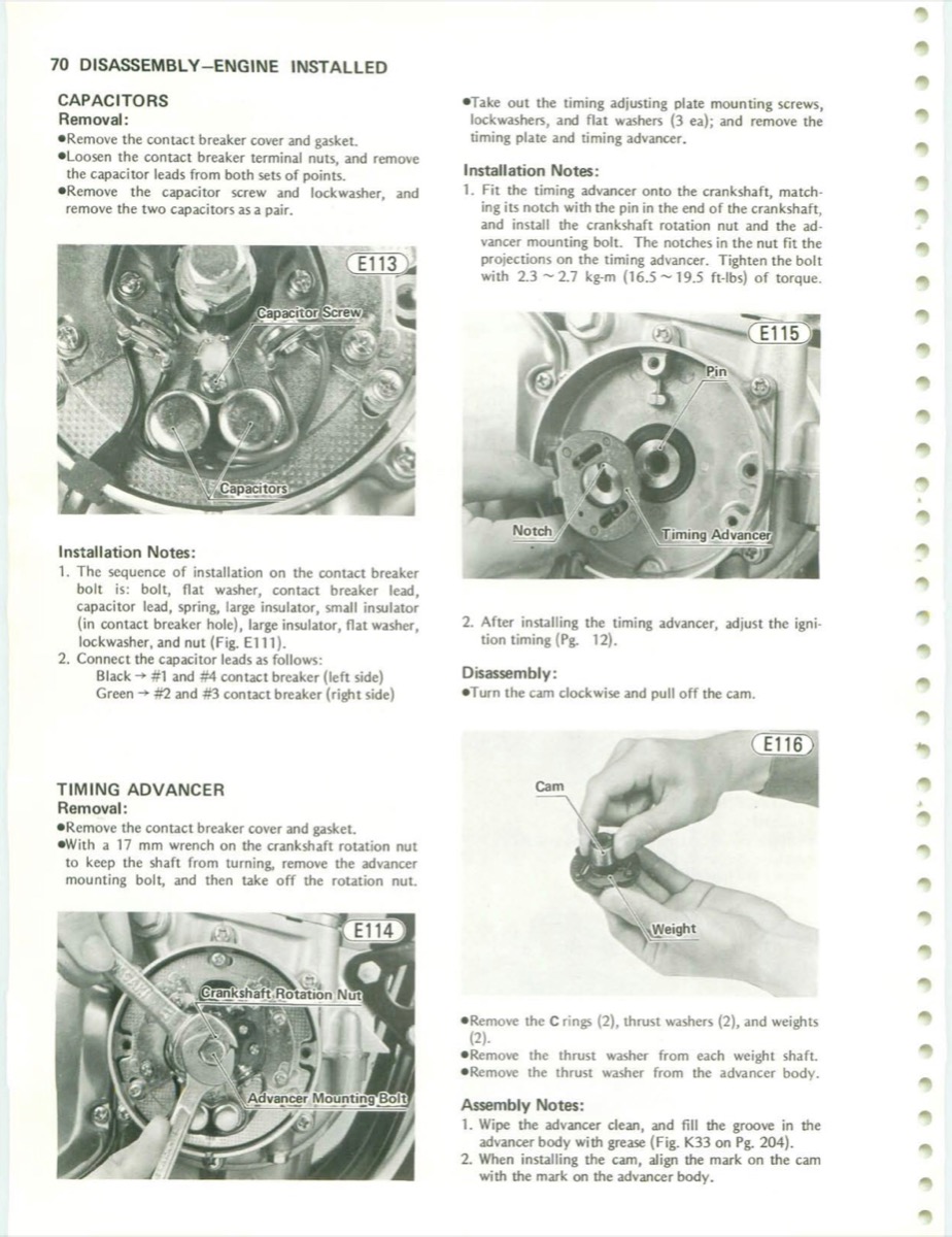

I'm going to try this again. How can I get he spark advance mech off my 81 kz650h?

Re: spark advance mech
24 Sep 2022 07:15
- ellwinger
- Posts: 19
24 Sep 2022 08:38
Thanks for the info. My manual doesn't show this. The bolt and nut look like they're one piece. I'm off now to give it a go.
24 Sep 2022 08:51
Some older model 650's had a lip around the base of the advancer where it bolted to the end of the crank. If there is a lot of rust its going to want to stick to the end of the crank even with the bolt removed. Spray with WD40 and let sit then gently tap it with a rubber/plastic mallet in a few places to see if that will loosen it.
24 Sep 2022 23:51
hold the BIG nut still and turn the small on or you will brake something
