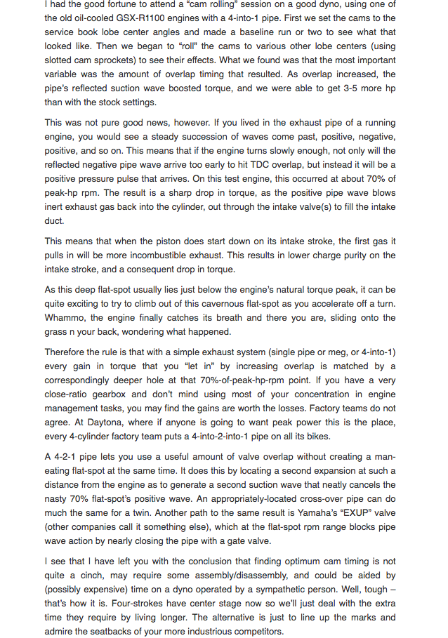

The trick is....what does the horsepower curve look like with the pipe?
You may gain 7hp but if you have flat spot immediately before or after 7hp gain then the 7hp could be more of a problem.
You should also make sure your pipe diameter matches up to the exhaust port in order to keep your reflected waves in the right place. Any change in diameter in the exhaust pipe creates a negative or positive pressure wave heading back towards the engine.
Bigger isn't necessarily better. It has to be bigger or smaller in the right places.
vintagebikemagazine.com/technical-articl...the-meaning-of-life/
excerpt-vintage bike magazine-Kevin Cameron
