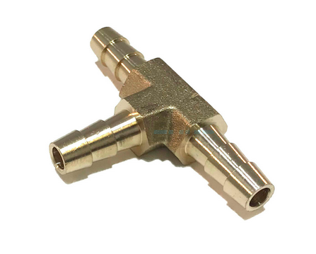

05 Sep 2022 06:34Can't you use a single outlet with a "Y" piece (singles flow enough for a KZ1000) ?A few questions.

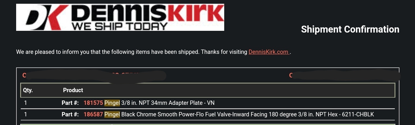

Yes I was just researching that, but felt adding the Y might make things look not so neat on the bike. I may instead use one of these since the original petcock as a port that goes to the center of the bike. I can turn it so its suitable
Now I just have to figure out which Pingel fits the KZ750 thread.

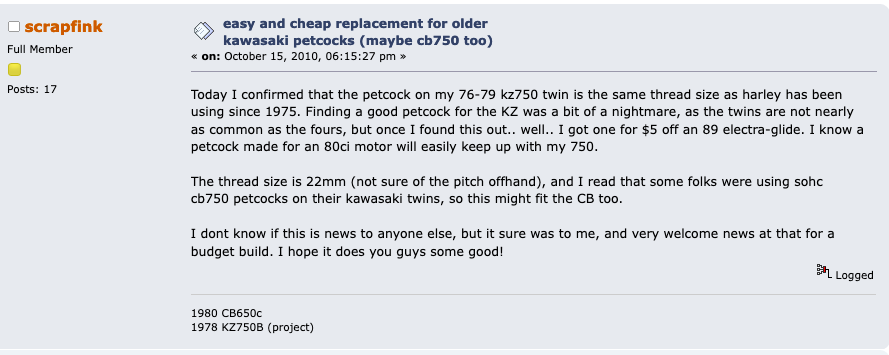

Thanks. I just found out that Harley Petcocks fit on KZ750 Twins. See here - an old post from a different forum, but which still may be useful for all.

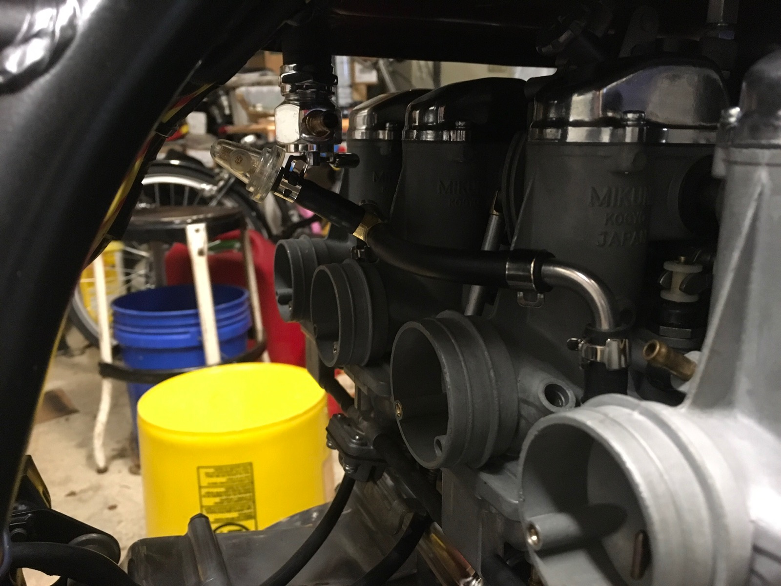

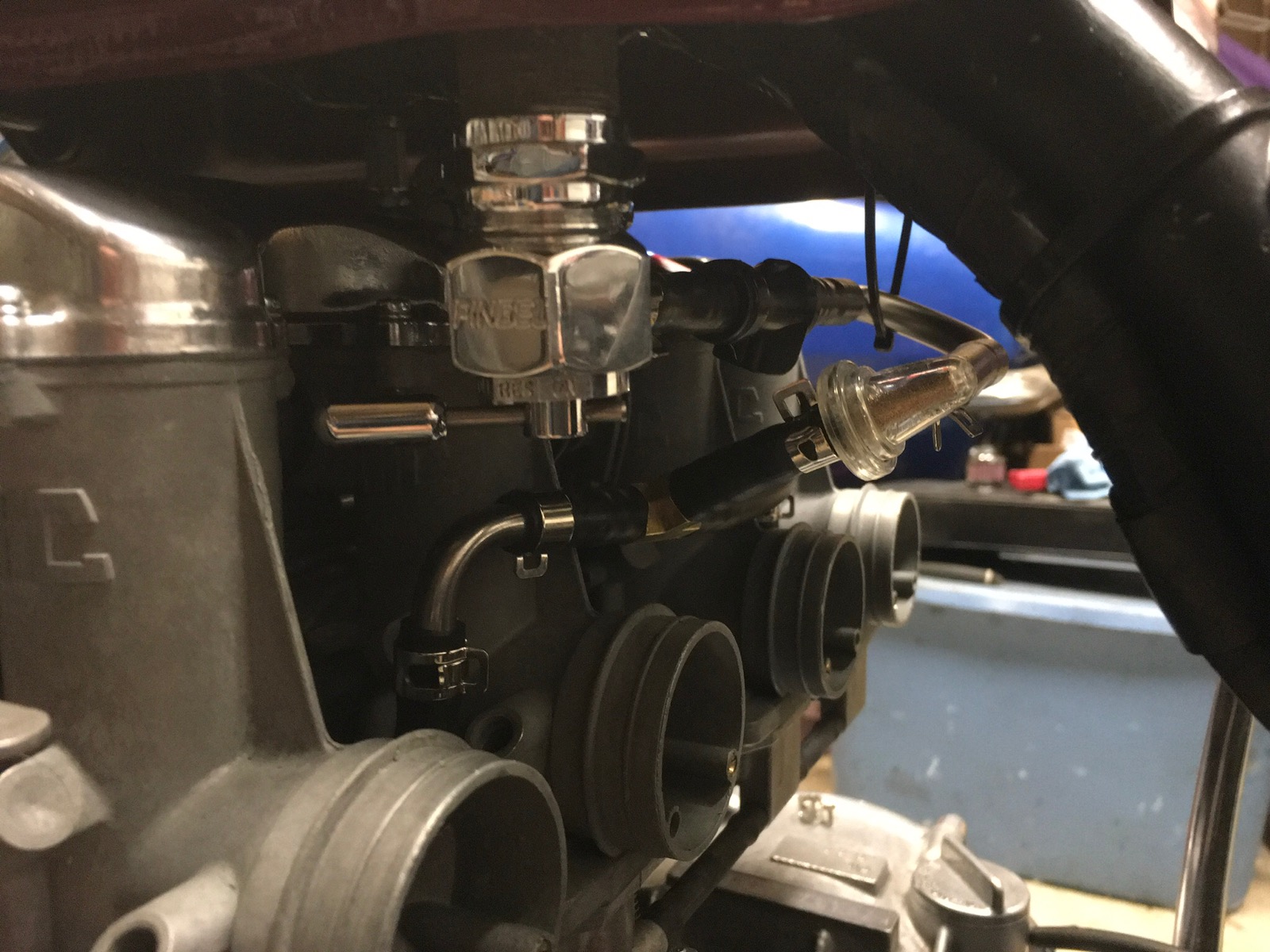

Buy it and never look back. Smooth operation. I love mine. I took a lead from 650ed and used 5/16 stainless beverage fittings. Single outlet to dual carb feed.
