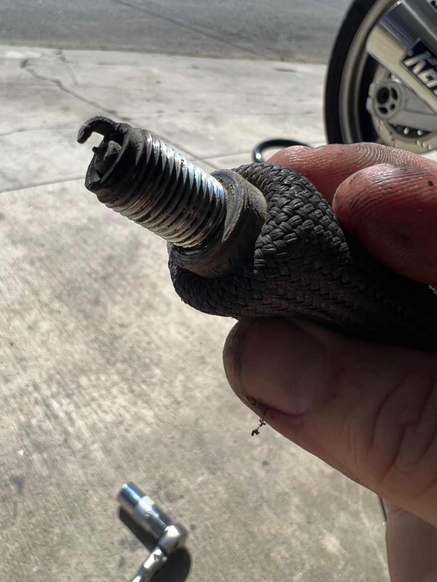

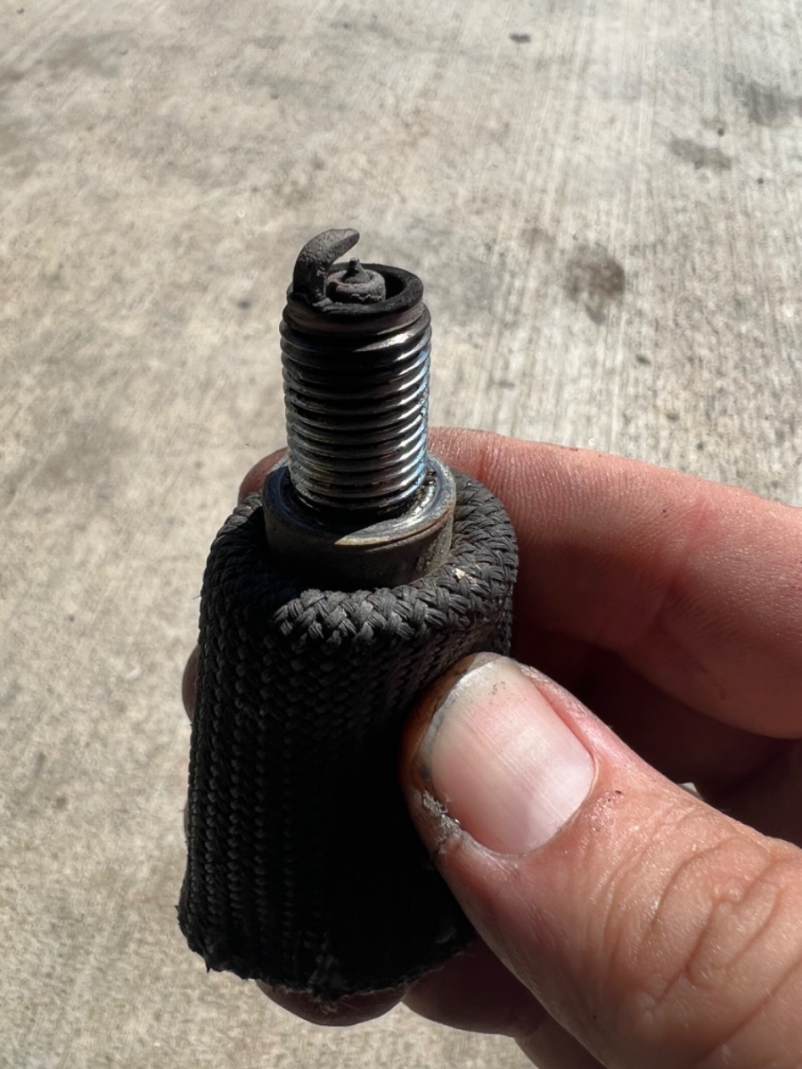

What do these spark plugs say to you?
  • Zaddict
  • Zaddict's Avatar Topic Author
  • Enjoying my Zaddiction!
  • Posts: 348
  • Thanks: 78
20 Aug 2022 10:34
#872540
They’re iridium plugs. Prob haven’t checked them in 10K miles. Some carbon deposits. Running rich?

Plug range to cold, over rich mixture, short ride not getting up to temp, large gap. Factory plug is a D8eA, I’d try factory NGK plugs.

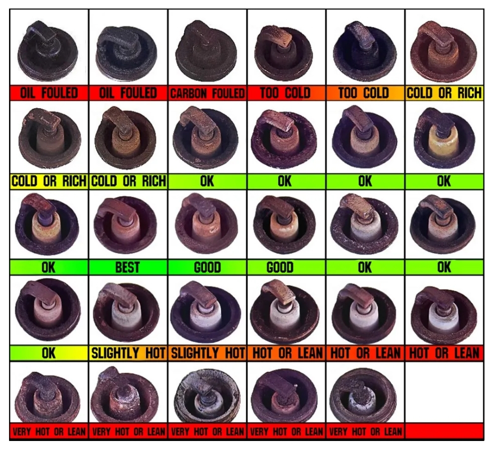

Top row,  second from right
