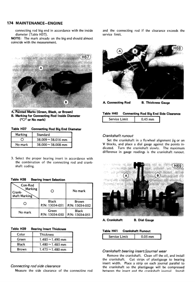

Gday Rusty, yeah, no problem drilling out the bearings if I have to. It seems that the bearings without the squirter holes have different colours and part numbers, now I have to workout which one correspond to the part numbers I have, because I just looked at the link Ojisan rider posted above and the part numbers and colours are different to what's in the Kawasaki workshop manual I have for the 1982 GPZ 750R1....
I need 8 black Kawasaki pn 13034-051 and 2 green Kawasaki pn13034-050. I want the 2 extra greens as 2 of my crank bearing journals measure right at the transition for the next size bearing, just to be safe..

I believe as long as you use the connecting rod and crank “0” or “no mark” decision tree, that will lead you to the standard bearing shell color codes you need. (Which is what I believe you have done)
As Kawasaki didn’t make special cranks for the gpz, so it stands to reason they used the same journal measurements and markings. (I know for certain that Kawasaki used the piston squirter rods in other models for a time, but the oiling passage was not drilled out. So those would have used standard bearings shells.)
Fit them up in the rod, torque the caps on, drill the oil hole, chamfer the hole in the bearing surface then bolt them up.

Hi rusty, yeah, I did the mark,no mark thing then used a dial gauge to the journals, so The measurements and part numbers are good. I'm having no trouble getting the mains,just the rod bearings are a problem. I may have found some in the UK but they're bloody expensive. Thanks for your help...

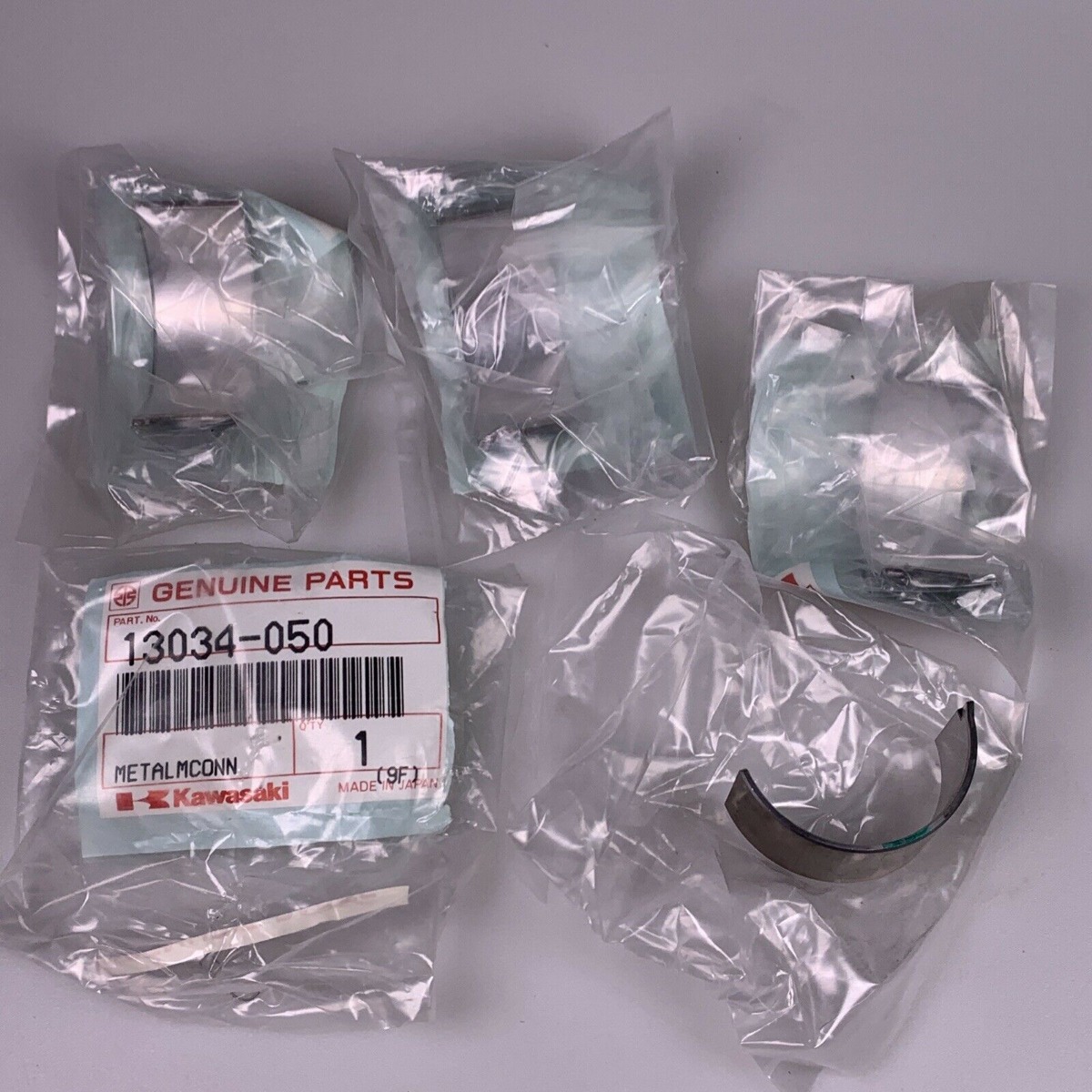

- Posts: 4420
- Thanks: 2268
Re: 1982 GPZ750 rod bearings
20 Aug 2022 18:16 - 20 Aug 2022 18:20
Last edit: 20 Aug 2022 18:20 by Scirocco.
- 750 R1
- Posts: 1162
- Thanks: 388
21 Aug 2022 01:47
Thanks Scirocco, I found 6 blacks in the UK and snapped them up so I'm only chasing 2 blacks now, 50 Euro shipping for those ones in the link..!!
