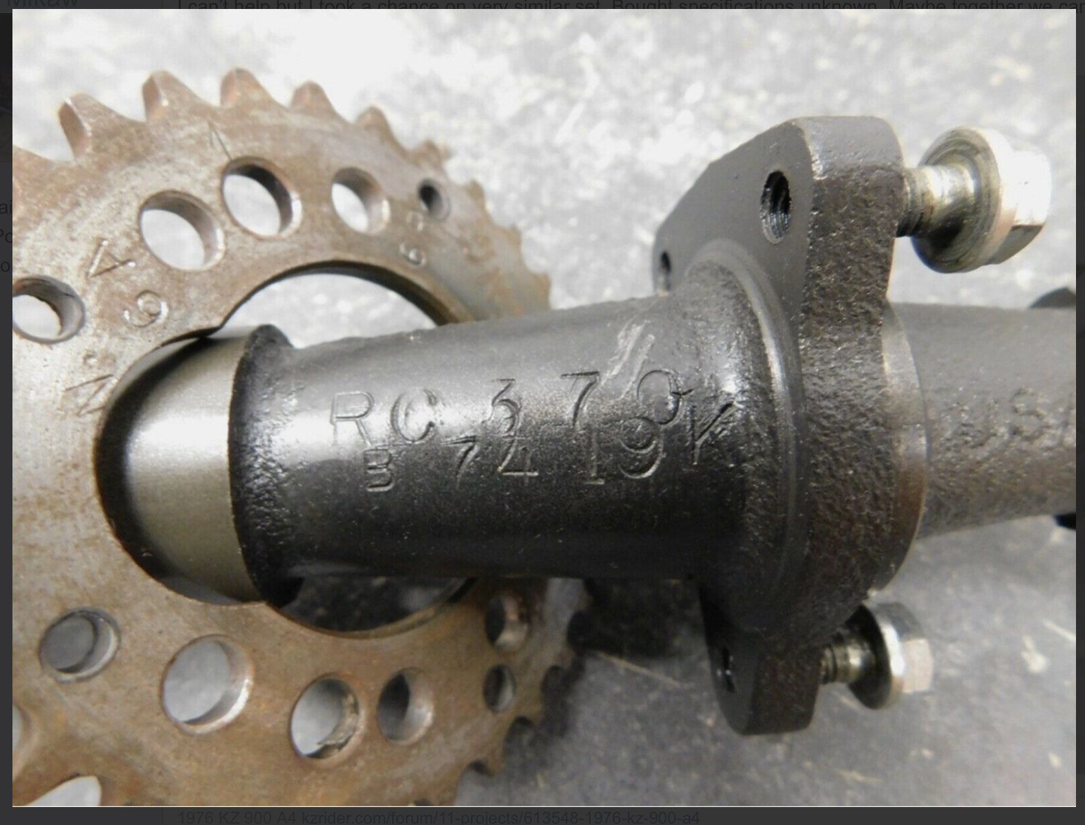

As Zed mentioned, Russ Collins cams will be stamped near the gear flange. For example the RC370 set I bought.

Right, thank you. I did take my glasses with me and check the cams again
So there is number RC388 stamped on the cam. And seems to be some string 116C87 stamped on the cam as well...
