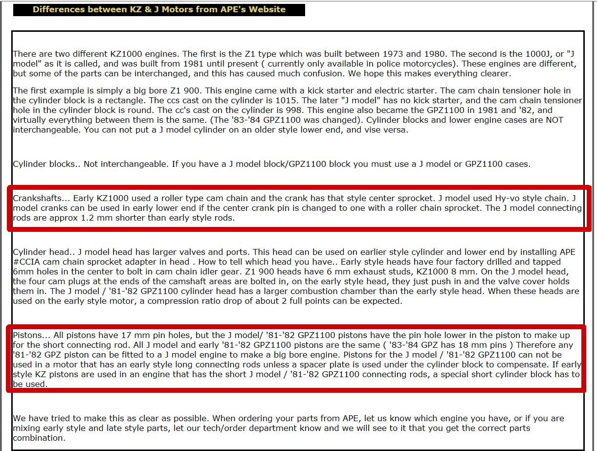

I seem to have an extra old z1 bottom end, and 81 model B1 head (the one with injectors on head) . If I try to use this head with old bottom end, I guess I got to use some other pistons than z1 ones? I do have a 17 mm pin, so which models have a suitable pistons for this setup? Sorry for my lousy English....

The B head will bolt straight on the early bottom end and will take the early 3 bolt cams or later GPZ 2 bolt cams with adaptor sprockets.
You will need a top idler conversion (APE) for use with the roller type camchain and remove the slipper guide from the cam cover.
The B's 4 cc larger combustion chambers will also drop the compression by an average 2 points so 10 to 1 would become 8 to 1 and unless you want to run a turbo will need either higher compression pistons to compensate or skim the head by approx 1.3mm.
The valve angles of the B head are the same as the early motors so no special pistons needed.

Thank you, Guys. There's many things now to think about. My first impression is that I'll try to find on old kind of head and do some porting for that. The B head has huge intakes which made me interested about that solution at the first place, but I'd come quite expensive as well since I should find some J model pistons and built a spacer under the block. Many things to think, still

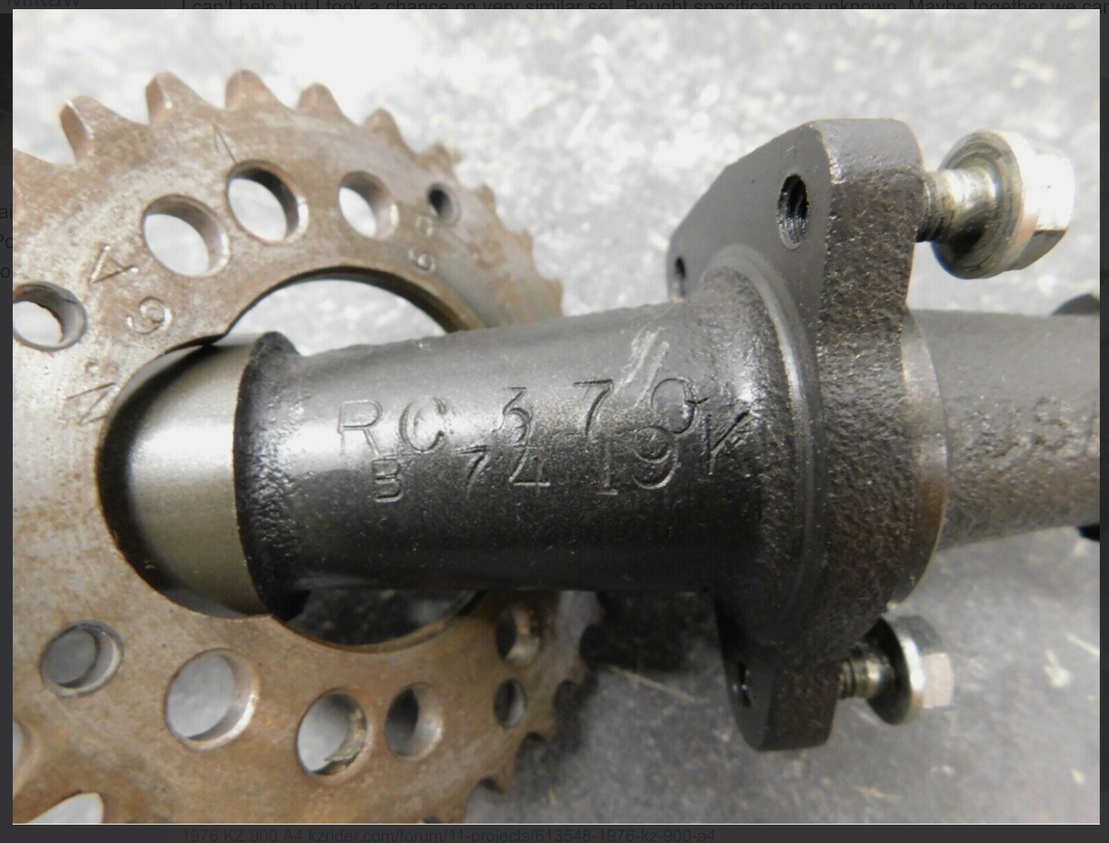

I got a set of aftermarket cams, but I do not know anything about them. I was told they're made by Russ Collins, but I do not really know about that. Anyway, there is stamped number K259 and CWC I-5 C-2 D2 on them. I guess 259 cannot be the degrees? Would that be quite "mild" duration? The lift looks to be much higher compared to stock ones...
And then I did find another set of cams with three stripes... I think I've seen these cams specs in somewhere, but cannot found them now. These are from some kz from eighties?

As Zed mentioned, Russ Collins cams will be stamped near the gear flange. For example the RC370 set I bought.

Right, thank you. I did take my glasses with me and check the cams again
So there is number RC388 stamped on the cam. And seems to be some string 116C87 stamped on the cam as well...
I tried to google those a bit, and I noticed that this K259 string can be found from very many US made cams. So is it so that there is (or has been) some manufacturer who has made all the "raw" cams for different manufacturers? Like RC, Andrews, and so on?
How about those three stripe Kawasaki cams? Any idea about those ones?

Yes! Many of the cam blanks are bought from the same foundry hence the K259 etc to denote the fitment and then the "buyer" puts their own grind on them..
Here's some info on the RC388 cams lifted straight from another thread.
A high-lift "Hot Street" class cam that provides a marked increase in acceleration and torgue. Ideal for the street class racer who wants more power without the radical characteristics of a full race cam.
Total duration: 298 degree's
Lobe centers 108 degree's
Lift: .416" intake.......... .416" exhaust
Lash: .004 in........... .006 ex
