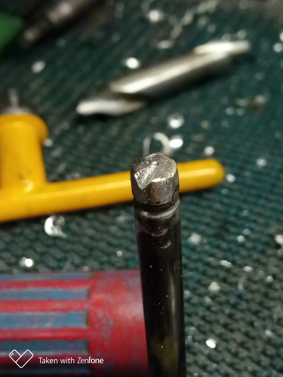

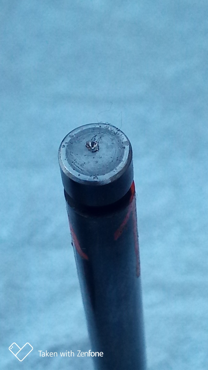

I guess what I'm saying
if I put an 81 gpz 750 ex and intake valve into an 83 gpz750 head , would it work? And is it a mater of needing .5mm more shim thickness?
I'm trying to avoid removing too much material off the top of the 84 gpz 750 valve stems ,pic shows how soft they became after removing ,5mm from the valve stem, again was forced to do so after sinking the seat beyond spec

Re: 84 gpz 750 cams in an 82 head and valve swap
16 Aug 2022 07:57 - 16 Aug 2022 10:31
*Edit* So are you asking if the 82 valves are shorter than the 83-84 valves??
I misunderstood the question. So the issue is you need shorter valves because the valve pockets are cut too deep, thus putting the valve stem height out of adjustment range.
If so, then no!
You will need new valve seats installed and recut to the correct setup height.
Yes, the intake and exhaust valves from 1981-1993 kz/gpz/zr750 motors are interchangeable.
In 83, on the gpz, they recessed the exhaust valve seat to “increase flow” which then required them to make the exhaust cam a small base circle in order to accommodate the difference in valve stem setup height. (I guess it was easier to make a different exhaust cam rather than millions of special shorter exhaust valves)
From what I noticed, any time Kawasaki used a different alloy, manufacturing process, vendor or part refinement, they would change the part number. Even if all the parts were functionally identical. Partzilla is a great resource as they update all the superseded part numbers that Kawasaki uses. So when they run out of a NOS part, they will offer the next compatible part # for that application.
When I had my 81 head redone, I had them cut the exhaust valve seats deeper in order to accommodate the 84 gpz cams I was going to use. That put the valve shim closer to the middle of the range. I didn’t want to find that I couldn’t find a shim that would make up the .5 mil gap.
If so, then no!
16 Aug 2022 19:34
Thanks for the clarification
did realize after that all the valves shared the same part number
