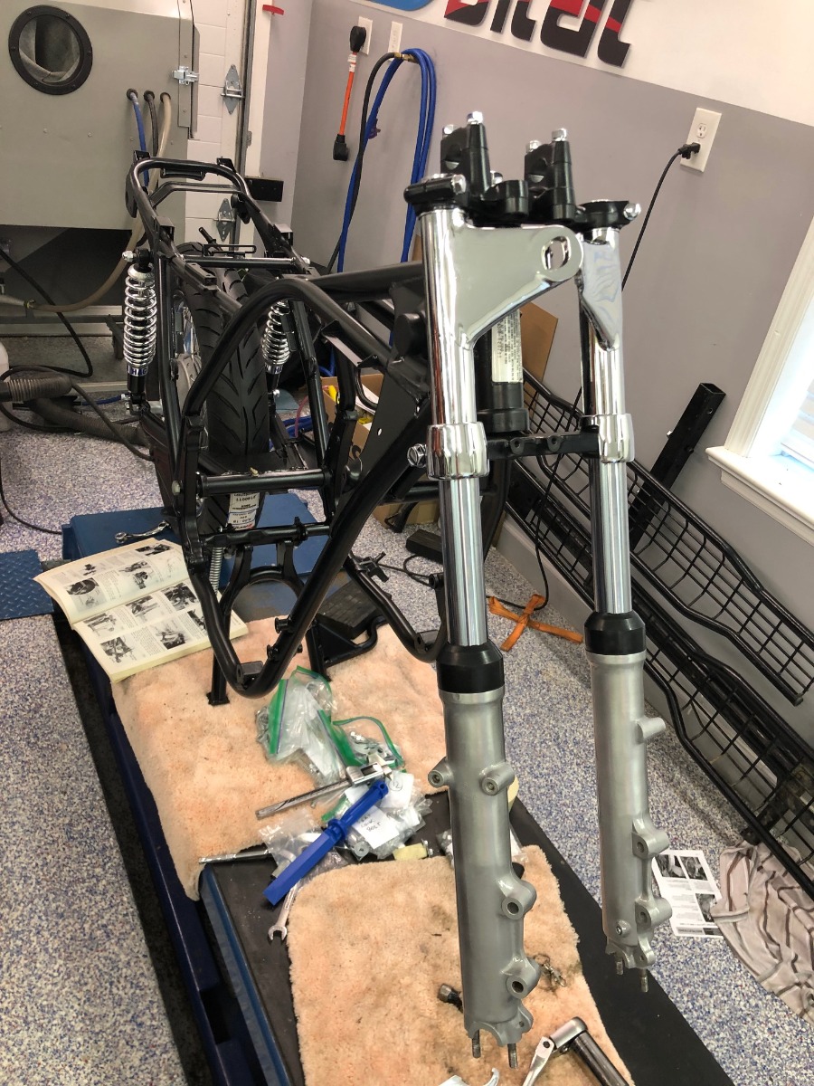

At what point it is best to install engine? Do I need help? What is the best way to do it to avoid scratches, etc. This is where I am at with chassis assembly:

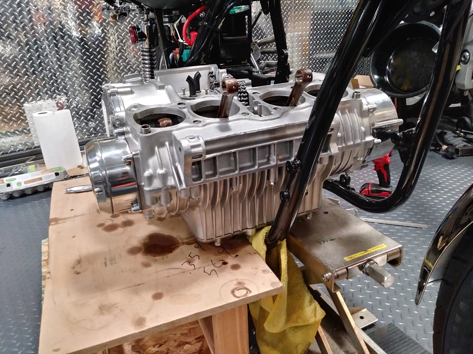

No eBay APP ID and/or Cert ID defined in Kunena configurationI install the trans first into the frame and then the cylinders and head. I first have the rear and front wheels on and and supported with the center stand. I build a platform about 1/2inch taller than the lower frame tube. The engine sits on this. make it big enough so the engine is stable. The platform sits next to the frame. I then use my scissor jack and slid it into the center of the frame to the same height as the platform. from there I can slide the engine over to the jack a little at time watching the front and back. The engine will slide easy and will not hit the lower tubes. I do this by myself. To make it easy I place the engine on the jack first which sits pretty low. I then jack it up to the height of the platform and slid the engine onto the platform and over to the frame. take your time and you will not damage your paint or powder coat.
By the way I don't have the filter in at this time I do that later so the bottom is flat and slide easy.

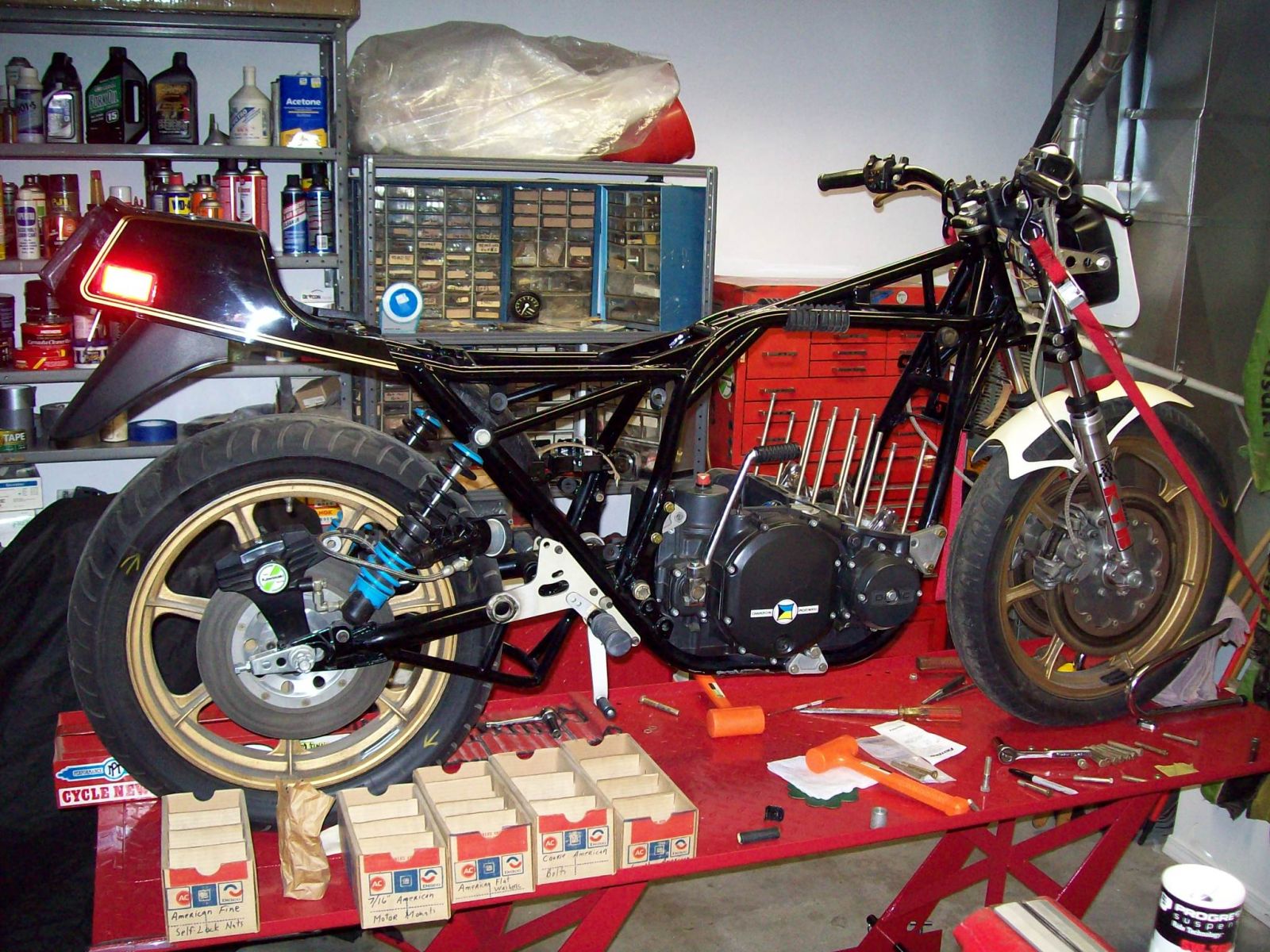

I start with a rolling chassis securely tied down to a lift. I don't want to try to place a motor in the frame with the chassis moving all over the place. I place rags over lower frame rails.
I have a completely assembled bottom end on the bench. When I am by myself I grab the dyno cover with one hand and with the other hand on the kickstarter. Then I lift the motor off the bench, then place the bottom end across the frame rails. With the bike up on a lift and the bottom end on top of the bench, I don't have to bend down with the bottom end to place it in the frame.
If you have the top end assembled on the motor it will take two people to place the motor in the frame!!!! Now that I am getting a little older (68 now) I like to have two people when I stick the bottom end into the frame. Been doing it this way since back around '72 or so!!!!!
