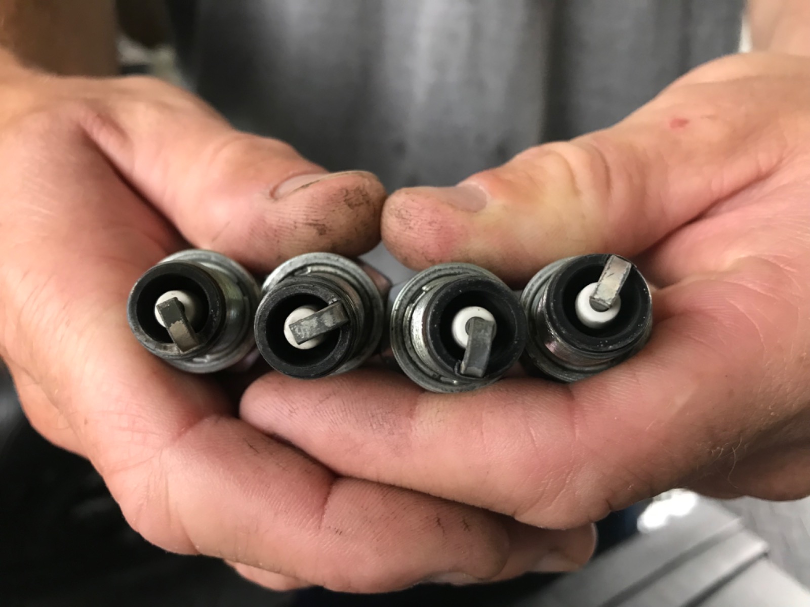

New kz750 engine. My air fuel gauge doesn’t work.. what are you thinking about my plug. I have running at 60mph for an hour.. 130 main jet, 2 needle of 0.5mm for my set up.
Kz750e 1980

So you think Im lean a bit or?! Do I need to ride more than 1 hour ?! 130 main jet, 2 shims under needles.. pod filters, small porting, 0.06 milled head, 0.5 oversize, 4-1 stock exhaust with open slip on

Rh plug in your picture is def lean.
But the plug colour will only tell you about the mixture at the revs just before you cut the engine.
Google plug chop.
"A plug chop is a method of testing your motorcycle's air/fuel mixture by reading the spark plug color after cutting the engine at various throttle positions. This allows you to identify which jets you'll need to change or adjust."

Thank you, so I will try 135 instead of 130. Is it dangerous to ride it like that for make my  break out of 5-600km ?
Engine has only run for 1h since his rebuilt

Running at 60mph is half throttle at the most. Your mains are not what is restricting fuel at that point. I would raise the needles.
A full speed plug chop would be good to check mains, but I don't know how you do that on a 750.
On my 305 its doable.

Thank you guys.. so if I shim the needles again.. I guess it will be rich from 1500 to 3500rpm.. because in this range I feel the engine is near of being top rich.. now with the 1mm raise is pretty limit to that range?! What are you thinking?! When I put more throttle to be in the 4000 to 6000 rpm Its sounds and feel amazing!!  I dont want to put it more for now.. just 100km to ride since the rebuilt!!!!

There’s something unusual about the coloring of the earth strap. Did you brush them?

No I make 100km in total and at the end constant speed at 60mph..

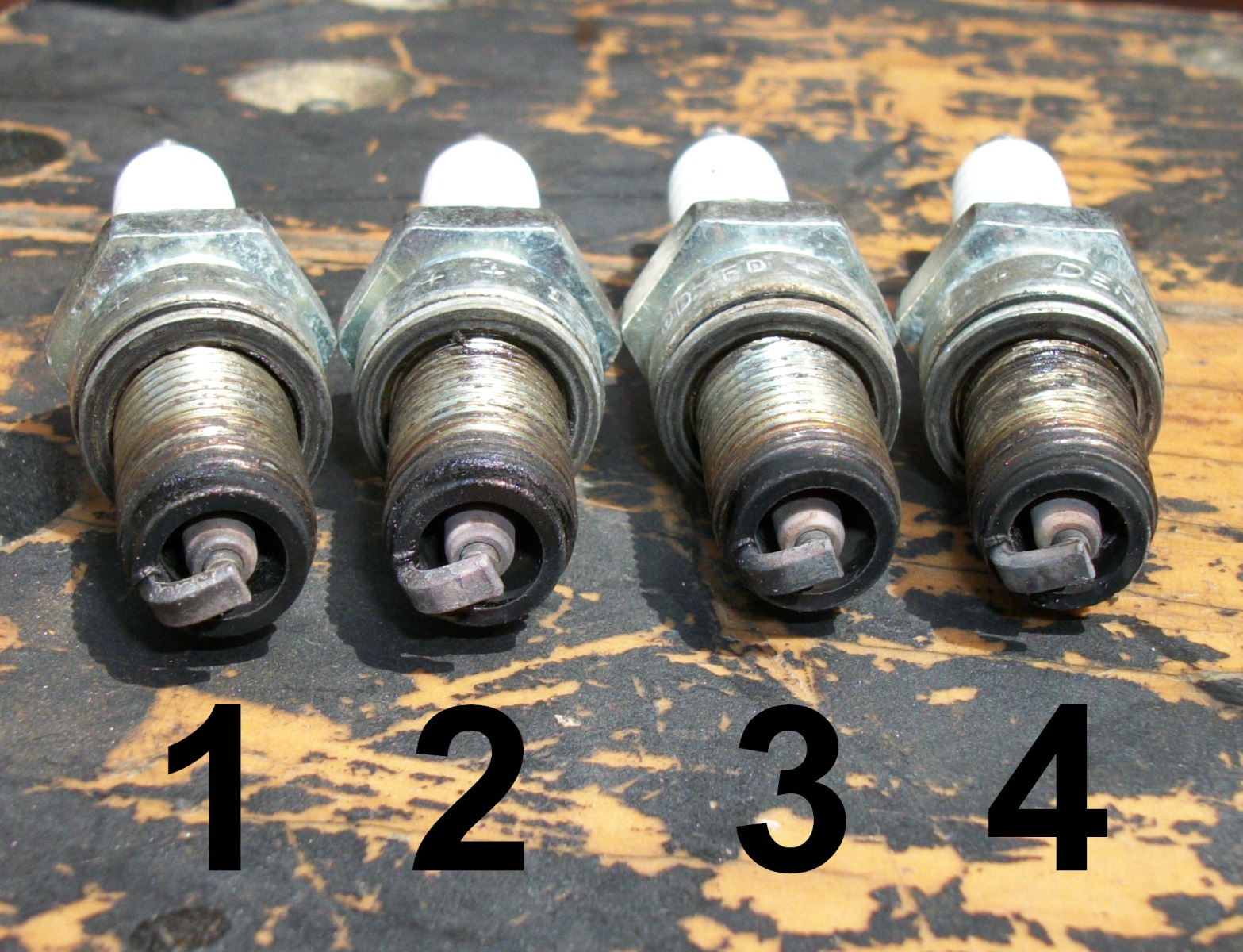

Best way to check low, med, and full throttle is a dyno run.
here are my plugs with mixtures OK
