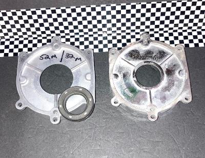

Hello, looking for the outer diameter on the ignition side for a Kawasaki GPZ 1100 crank. Where it would go into the seal in the ignition housing side cover.

sane as "J" model

The crankcase seal is SC32487Translated this means 32mm ID, 48mm OD, 7mm thick

Thanks Ness, I have this cover I did not make. Was not sure? Was bored for a drive belt? Or larger crank on the Z1/KZ cases.
I.D. is like 32 so must be for the big crank!
Thanks. What I was looking for.
