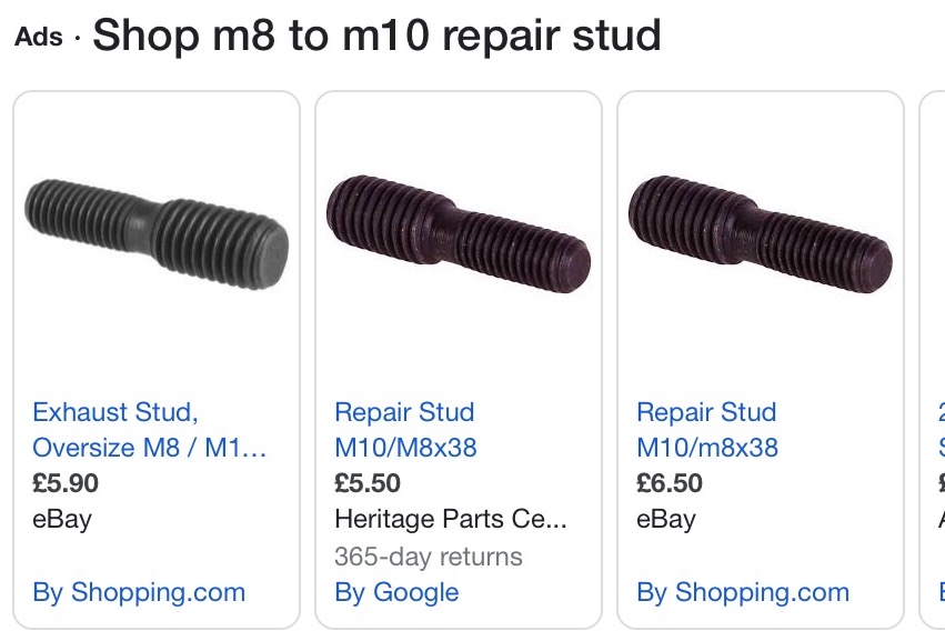

Should be fine with good drill bits (exhaust studs tend to be very hard due to the heat cycling) If it all goes horribly wrong there is always these to get you out of trouble

I drilled out a lot of broken fasteners working on the end of the assembly line for 30+ years. New folks on the line from time to time and figuring out how to use air tools (some for the first time) meant I got plenty of practice! As has already been mentioned, the most critical part of the process is center punching the broken piece dead center and drilling the pilot hole straight. If there was a threaded hole in the piece I was working on that ran parallel to the broken fastener I would use a bolt or screw as a guide to stay straight.(in this case the neighboring exhaust stud) I also had the advantage of using a small air drill and a new bit for each attempt. You do not want to break off a drill bit, that's when the project turns to Poo! Drilling a broken exhaust stud out while the cylinder head is on the bike will be challenging! Those repair studs are cool Wookie!
