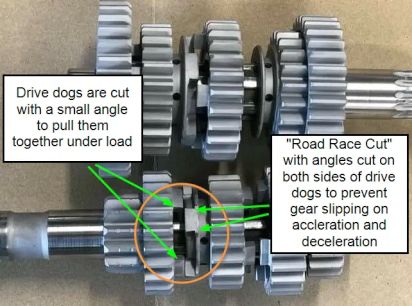

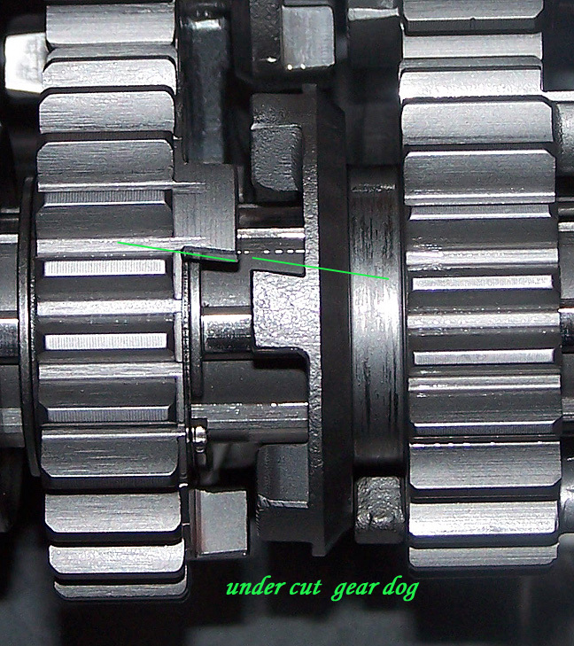

What do you mean when you say undercut? I have a close ratio tranny that I pulled from a Z1. It's in good shape.
Re: Undercut Z1 transmission
07 Jul 2022 14:55 - 07 Jul 2022 15:53The dogs on the gears get a 5 degree single side undercut to stay engage under hard acceleration (Drag race) or both sides for racing (acceleration and deceleration).What do you mean when you say undercut? I have a close ratio tranny that I pulled from a Z1. It's in good shape.
www.kawatriple.com/tips/undercut/undercut.htm
