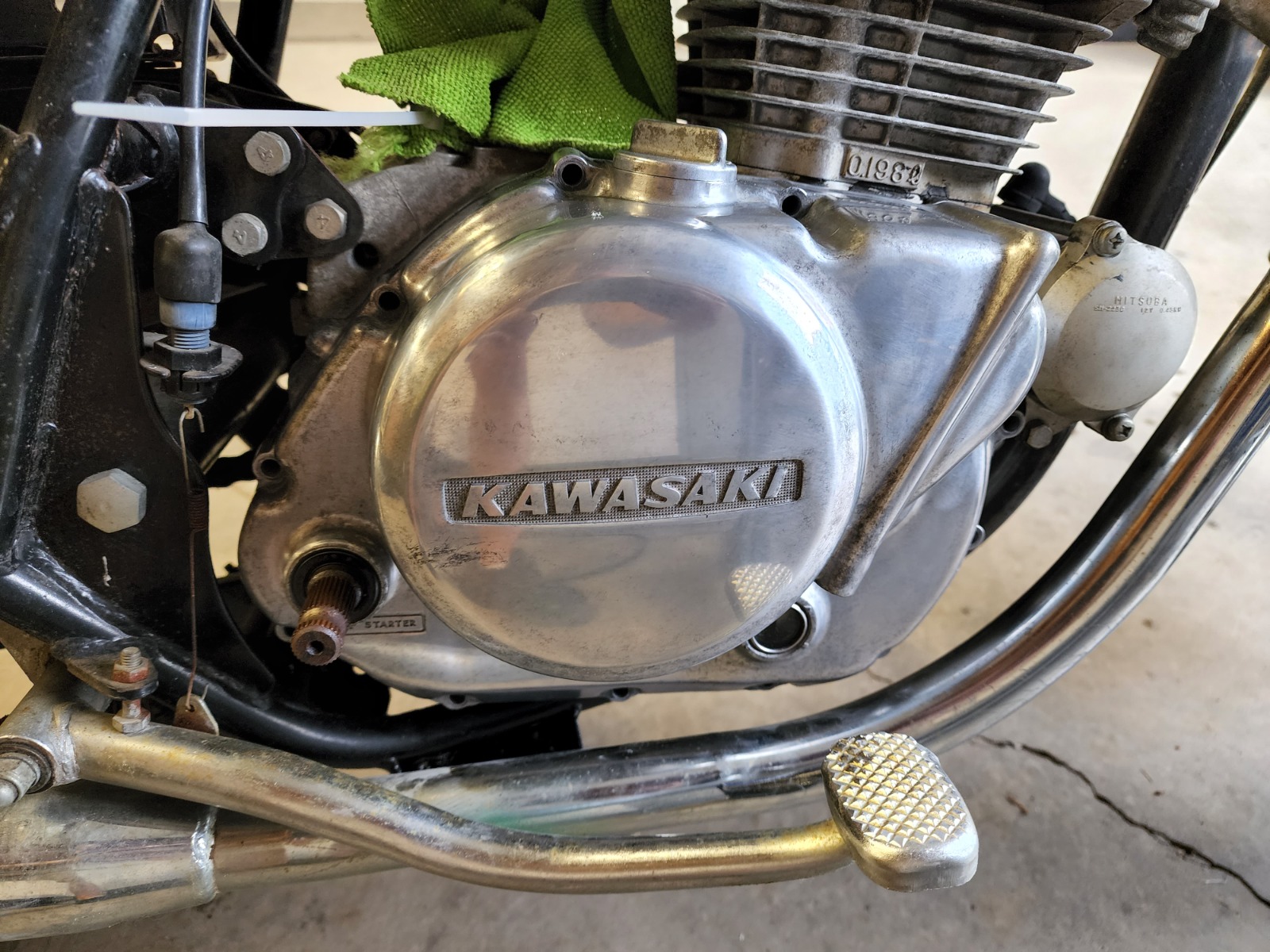

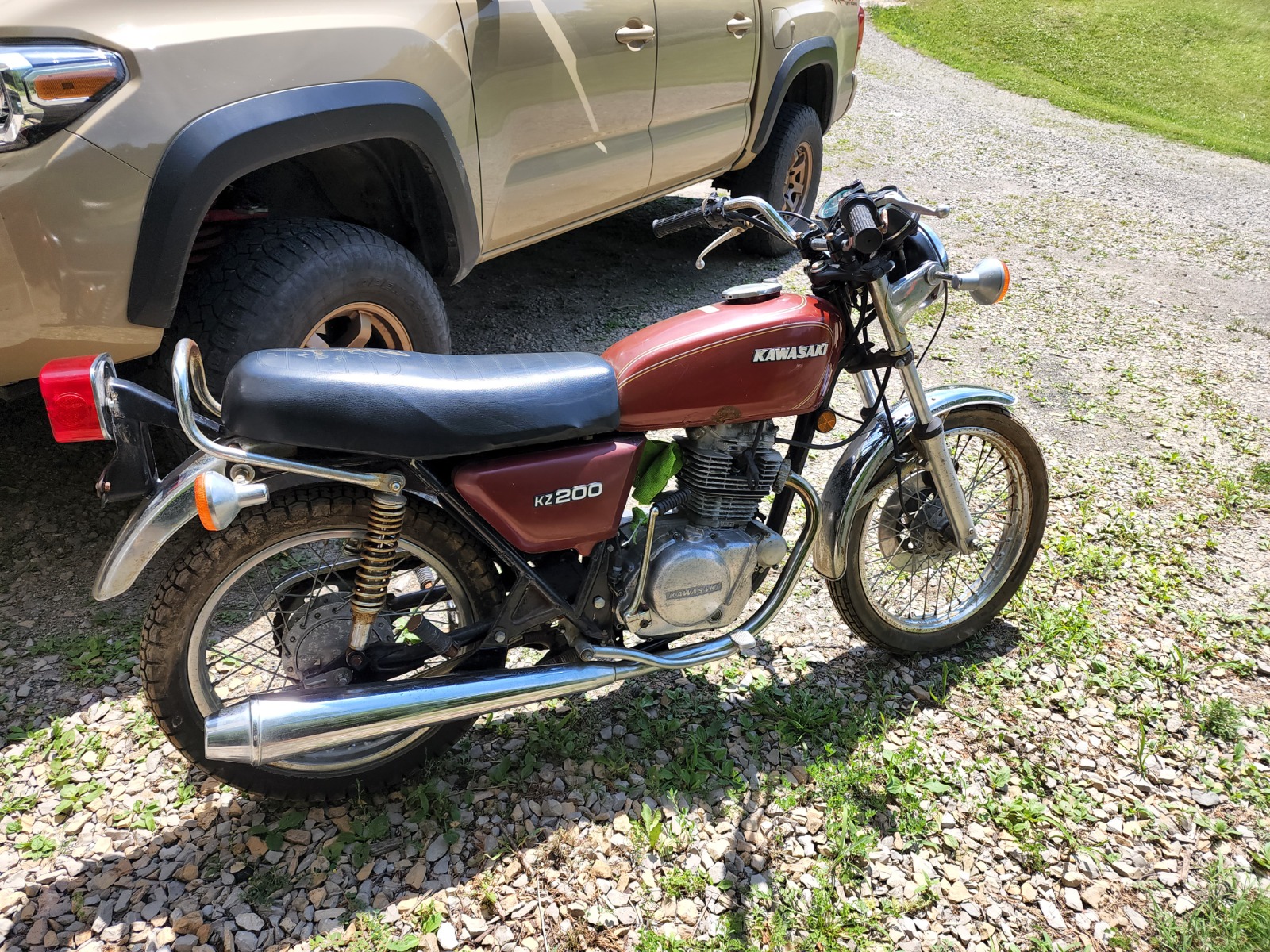

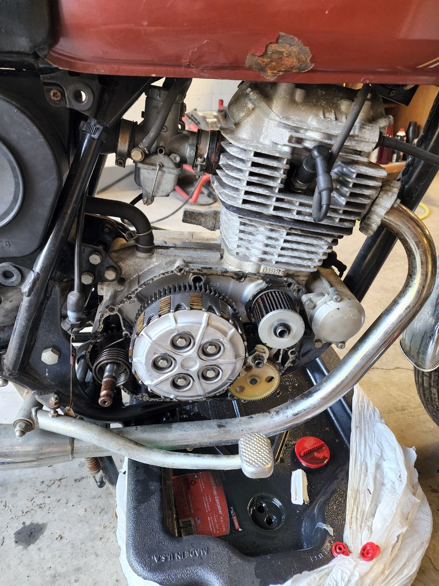

This is the best photo I have at the moment. Since this point, I have changed oil, rebuilt the carb, polished the engine side covers (somewhat poorly), discovered I have a bad ignition coil (I think). All other electrical systems work, engine seems to have good compression, the inside of the engine was immaculate. Put in new gaskets on the engine side covers as well.

Great little project, after 40 years of not running I would recommend a full strip, clean and inspect of the engine. Seals will have hardened and the rings are probably shot, with such low mileage everything else will probably be ok with a clean and lube.

Oddly enough the rings must be a-okay because compression test reveals about 150 psi. As for oil seals, that may be the case yeah, although I will probably try to do that over the winter. yesterday I took my maiden voyage after 6 weeks of work on the bike. Finally runs well, still ironing out some likely carb issues as it did cut out once but otherwise it runs well.
