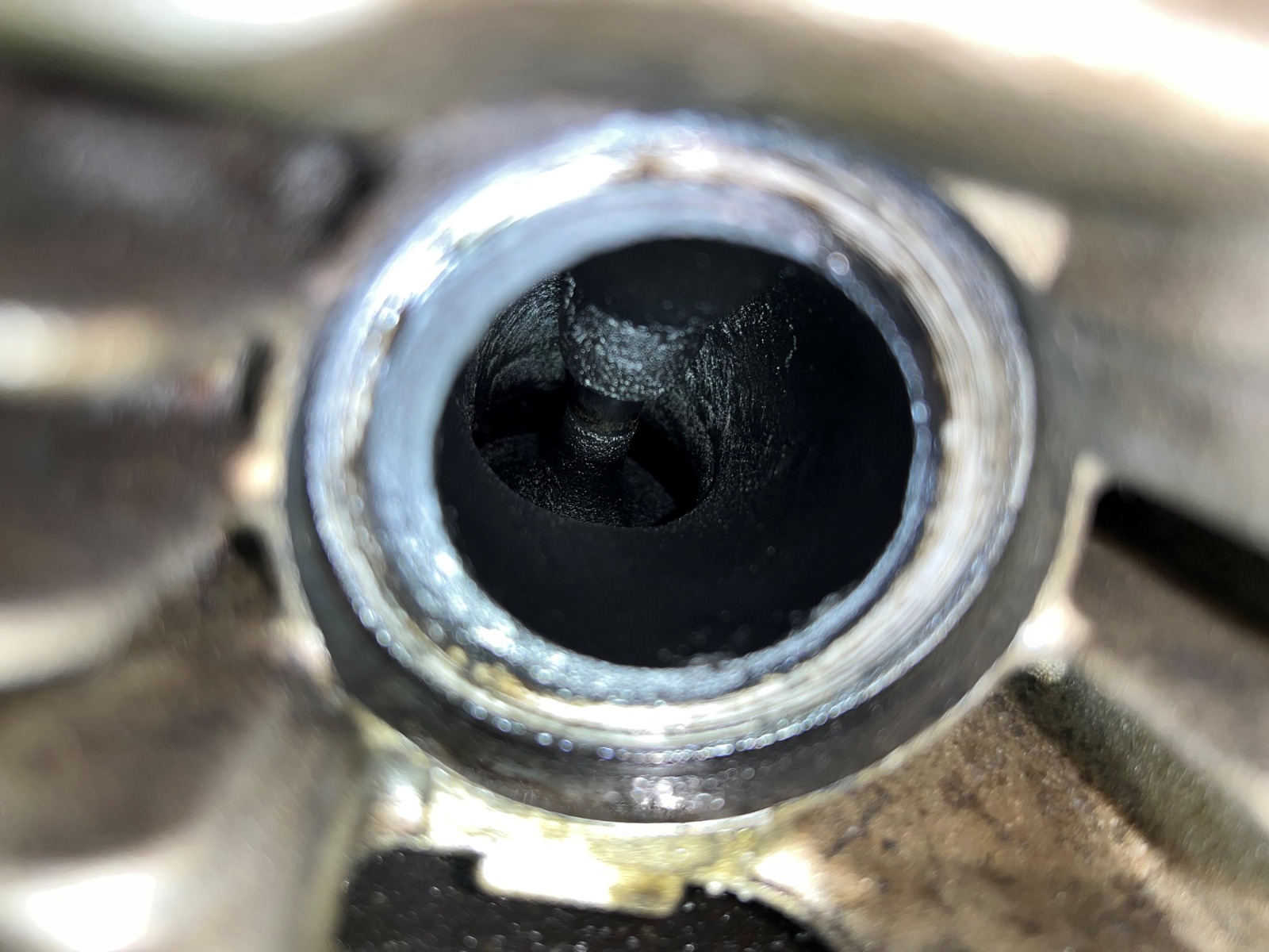

If it's been ok and regularly ridden then the likely suspect is a stem seal which is the easiest to diagnose and oil in the exhaust would indicate an exhaust valve seal as oil from a leaking inlet generally get burnt first.
Let the bike sit overnight and pull the exhaust headers.
If the exhaust stem seal is leaking it will be obvious as the valve head and stem will be wet and you will see where oil is getting past the guide.

I took zed1015's suggestion and took off the headers this afternoon. the header for #4 was very oily and had lots of carbon deposits when compared to the others however it did not seem wet as I would have expected it to after sitting for nearly 24hrs. I included a photo as well
Another odd aspect is it only seems to start smoking and spitting oil after riding for 5 or 10 minutes.
After doing that I ran a dry compression test and all the cylinders were within about 20% of each other although the highest I got was 100psi which is slightly concerning but I won't worry about that for now. I don't have access to compressed air for a leak-down test but I feel as that may be the next option to troubleshoot.
