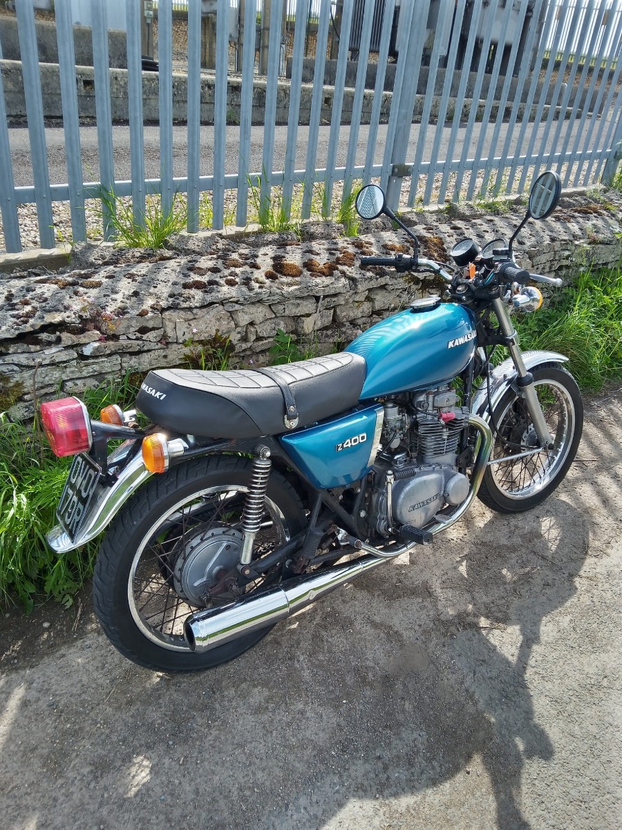

Any ideas on what may be wrong with my 1976 KZ400?
18 Jun 2022 06:03Hello knowledgeable folks of KZrider.
I have been trying and failing to get my KZ to ride nicely, and I am hoping for some pointers.
It starts easily, but idles slightly erratically, though this doesn't bother me too much. When accelerating it stutters as if it is running out of fuel- this is infuriating! It starts stuttering around 4000 RPM, and if you push through to around 7000 it stops.

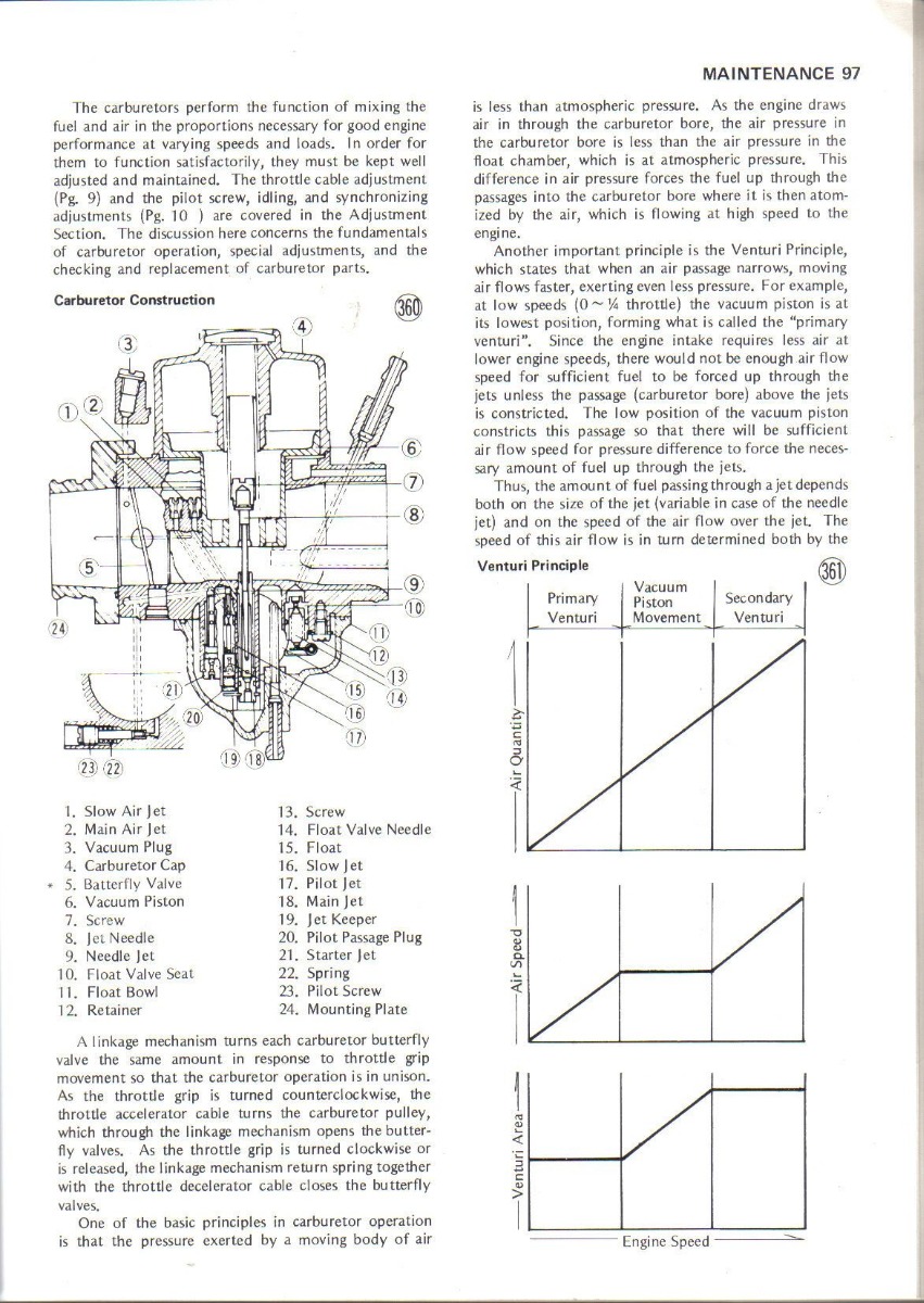

If the engine, intake and exhaust are stock, the stock jetting will work brilliantly. What you describe is commonly caused by clogged circuits in the carburetors. To truly clean them, they need to be COMPLETELY disassembled and soaked in carburetor cleaner. An ultrasonic tank helps, too. Then, each jet and tiny passageway needs to be carefully inspected to insure they are spotless. For the pilot circuit, a steel e-string from a guitar works really well. It is a good idea to then take a can of carburetor cleaner with its spray straw installed, and spray in every passageway to insure there are no blockages. Be sure to wear safety goggles or a face shield as carburetor cleaner will hurt or even seriously damage your eyes.

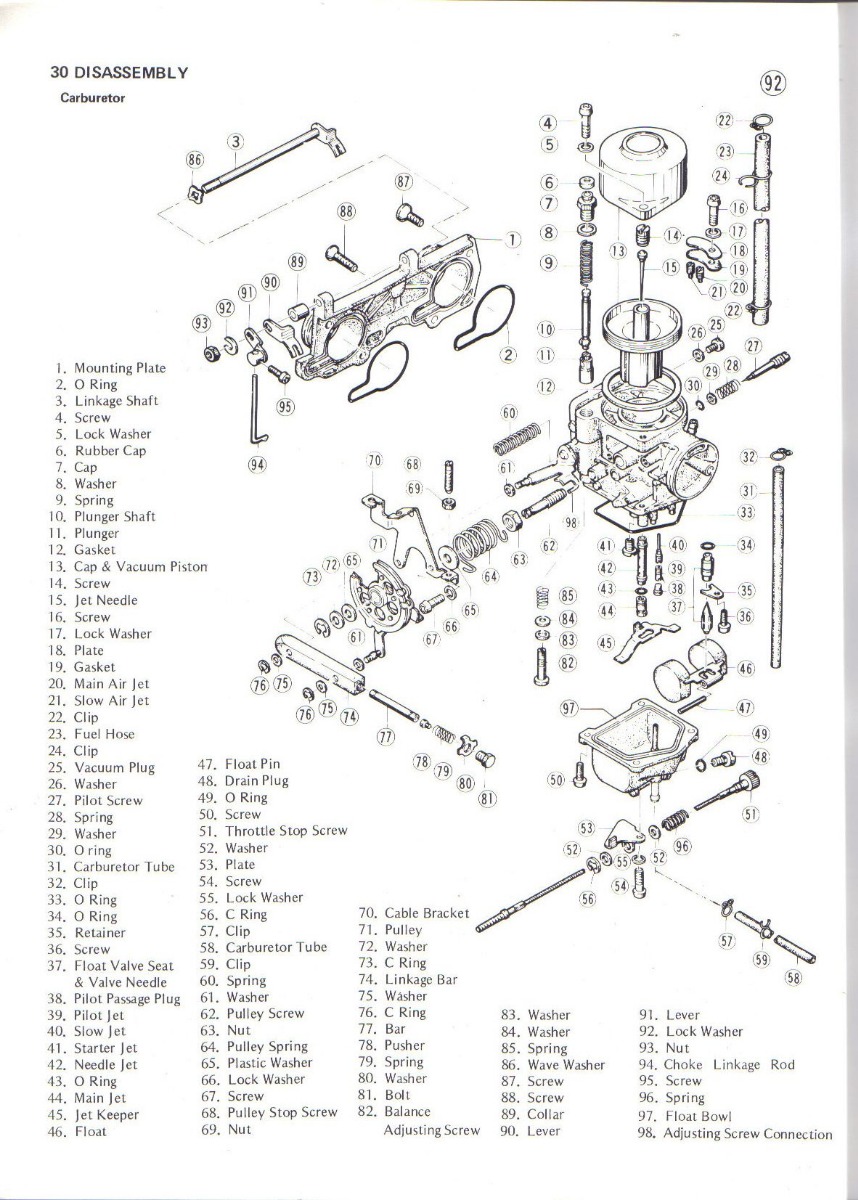

Also, the pilot screws on your carburetors are supposed to have an o-ring on them. If the o-rings are damaged, hard, or missing, you may never get the carbs adjusted. See reference numbers 19-22 in the diagram. Also pay close attention to the order they must be installed in.
www.partzilla.com/catalog/kawasaki/motor...ts-kz400-d3-76-77-kz

Thank you to all who commented, and directed me back inside the carbs.
After taking the carbs back apart and really cleaning them I noticed the O rings on the main jets weren't sealing (43 on the diagram Scirocco helpfully posted).
Replaced the Os and the bike is now in fine fettle.
