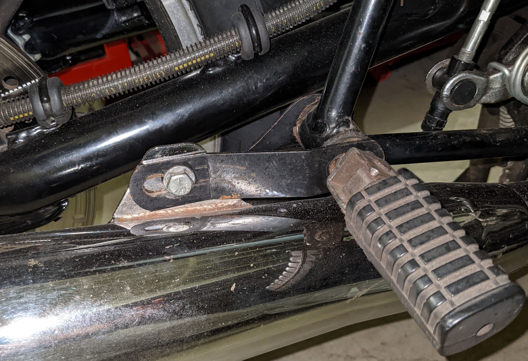

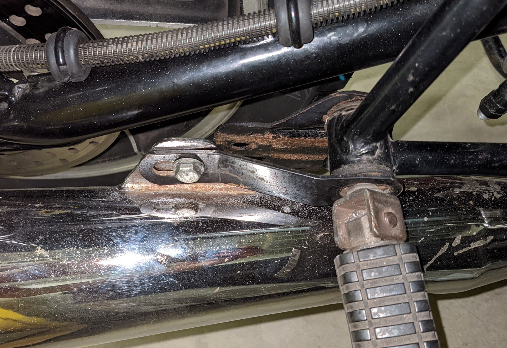

My bike came with a 4 into 1, but I can't seem to find anywhere to mount the exhaust tab to. Does it just strap to the lower swing arm? The join to the header also has no clamp, so I found a t clamp that works. I'm guessing I've lost whatever was there. It's the last piece before she is ready to ride.

yup thats a fair amount of smart arse for a dumb question. I was looking at other bikes and trying to figure out how it wasnt moving. duh..... ok i need to make a bracket to go from the back of the passenger peg to the mounting tab. The tab is in a stupid place for this bike. not sure how that came to be....

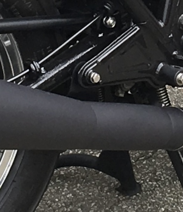

Your muffler looks similar to the one on my KZ1000, made by MAC. Mine is mounted with a sheet metal bar/bracket that reaches from the passenger peg mount to the tab on the muffler.
The MAC kits came with a number of different brackets like this for different models.
I have made similar brackets from steel stock purchased from Home Depot. Cut to length with hack saw, add some bends in a vise, and drill both ends. If you're feeling fancy, round the ends with a file or a bench grinder. Hit it with some black spray paint and you're done.

Funny you say that because that us exactly what I'm currently trying. That picture helps. It's hard to figure what height it wants to be at or how tightly inserted. I tapped it in with a mallet and block but then I was thinking I'm risking messing up the header. I'm also going to put some muffler cement and a clamp around the join as it's..... sloppy ish

20 Jun 2022 20:48
It's so timely. I found a good mount and got the exhaust all tightened up and then noticed the center stand was riding on the chain, well vice versa i guess. Dug out a spare parts bin plate that you mentioned. With the aftermarket exhaust I'll have to chop the bracket and use in conjunction with the bar I bent up to hang the exhaust but you nailed it sir, cheers
