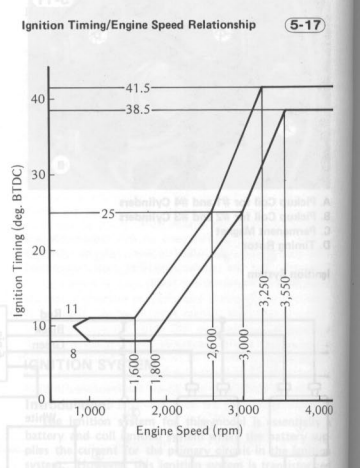

16 Jun 2022 13:26 - 16 Jun 2022 13:48Exactly. the factory is even aware of this and 3 degree swing is in their acceptable margin of error in ignition timing. Once you establish TDC for the cams. its easy to reset the ignition timing and if you like scribe a mark on the advancer to true TDC - thats what i did. advancing the timing just 2 degrees made the engine a little snappier for me. Ive actually wondered why Dyna doesn't get rid of the advancer entirely and control advance via electronics like some other ignition systems do.It's the marks on the ATD (ADVANCER) in relation to the crankcase that can be off.Something else to consider: while you are re-timing the cams check that the factory ignition TDC mark is accurate. I have found 2 degrees retarded for the TDC mark on the factory advancer. Not much, but it made a noticeable difference once I corrected to actual TDC.
The stock ignition was removed for a Dynatek 2000 in 2013.
I'm not aware of similar accuracy issues with the Dyna system, but good to double check.
This would affect any ignition regardless of quality that retained those components.
For degreeing the cams though you would establish true TDC via the degree disc and piston stops and done correctly the timing would be accurate no matter whether the factory T mark lined up on the cases exactly or not.
this is the stock iginition curve for KZ1000J/K/M not sure what model you have
Last edit: 16 Jun 2022 13:48 by DoctoRot.

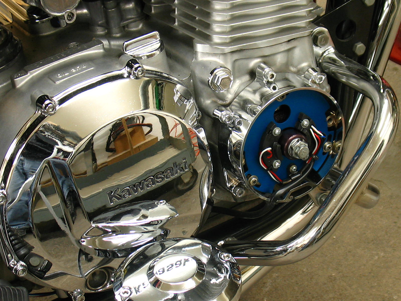

The Dyna 2000 advance is electronic, and it is adjustable at the ignition module. See Dynatek 2000 factory programmed curve graph found on page 10 of the link below:
www.randakks.com/documents/Dyna%20DDK1-5...2%20Instructions.pdf
