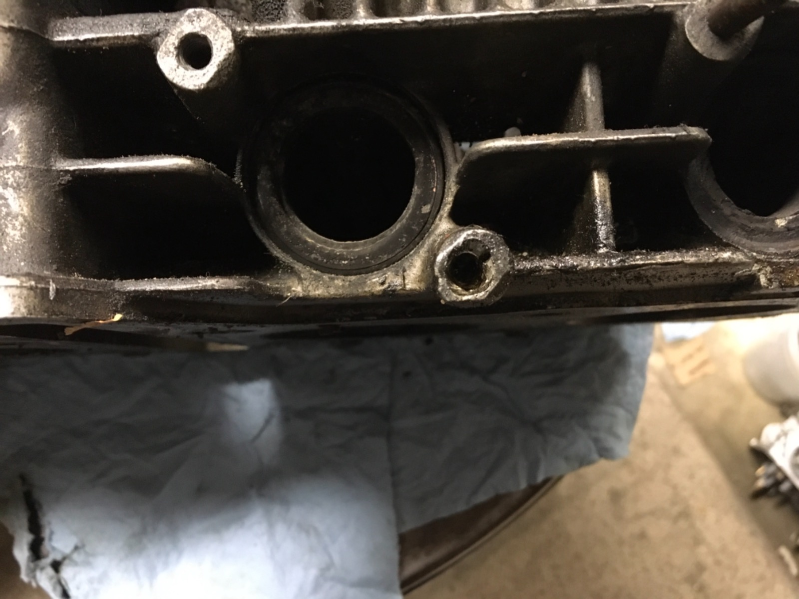

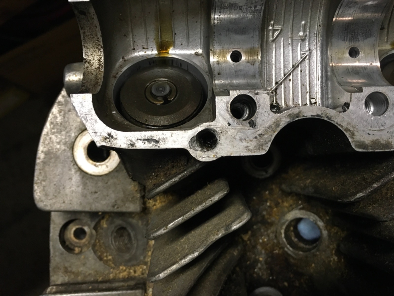

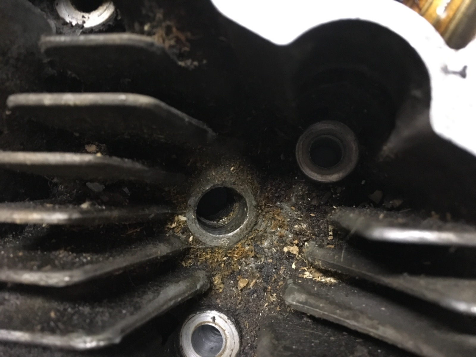

Stripped blown out spark plug hole. A miss drilled attempt to drill out an exhaust stud. And a similar ham fisted drilling attempt to remove a broken cam cover bolt. All the valves are installed so I don’t know the condition.

From the photos, it looks like some threaded inserts will save the day. I've seen worse butchery. You need to find a shop that knows their shit though. And sadly, that's not easy these days.
