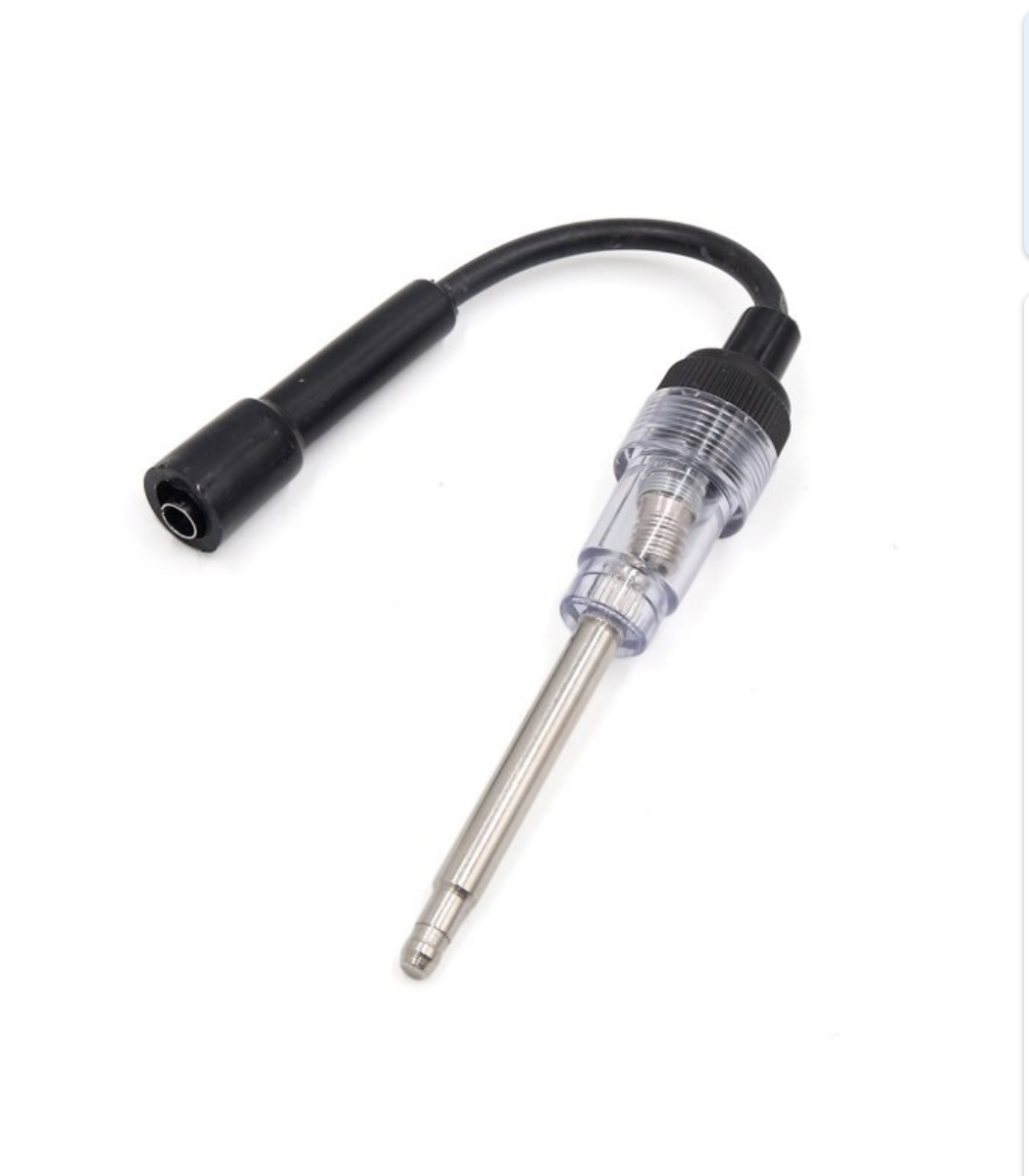

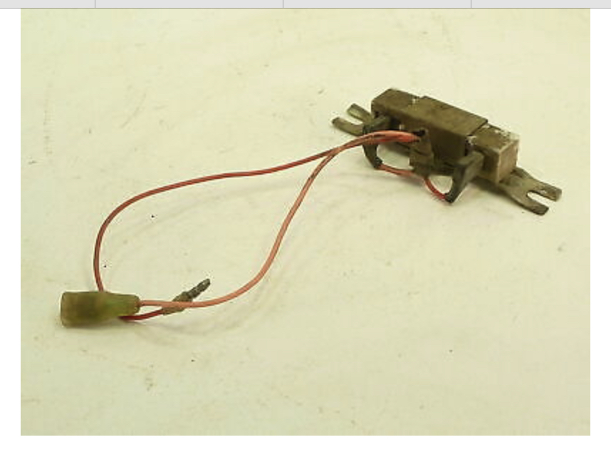

I’m with Tex here. Fuel starvation or loss of spark. Does it sputter and die, that would lean toward fuel. If it just dies it might be spark. Could be coils, but hard to say both coils would drop out at exactly the same time. If it’s not sputtering and dieting from fuel starvation then It could be power to coils through a bad connection that builds heat and stops flowing current. Stock ignition or newer electronic? There is a vent in the tank cap. Remove the 3 screws and ttake the cap apart and make sure the vent is clear. Take a rag and flat blade screwdriver with you on your next ride when it dies CAREFULLY place the rag under the float bowl and just crack it open and see if fuel drips out. I have never heard of anyone test riding with a spark tester in place but I guess it’s possible to do. Is it possible it’s a 1979 with a resistor in the coil power circuit?
