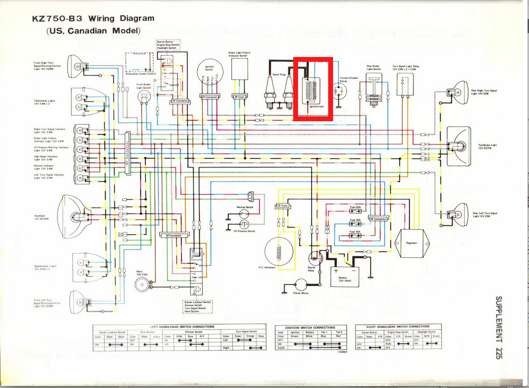

the black and yellow spade into the coil. On on of those wires is a thin metal "O" that looks like a bolt goes through it. Its loose with no bolt. Thats the best way I can describe it. Tomorrow I will take a pic of it.

Hmmmmm
I only see a red/yellow wire and a blue wire going to the coil.
The red/yellow is the 12v positive going into the coil
The blue wire goes to the points.
I'll wait for the photo tomorrow.
