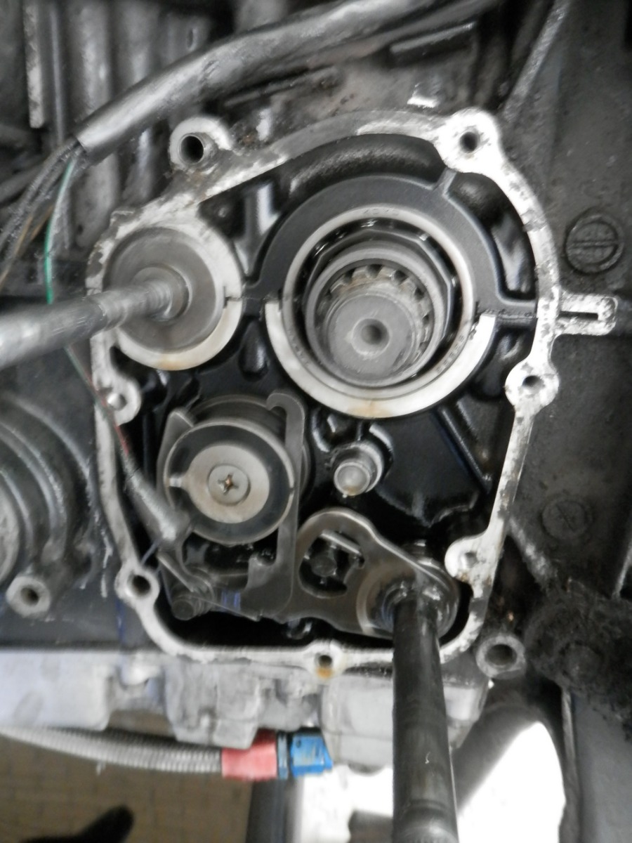

A few years back I had a rythmic regular clunk noticeable at about 50kph (30mph) and which I could feel at the left foot peg. I figured it was the chain but with bike on centre stand the chain slack was perfect. Then I realised that I had put newer rear shocks on the bike which were a bit longer than stock and sure enpugh when I examined slack with bike off the stand and both wheels on the ground there was a tight spot.
I also removed the transmission cover which is behind the front sprocket and had a good poke about to make sure everything was ok. I was worried the bearing might have been rubbished
