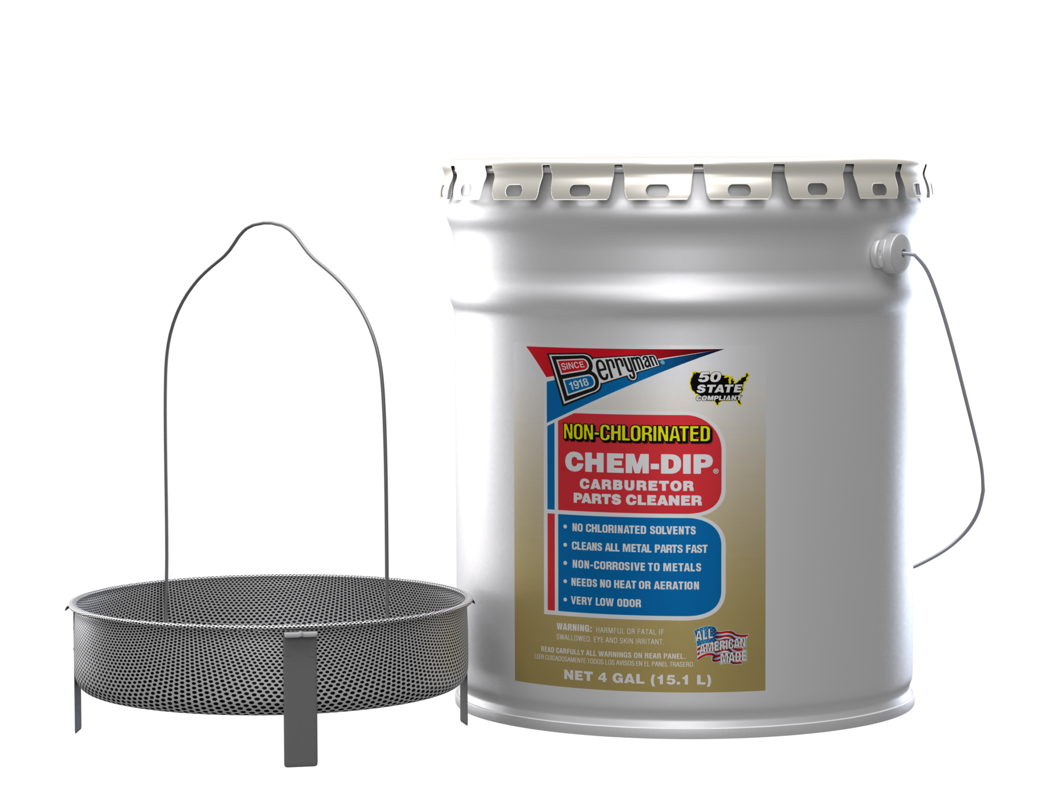

If you can figure out a way to keep them immersed in Barryman's for about 48 hours...?

In what??

Carburetor dip is what they meant by Berryman's.
I used a Dremel with a wire brush and it did a decent job - didn't seem to leave any marks, but I went light on the pressure.

13 May 2022 12:08 - 13 May 2022 12:09Berryman www.berrymanproducts.com/products/cleani...ional-parts-cleaner/Carburetor dip is what they meant by Berryman's.
