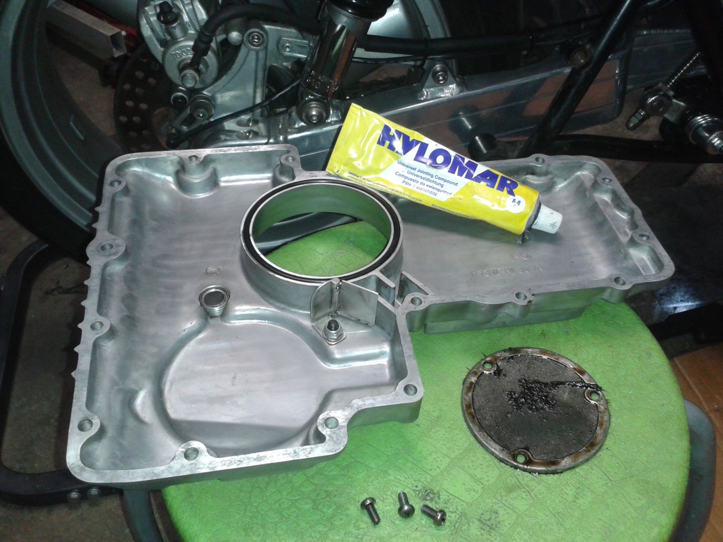

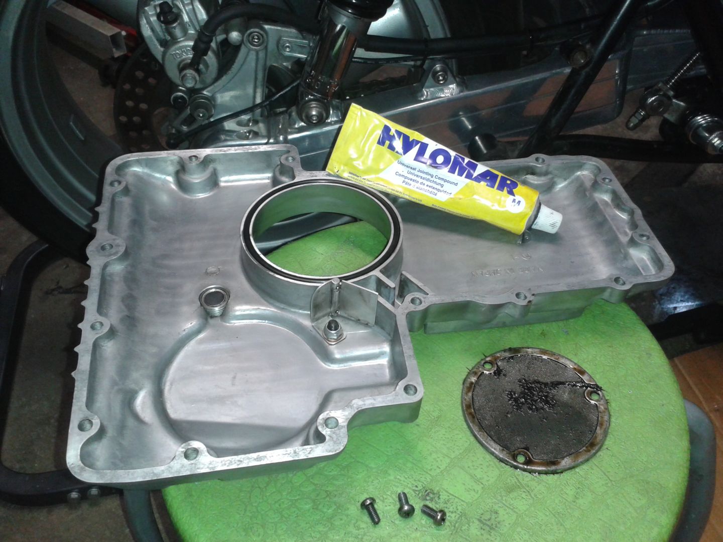

Re: Should I use gasket sealer?
13 May 2022 13:52
I use a very thin layer of HYLOMR M on engine case gaskets. It´s an easy on and off (fuel, break cleaner), permanent "soft" plastiline sealant other than silicon sealants.
