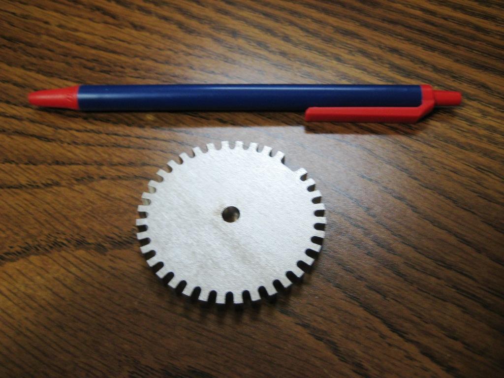

Why would you be adding a magnet on the points side? Most guys who want to run a DFI conversion use a missing tooth trigger wheel and a Hall sensor (no need for a magnet) If you were going to mount a hall sensor under the stock points cover it would be further isolated from heat by a "L" mounting bracket. Cherry brand hall sensors are rated to 260F.

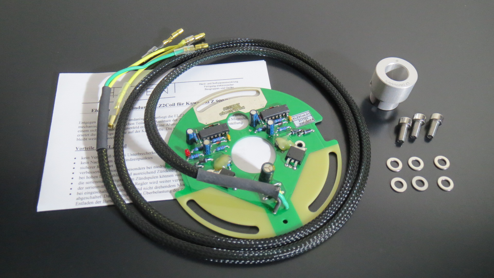

The Dyna S system has a magnet in those rotors = zero heat issues, so does the Kawasaki OEM version. Maybe those magnets are different?

As for the magnet vs missing tooth trigger. They both do the same job, but it's a lot easier to put a shaft collar clamp on the dry side with a magnet inserted and JB welded. There are hall sensors that trigger via magnetism. It'd also be a LOT cheaper and a lot easier to service, since you don't have to pull and machine your flywheel or have one fabricated.

You have exactly described the Dyna S trigger plate and rotor. There is no reason to invent your own. These have been in production for decades and they are easy to find new or used.
www.dynaonline.com/dyna-s

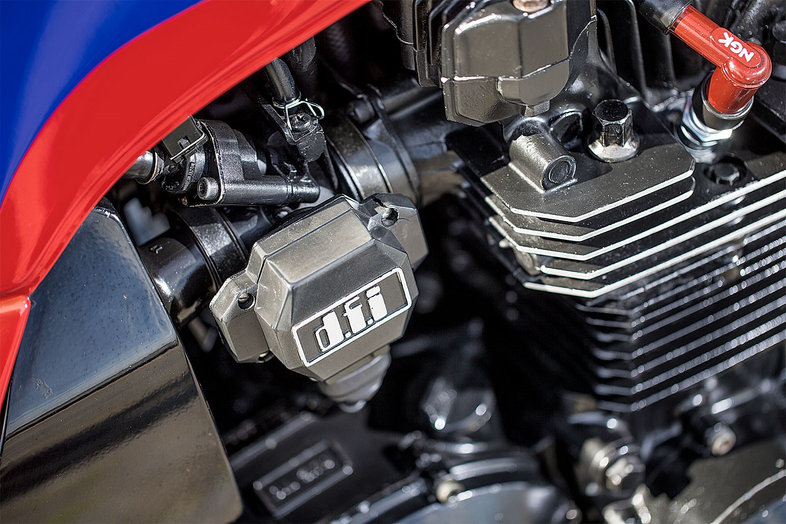

Kawasaki's fuel injection was called DFI but is a computer controlled throttle bodied injection, that is why I used that terminology as most on here understand those terms. I bought my magnetized stainless toothed wheel out of the UK for about $50.

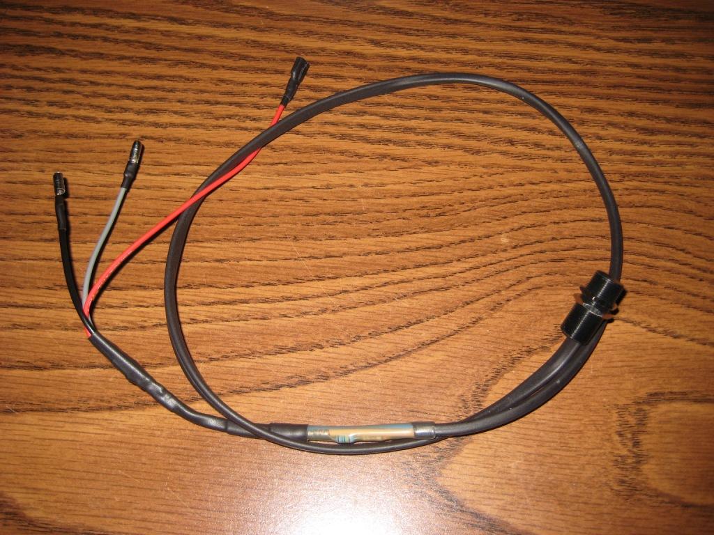

Cherry hall sensor with pull up resistor

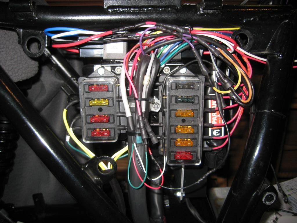

Microsquirt ECU wired and attached to bottom of battery box
GPZ1100 = DFI
GPZ1100 = DFI
