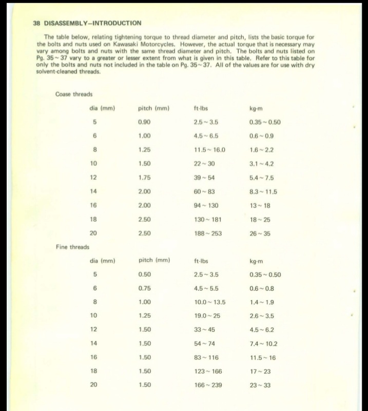

undefined How many nm should the nuts on the exhaust studs be tighten to?

Those nuts are crushing a hollow copper donut, so the tightening torque is not the same as a regular stud and nut arrangement. I'd tighten them enough to crush the donut and affect a good seal, and then maybe a smidgen more, and stop.

I have to measure, but think they are 6mm.
